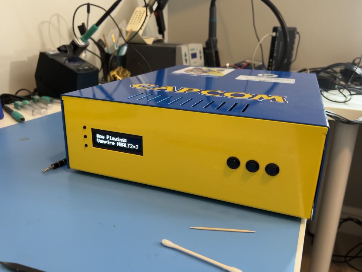

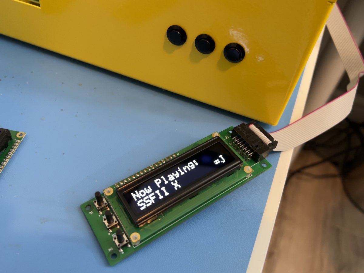

In case anyone is curious and wants to do the same, I purchased a Winstar OLED display that follows the HD44780 standard and it works! It's even more crisp in-person.
Here is the link to the AliExpress listing for it.
Note that the contrast POT is now disconnected as this display doesn't have adjustable contrast.
The pictures are a bit blurry due to the shutter speed. Don't let that sway you. :D
