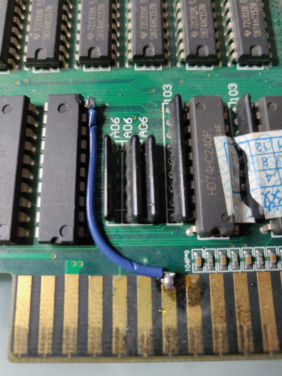

OK I solved the video issue on my arcade monitors, it turns out they left video ground (pin 14) unconnected on this PCB.
By running a wire from ground to the JAMMA edge this allows the game to function properly in my case.

Your PCB likely won't sync or work because most cabinets (rightfully) do not tie video ground to ground. Despite this PCB being a later revision, the problem is simply because video ground is floating. Tape off the actual JAMMA edge except the inwards tip of it, and solder a wire to ground. Video will be restored.

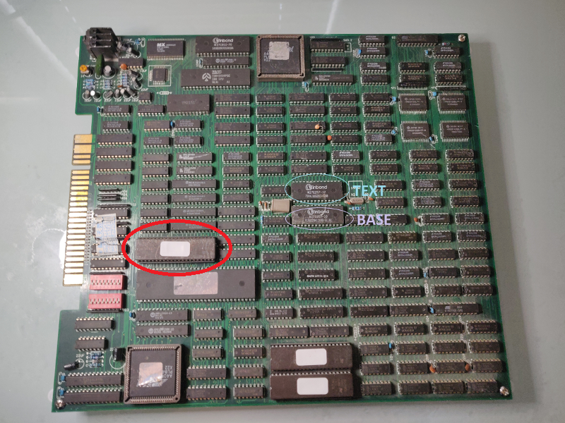

In case it is helpful for anyone, the orientation of the BASE and TEXT ROMs are as follows:

how bad was desoldering the text and base ROMs on this one?
I just got one of these PCBs in, thanks for info on fixing these issues! I wonder if there's a clean way to invert the audio pins without using an external adapter. I also noticed the volume knob functions backward and the sound is kinda bad, there's a substantial hum and the audio overall seems muffled.
Sure thing! You could do the same audio mod by following the two audio pins, cutting tracks and swapping them around on the PCB with jumper wires without using an adapter. The audio/hum might sound better once you swap the audio pins around.
Just to be on the safe side, I cut the legs on the text and base ROMs first but desoldering actually wasn't bad in my case - though I seem to have a later revision and better built board than some others have received.
I have the newer "Red Sun" style PCB like you do. I added some fresh solder to the Text ROM pins and they all desoldered beautifully. removal was quick and the chip basically fell out on it's own. I think the paper-thin traces really helped my desoldering iron get heat all the way through the hole.
Those WinBond chips are re-writeable and quite nice so I just dumped the original text data and then wrote back over it.
Unfortunately the Program ROM that @Hatsune Mike posted back in post #3 isn't working for me. it boots to a static screen of garbage when running that ROM. swapping back to the original bootleg program Rom works fine.
Just for my sanity I should be replacing the 27c800 right next to CPU with "sys" silkscreened under it, correct?
