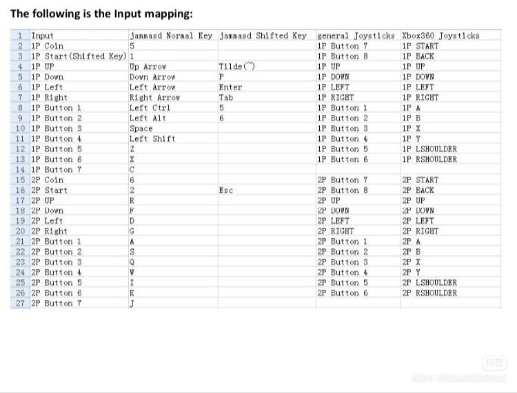

Hello, its USB key transmission speed is the highest USB speed of 1000HZ, and it supports keyboard mode (using key mapping), supports Dinput mode, Xinput mode, all modes support two-player games, and JVS can be directly transferred to USB, with built-in audio power amplifier, video signal gain device and adjustable video signal gain. Its key map is as follows:

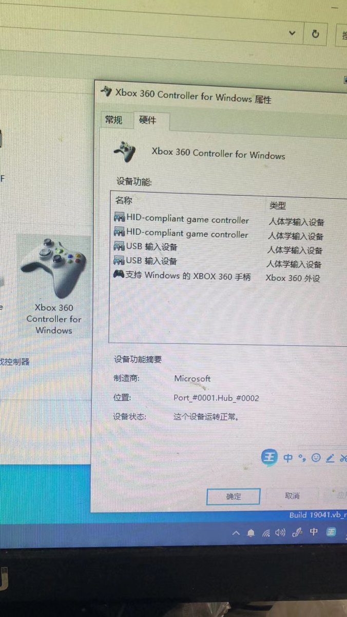

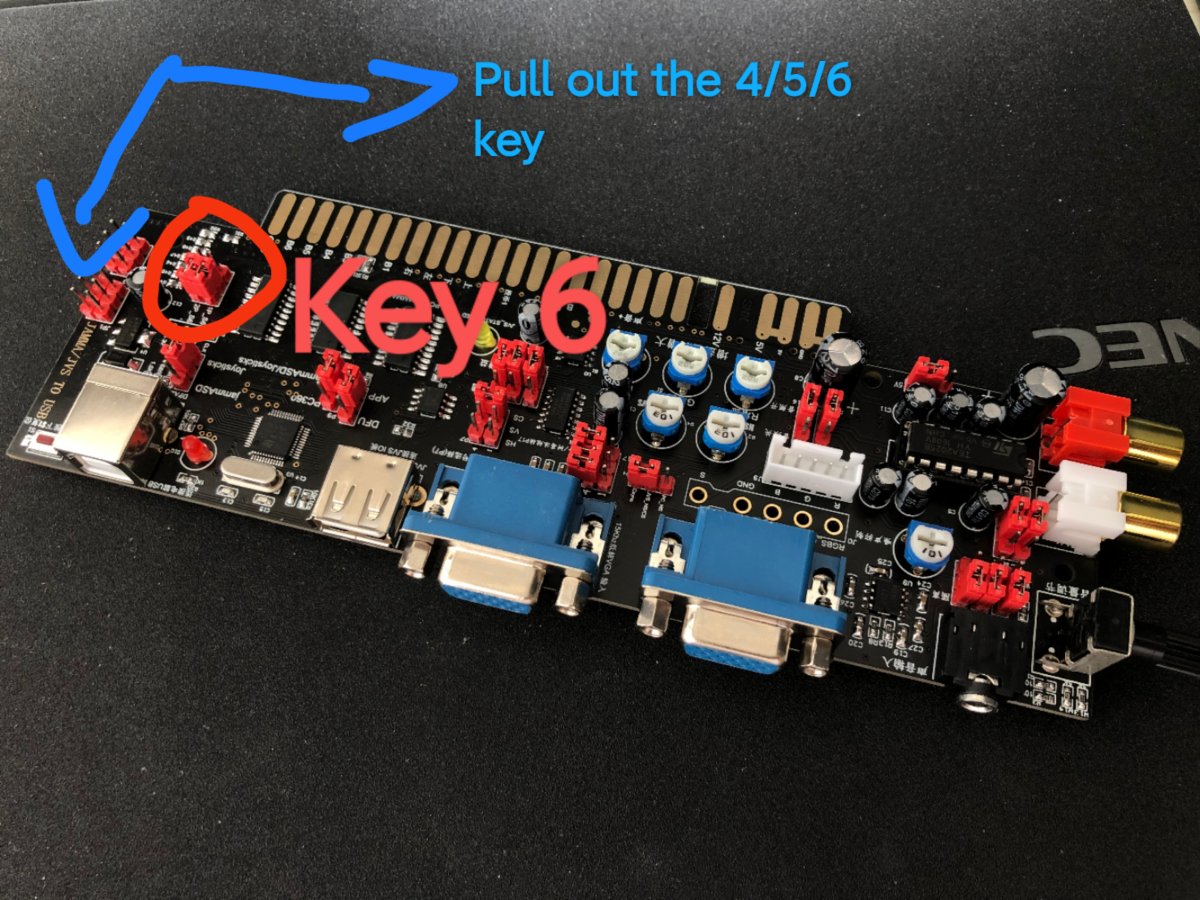

In fact, you can also use it to connect to MiSTer FPGA to access your JAMMA Arcade and JVS Arcade.To connect the mister FPGA, you need to use the Xinput mode of this board and Dpad as the direction key. These adjustable settings are set on the jumper cap on this board. I will help.
