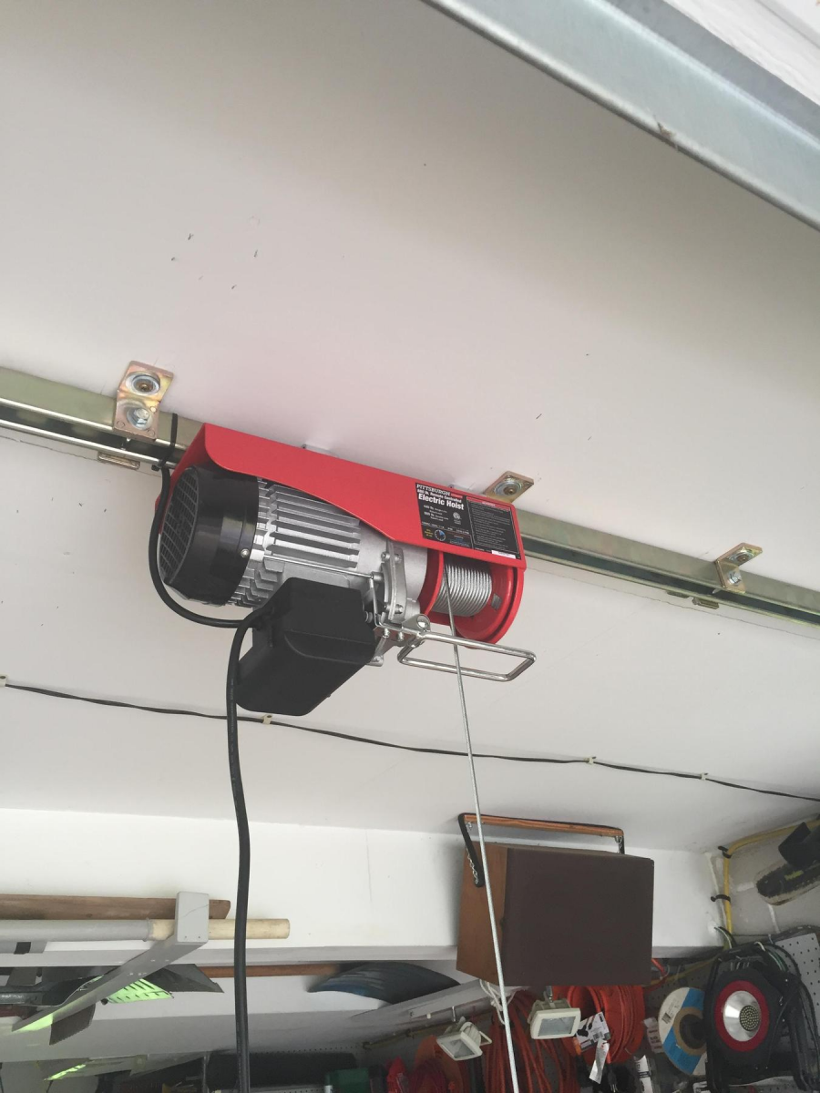

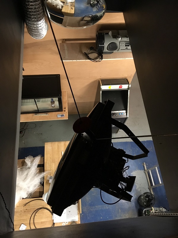

I use an electric hoist, it's in a position where I can lift monitors up to my mezzanine area for storage but I can use it to take monitors out of cabs and drop them onto a trolly.
I've got an electric hoist too. They're useful and cheap but you need somewhere stable and high to mount them too. That's a much bigger challenge / problem than it sounds. You're not going to be able to mount them on drywall. you'd need bars or a gantry higher than your cab and strong enough to support a 100-300lb crt plus 30-50lb for the hoist itself.

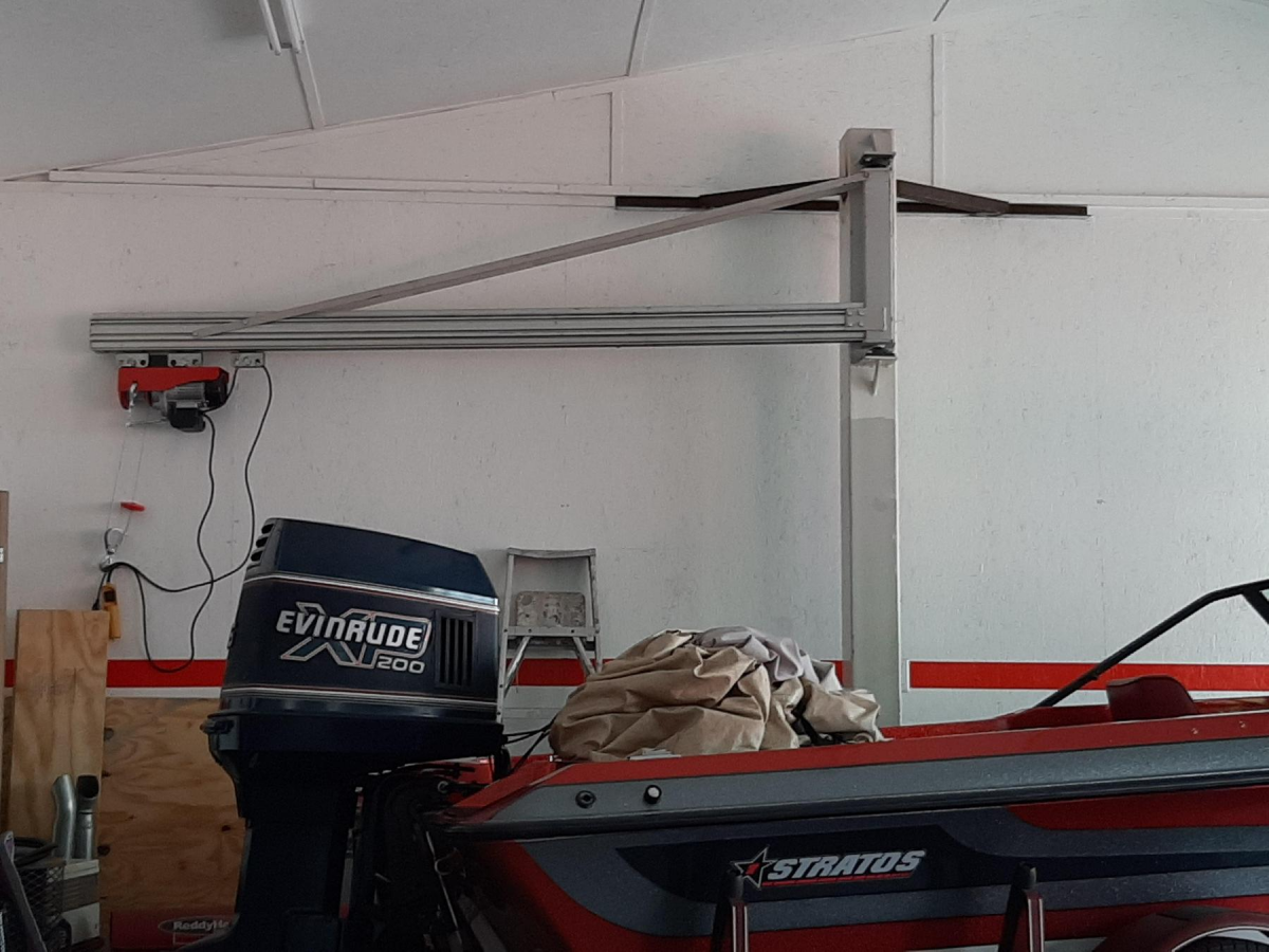

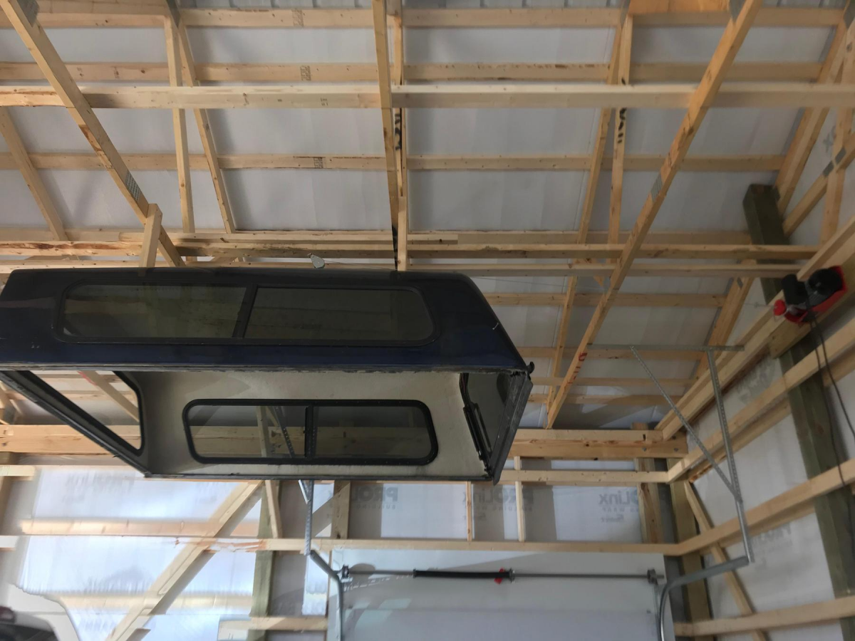

Electric hoist is the way, with plenty of mounting options.
I like the guy that did that rotating/sliding mount picture below.
Pretty cheap at harbor freight, this one can lift 880lbs more than enough I think.
https://www.harborfreight.com/880-lb-electric-hoist-with-remote-control-62854.html
The issue will be with clearance/balancing when you lift the monitor out. You don't want it bouncing around, so you will probably need someone operating the remote while someone stabilizes the monitor to not bang into anything.

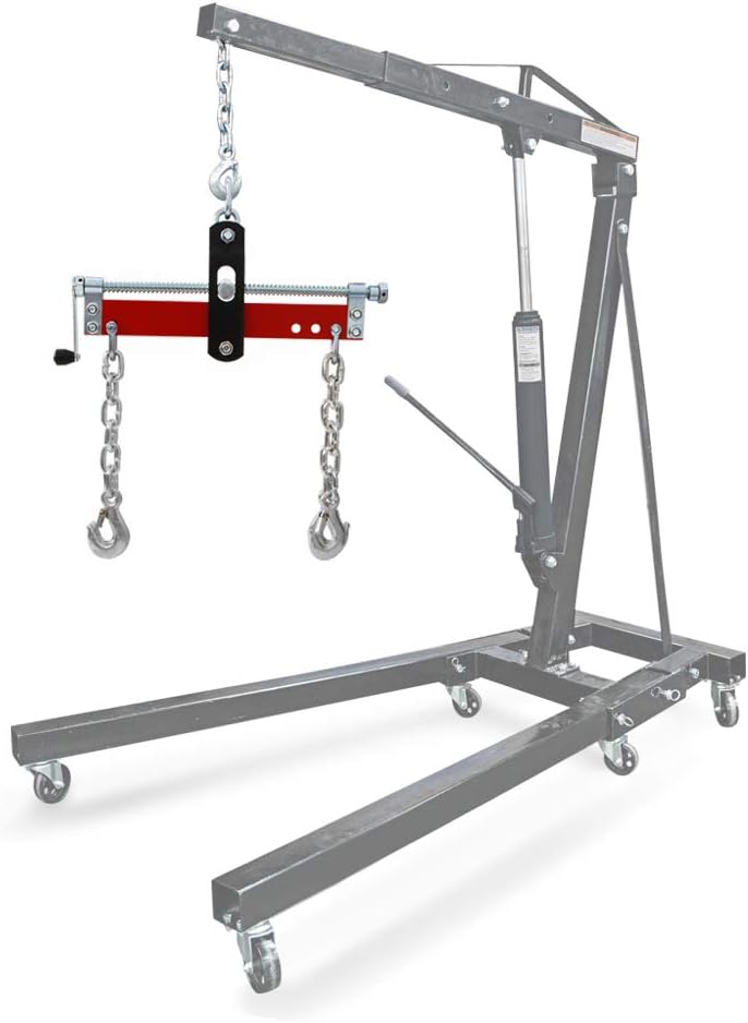

I was just looking at 1 ton cherry pickers to do the job. I still would like to find someone with handles. Maybe I can get something together with my local shop for actual handles.

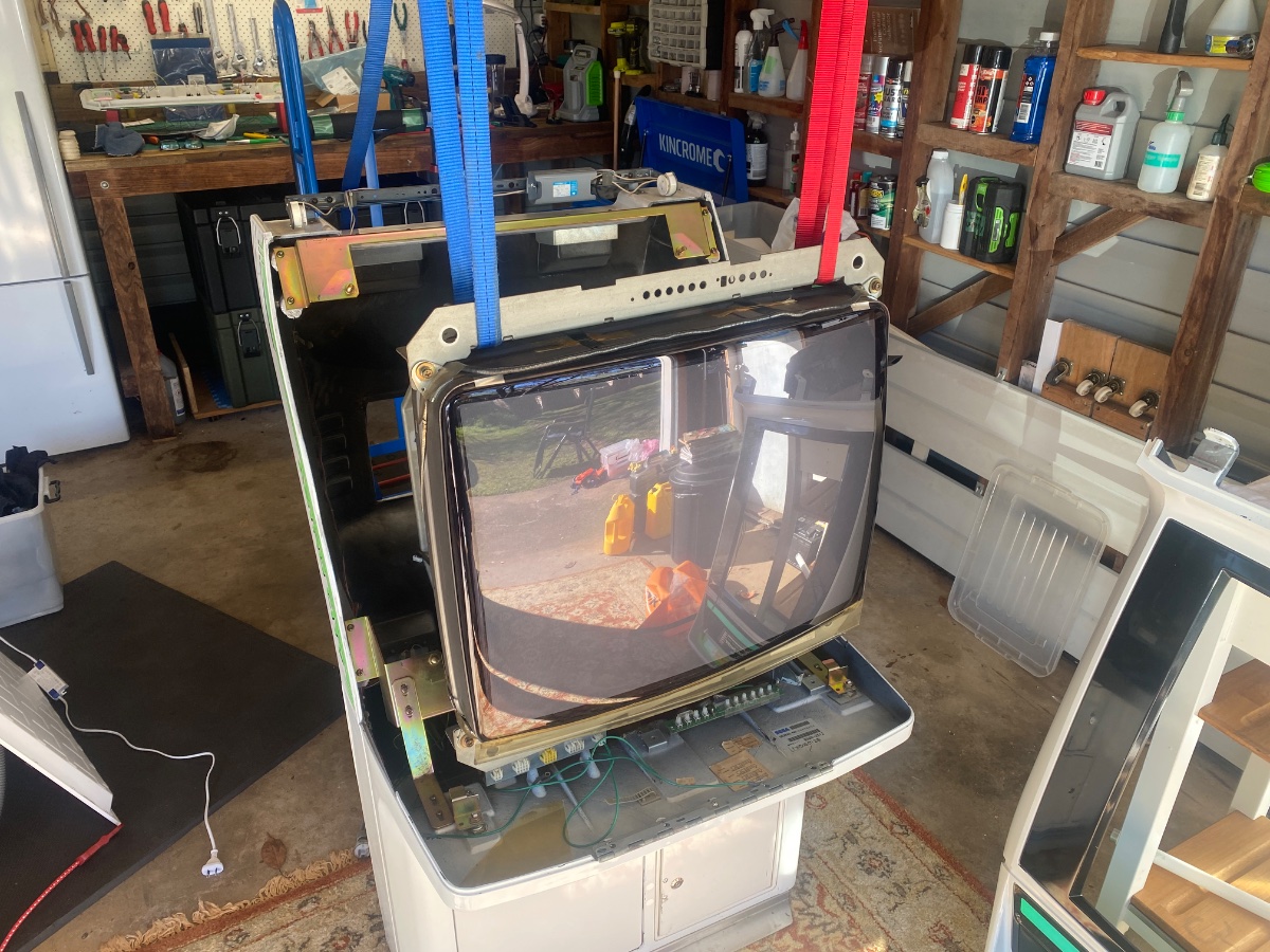

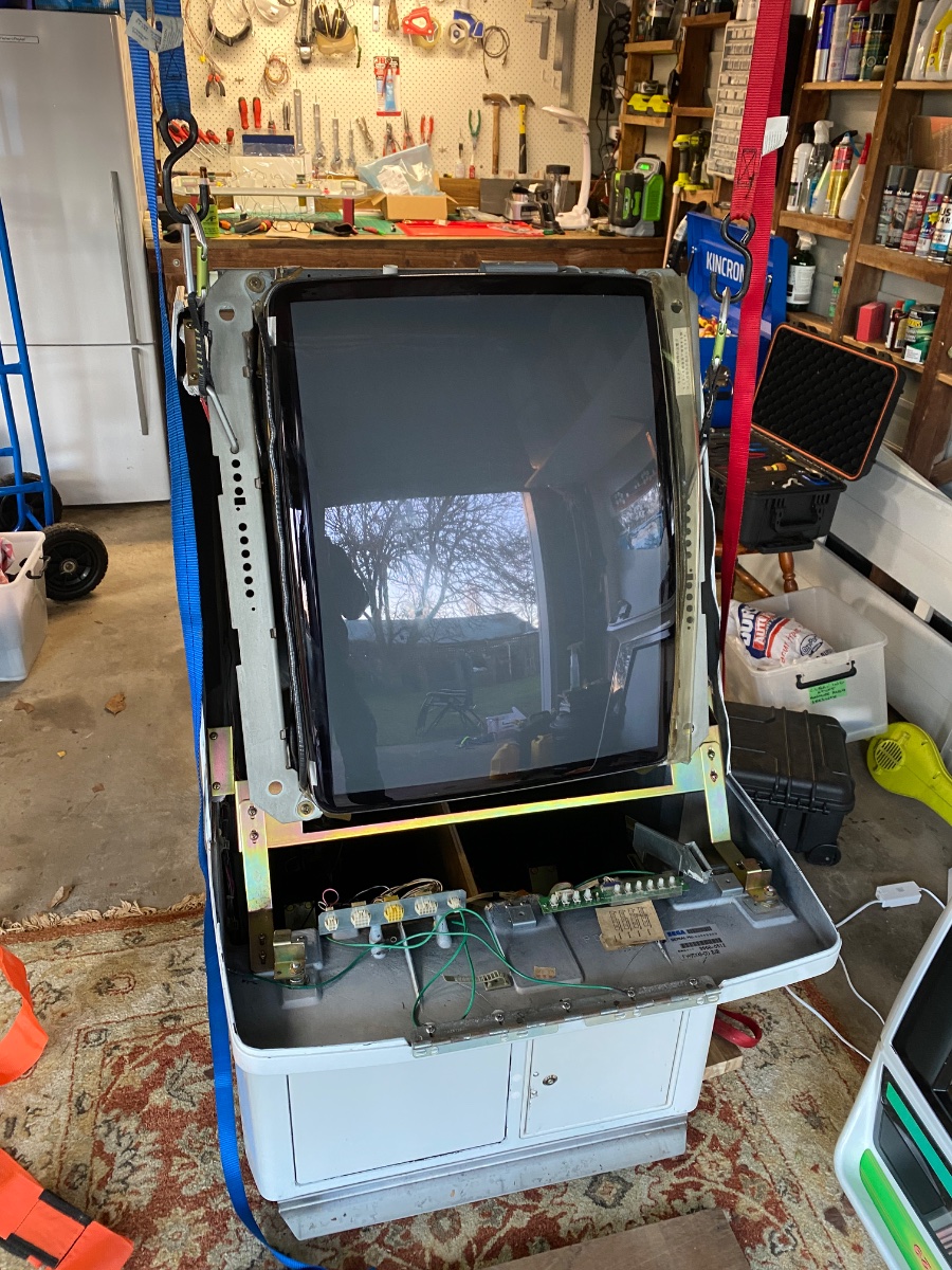

That’s what I do, put a Windy on its back and lifted out the monitor just a day ago. If doing on your own it’s the only way. I have done it with the following cabs, Neo29, Capcom Impress, Aero city and now a Windy.
The frameless monitors like the Impress need doing flat or you risk catching the neck and snapping it off.

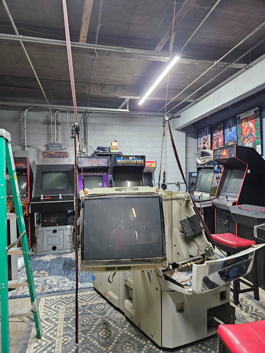

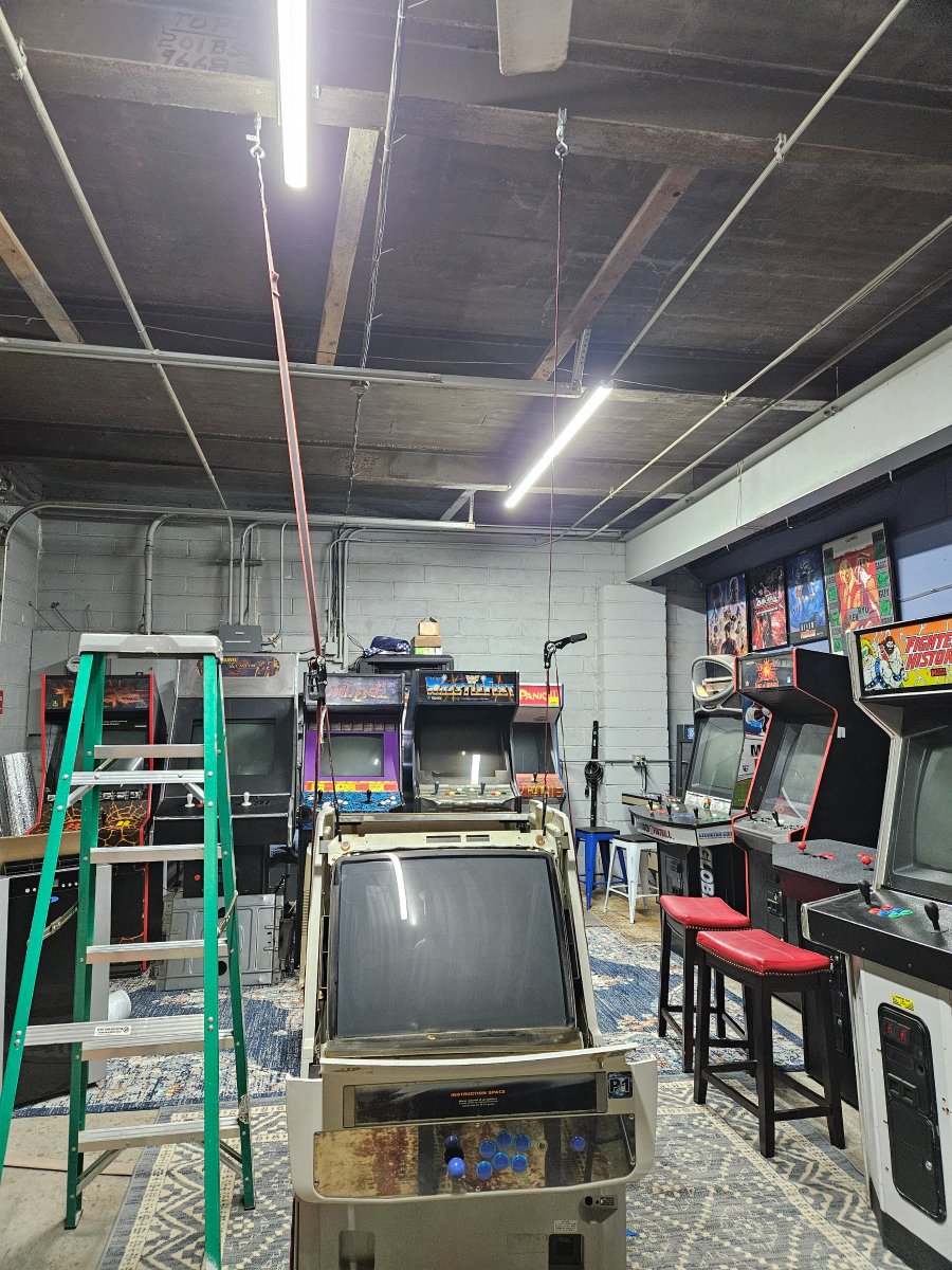

heres my story:
I own a hydroponic store that sells over 300 pallets of dirt a year.
Just helping customers can mean benching over a ton of weight per day if they're not flatbed customers.
I throw my back out once a year and am worthless for a week during recovery and then weak for another month.
I got hit by a car in 4th grade and have some real issues going on.
I can and have been lifting safely but I'm really looking forward to a process that I can depend on that does not having me bent over my cab lifting my monitors out.
I have nothing against people that don't mind doing it themselves but I abused my back over my lifetime so far and am looking forward to testing this thing.
I have Kenny coming in to design my chain array. We'll see how it goes

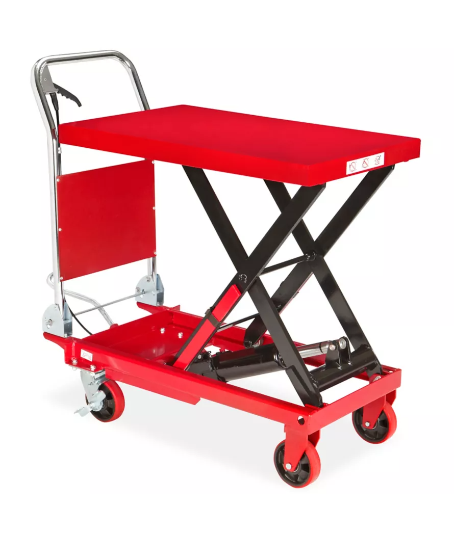

No. The engine hoist was unwieldy and very slow. I would buy a scissor lift over that and just slide the monitor off its mount directly onto the lift table.
I use a rolling tool chest I bought from Home Depot for $160 on sale. It takes most of the burden but I would love to own that table lift:
https://www.uline.com/Product/Detai...E6JmjsiiVmO4-3LH-VxZgnoN5k9_r4PBoCzxMQAvD_BwE

Ok cool. I was actually looking at some scissor lifts. Seem like they'd be best option for usability/maneuverability.
Also a good way to get tubes onto the ground and lower shelving for storage without having to lift from that low position. Could shimmy the tube onto a scissor lift and just crank it up to desired height.
