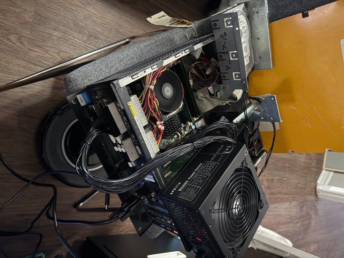

Só a bad super cap on the I/o is enough to stop it working ?had a broken videocard in a spare lindbergh so after receiving a spare, it's now working and I can confirm ( as if it was needed from that author! ) that the ebau108 is indeed working:

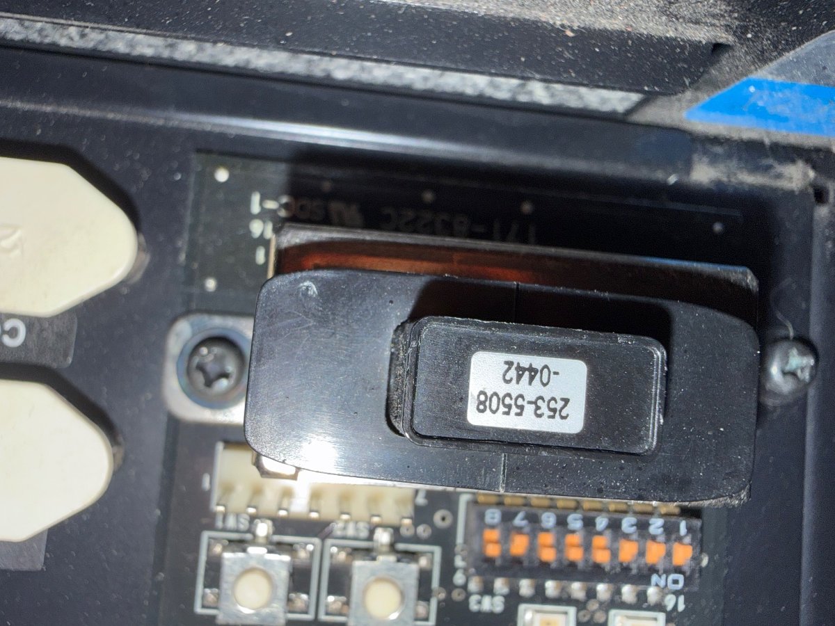

then I get a i/o not found !Swapped it from a working setup, goes all the way, game is working.
I have a i/o in my ali express cart and I see from the picture it doesn't have the "super cap" on ...so before pressing checkout, I go and remove the cap from my "broken i/o", stick it back and ... it's working ! take it for what it's worth! ( well 65$ actually!)
And just needs to be removed ?
