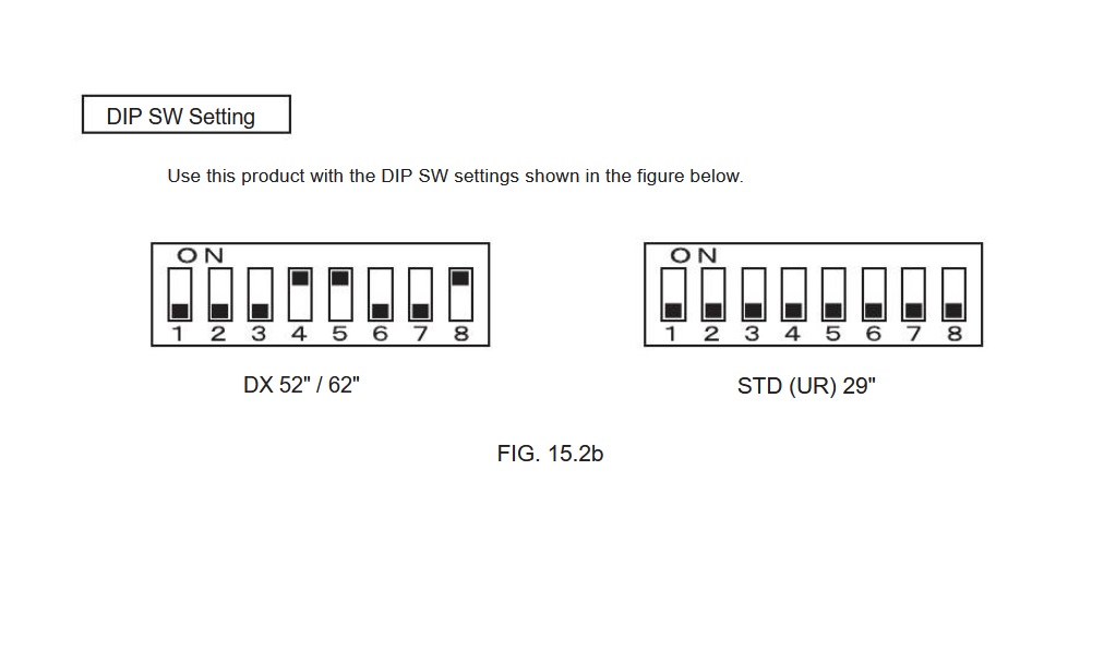

Your dips are all off for a 29inch right?

The dips are all off except number 8. When I first got it thats how it was. I have not touched the dips.

Someone told me to try and switch the audio and jvs board, also to remove the audio board completely and see if that would help. What position should the dip switches be?
