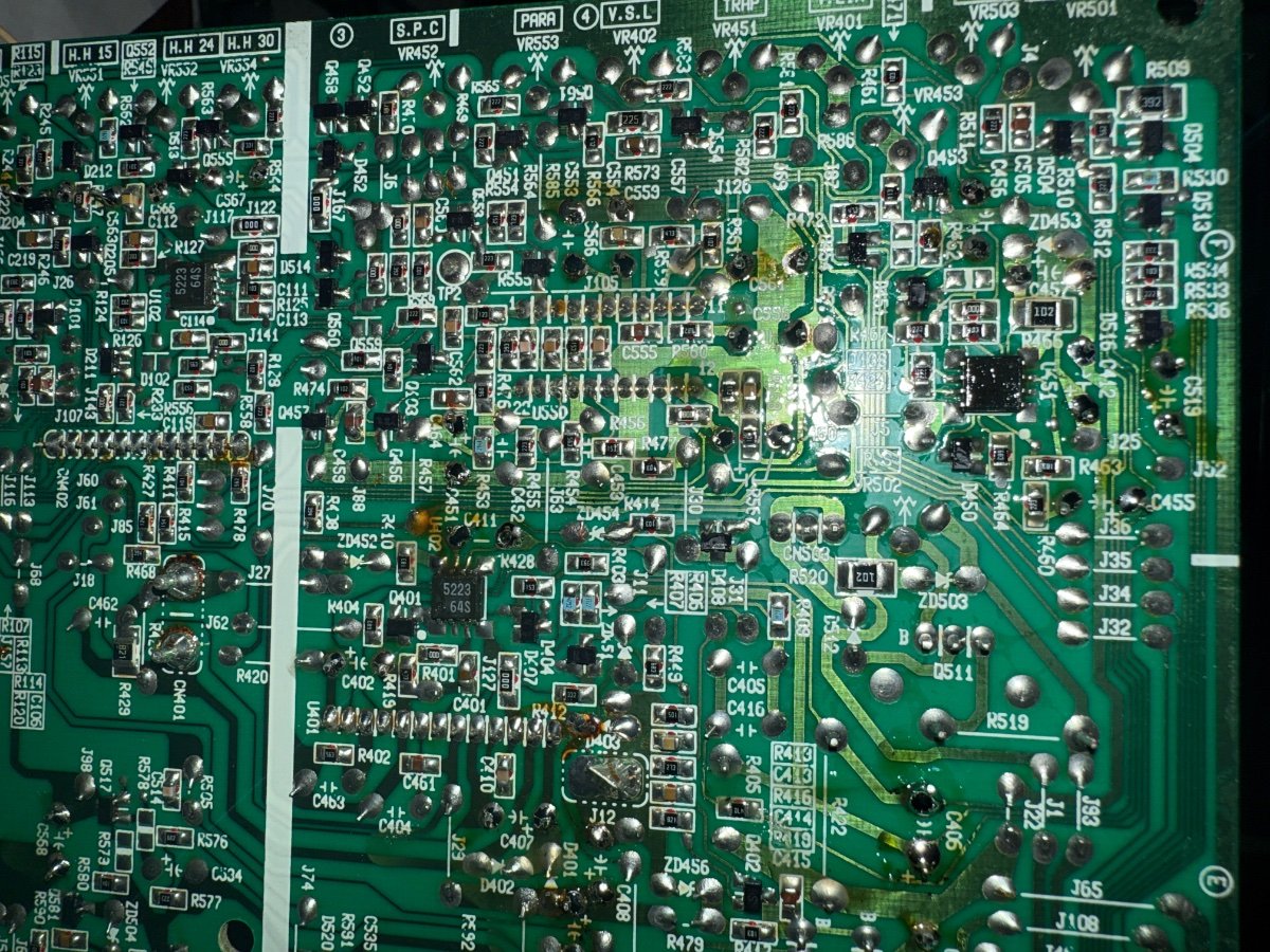

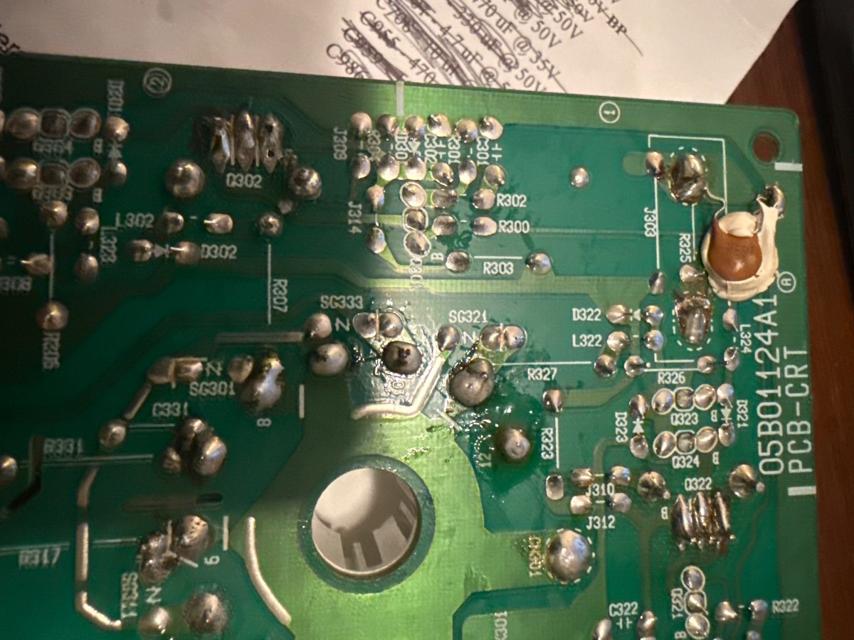

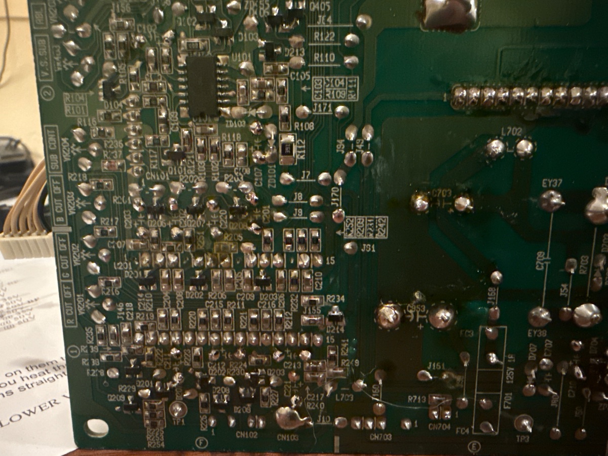

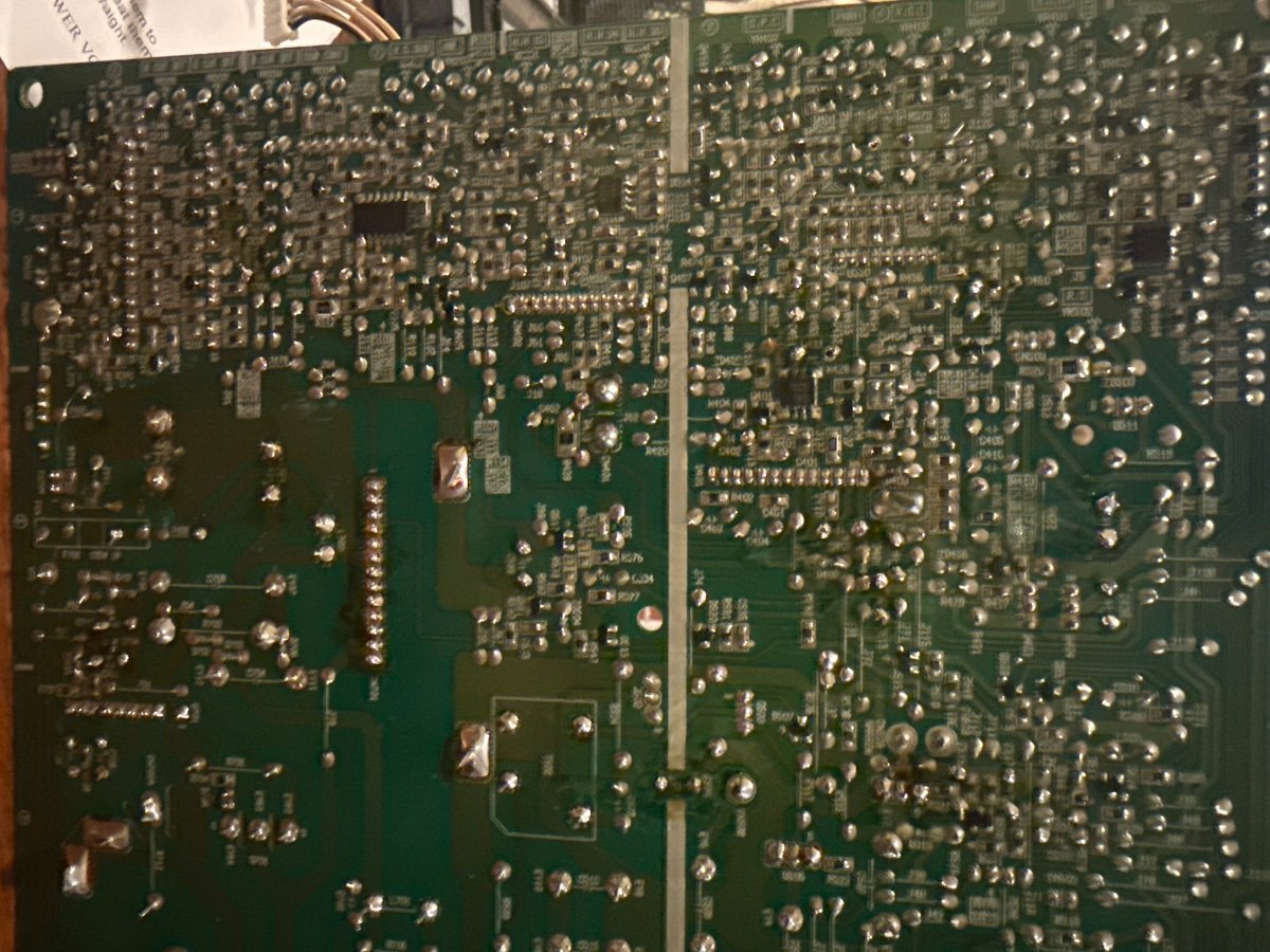

Lost red after recap. Any idea where to start. I still had everything about half way through when I checked. It must have happened when I replaced the last 24 caps on right side by potentiometers including daughter board.

Follow the red connection on the connector that leads to the neck board and follow it with a multimeter in continuity to see if it leads back to the rgb amp the big mitsubishi chip on the chassis. That's how I found the broken trace on my post, if it was working before the recap most likely you have a bad trace or pad for sure.
