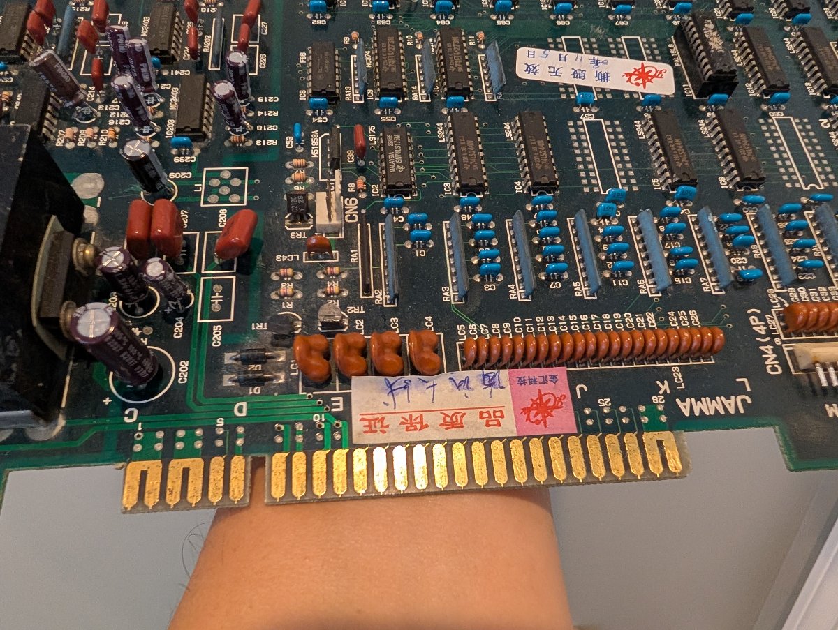

The diodes at D1 & D2 are protection diodes, right? They have uneven black stripes, but they didn't look obviously burnt to me.

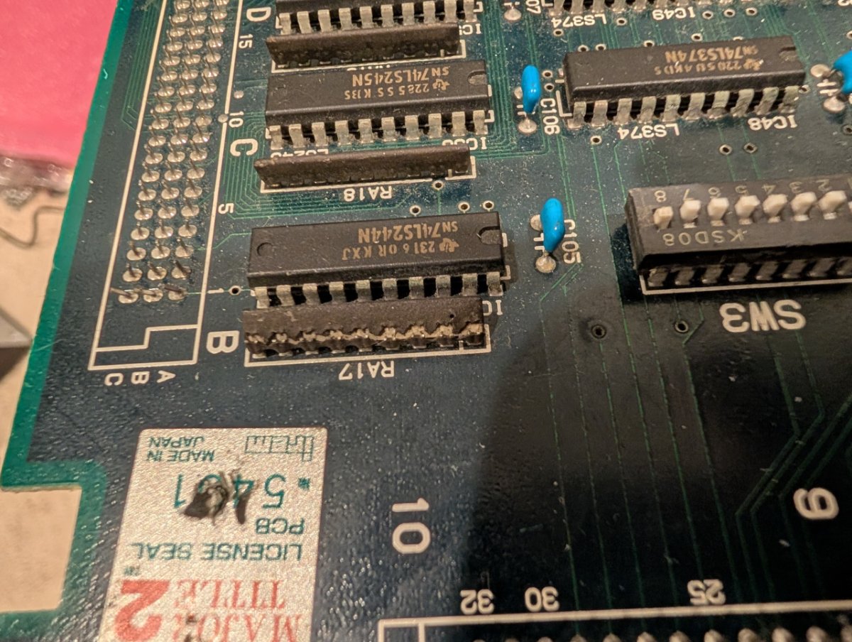

I straightened all the through-hole components I smushed when the board was upside-down for the case install, just in case a component leg was shorting. While I was at it, I noticed the resistor array at RA17 is broken. Anyone know what it governs?
that RA17 is definitely broken and needs to be replaced. probably worth solving that before troubleshooting further

Resistor array: It’s labeled 8-103JAHDK. I can’t find anything about the specs with a search, so I’ll measure the resistances tonight and try to find a matching part.

Thanks. The resistor array appears to be a 10 kOhm 8-resistor 9-pin bussed array, so I bought a Bourns 4609X-101-103LF.
I installed it yesterday, but must have done something wrong since I’m getting O.L between pin 1 & 2. Might be a bad solder joint on pin 1 because of the big ground plane. I’ll take another look today.

Took an extra day to complete the RA17 install since apparently SW3 switches 1 & 8 tie RA17 pins 2 & 9 (respectively) to ground. So, now RA17 is replaced and all pins are testing at 10 kOhm resistance to pin 1.

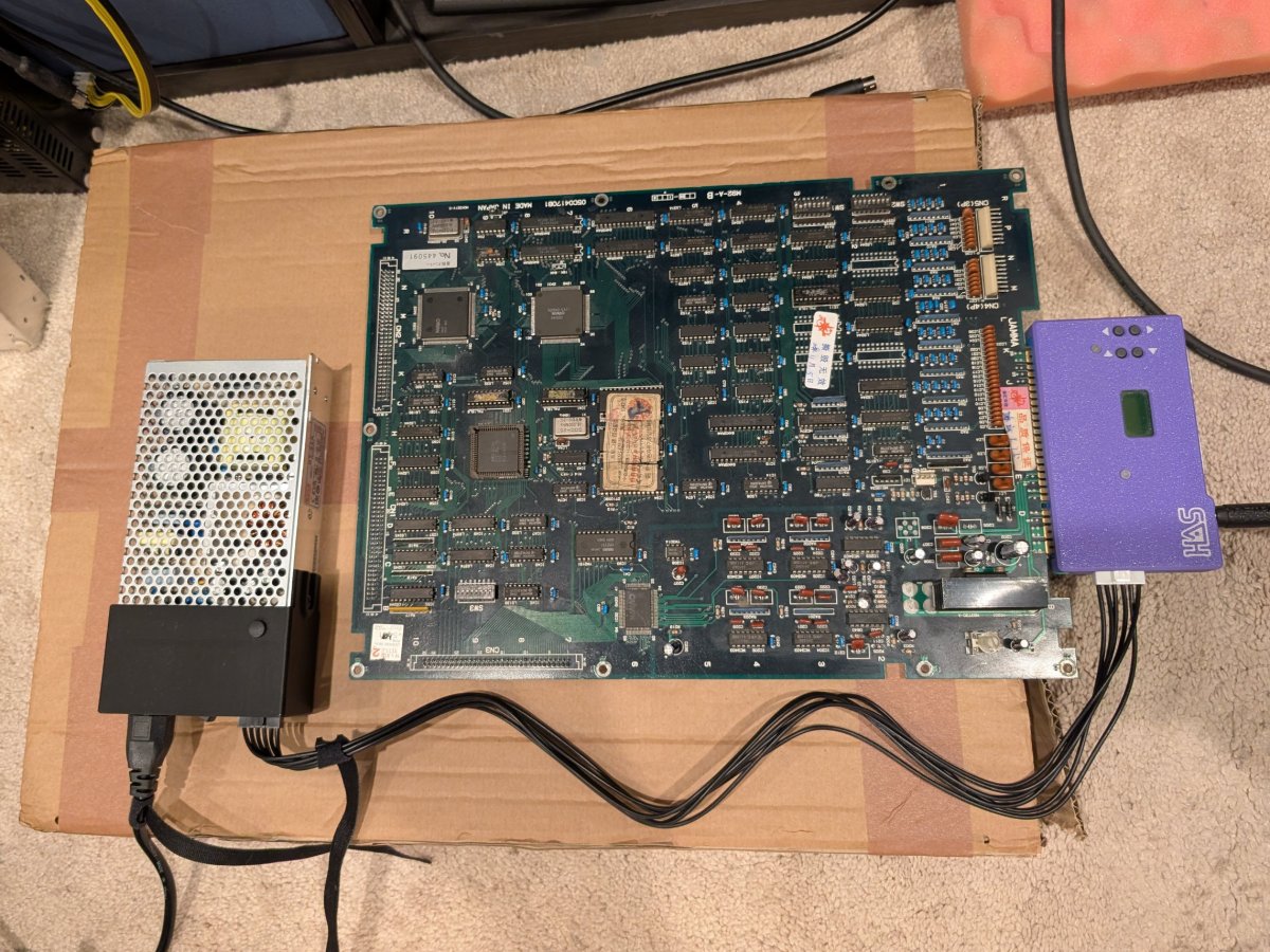

Can you take a pic of your setup when everything is plugged (PSU/Supergun/PCB)?
