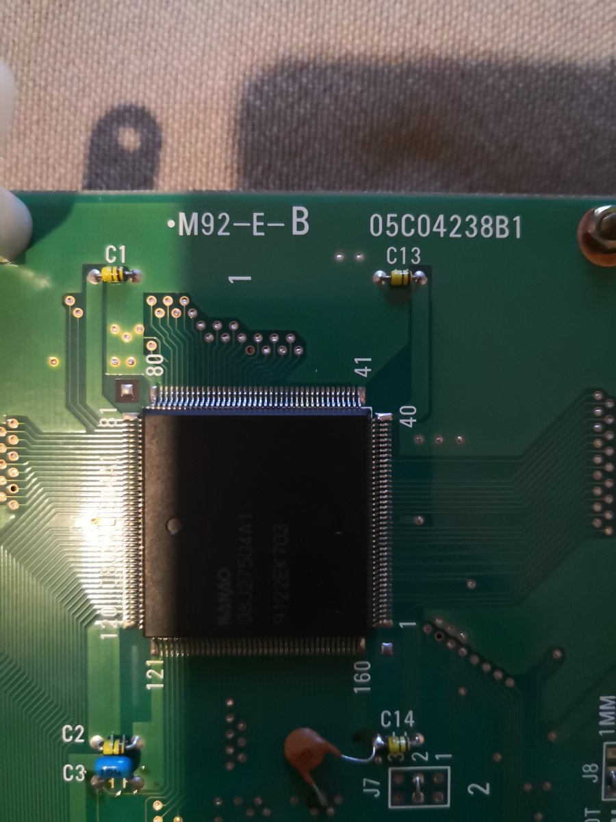

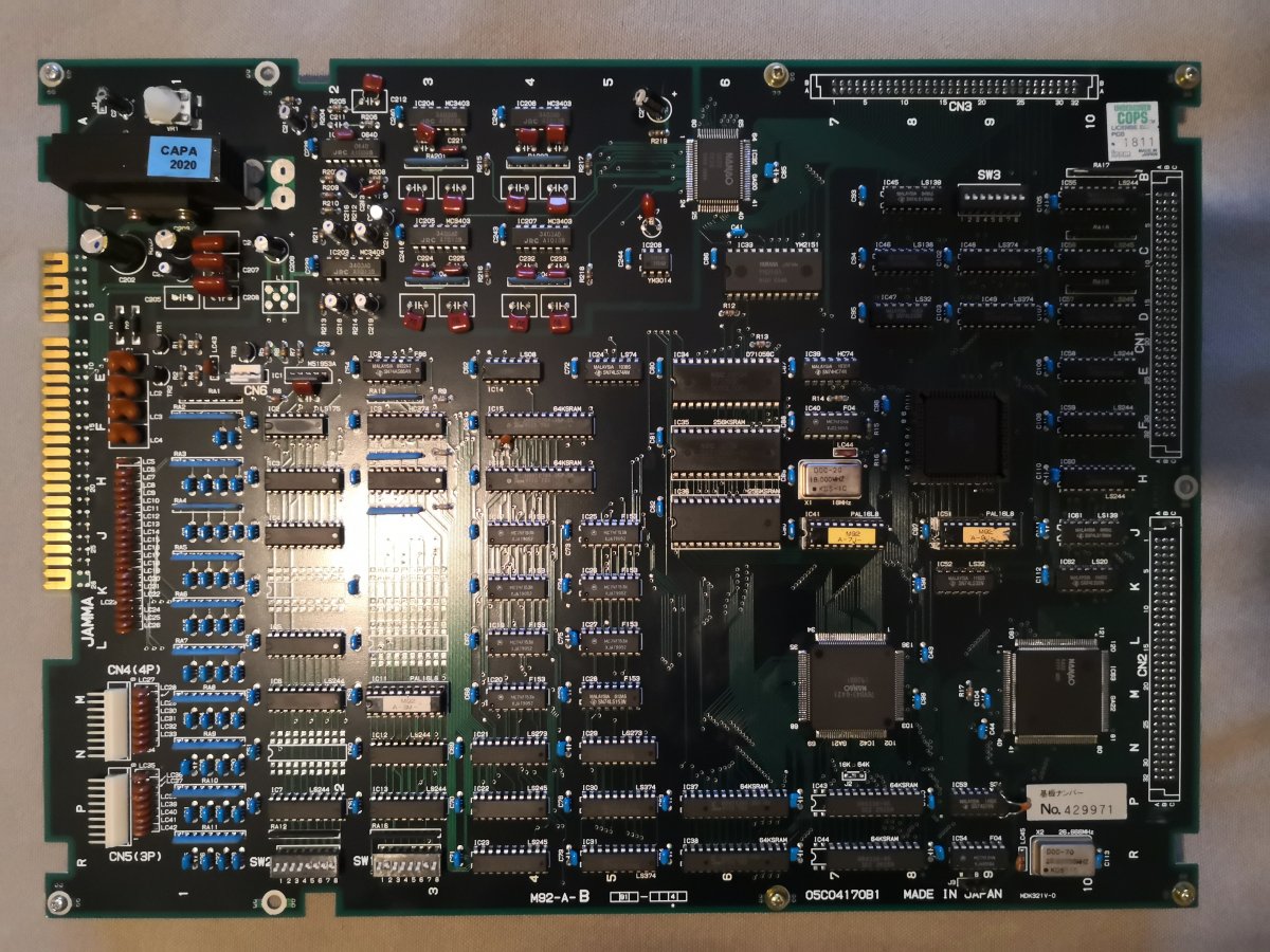

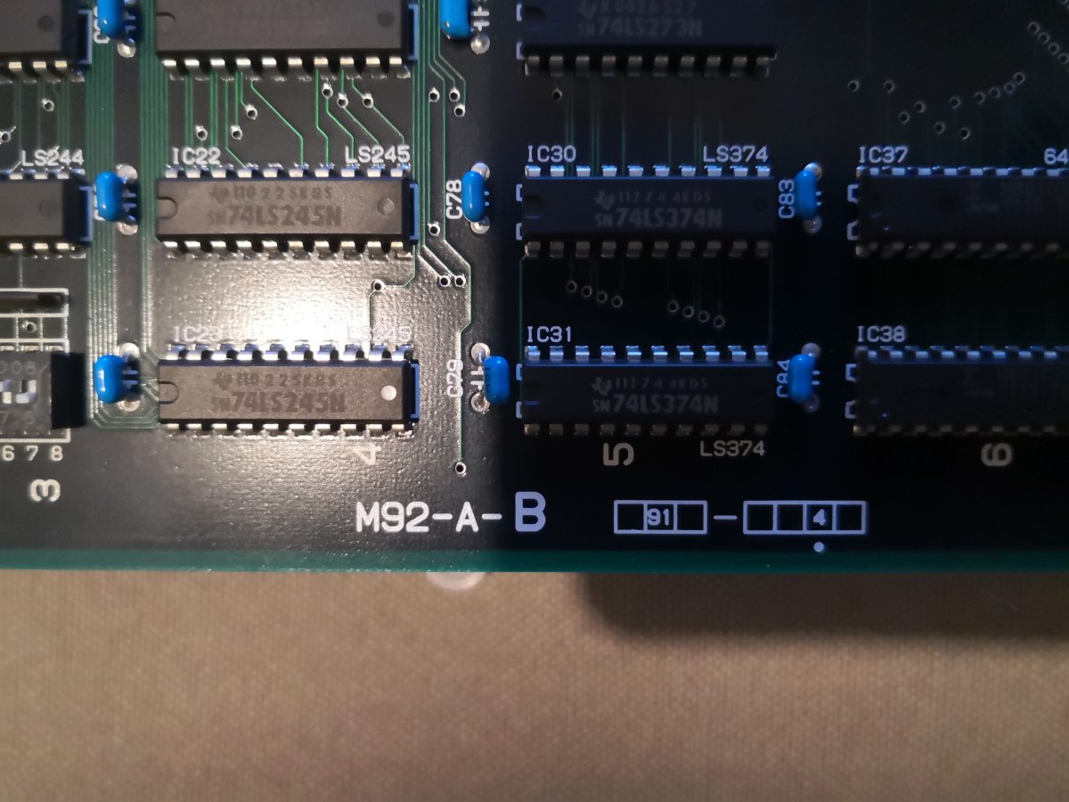

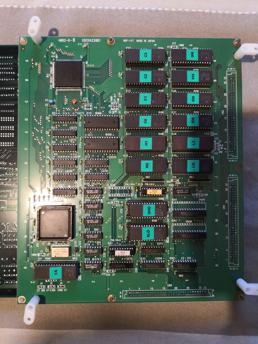

Sorry but do you confirm these board is compatible?
