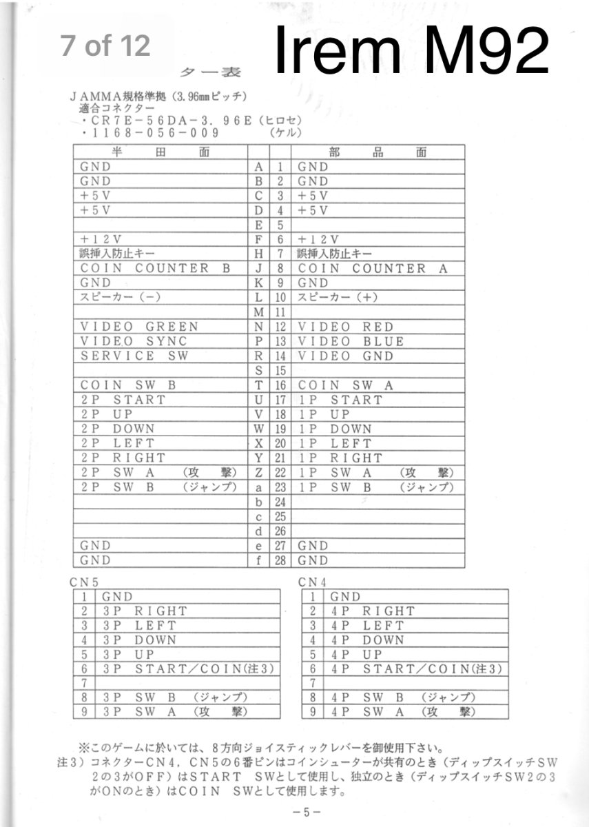

Thanks for that, I think that might be useful for a lot of multi owners.Best way to find pinouts is to look at the original manuals. Mame, as nice as it is, is not reliable for things like this since it’s made for people who don’t deal with real PCB’s.
Here’s a snip from one of the game manuals.

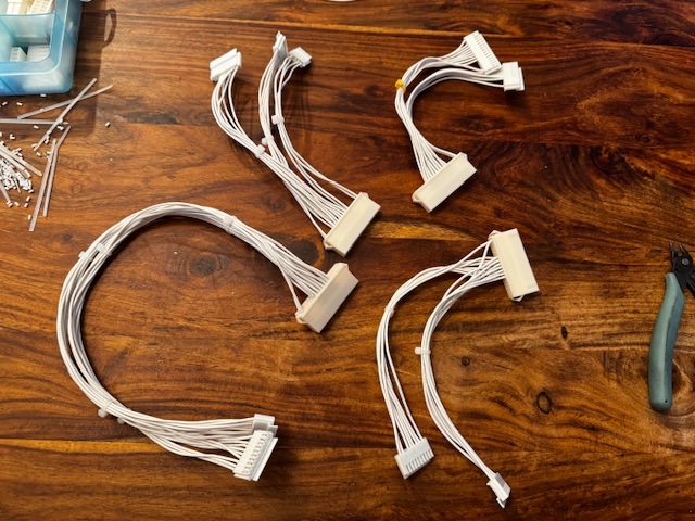

Yeah, 9-pin JST NH. I wired it to a CPS2 connector because my 3P/4P multiplayer harness going between the cabs uses the CPS2 kick connector for players 3 and 4.
