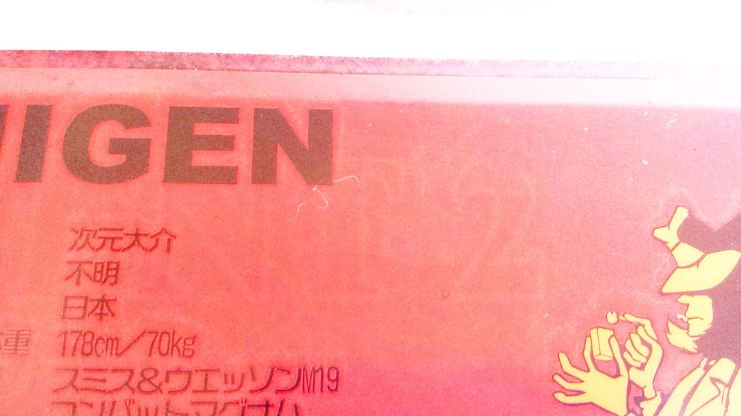

^that's typing of the dead art underneath... also on the control panel you can faintly see the "AGENT 2" text under the Lupin control panel art (contrast adjusted to make it easier to see):
Assuming I can get all of the Lupin artwork off of the machine without damaging the art below it seems the only thing I'm missing is the Typing of the dead cardboard pops.
