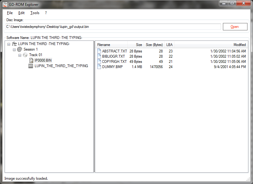

So I decided to take a look at Lupin the 3rd The Typing, it's a GD-ROM game so we can use GD-ROM explorer right? Maybe it would provide some insights into Typing of the Dead... Maybe we could translate that by just throwing all the words into a translator (I mean they're just single words they don't have to make sense inside the context of a phrase). wrong :(
converted the mame .chd to a BIN and TOC file that GD-ROM explorer could open
Code:
chdman extractcd -i gds-0021a.chd -o lupetype_gd.toc -ob lupetype_gd.bin
guess what... inside the GD-ROM is pretty much just one big 1.2GB BIN file || so yeah exactly in the same place we are with Typing of the Dead. :cursing:

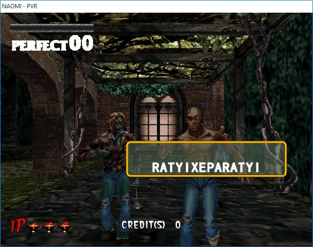

I'd be curious to see what happens if you just drop the US release WORD.AFS file in place on the JP disc image and see if it's playable in emulator.
I did this and it's actually playable. This looks good for a Naomi translation being viable.
First test trying to put the US WORD.AFS into the NAOMI bin...
Unlike using it on the JP DC release, it crashes when it tries to read the dictionary.
Okay so the Naomi binary definitely doesn't use an embedded AFS file structure for its dictionary. Instead, it has the BIN files from WORD.AFS extracted and inserted directly into the filesystem for the Naomi image. See offset F298C in the Naomi ROM for where the dictionary files are listed. E.g. S000L010.bin.
So basically, a tool would need to be written to extract the files from the Naomi ROM, as well as a tool to extract the BIN files from the US WORD.AFS, then you would replace the dictionary binaries, then a tool would need to be written to repack the Naomi ROM with the modified files.
Alternatively, it should be possible to manually edit the strings in the Naomi ROM by hand, but that would take ages and a lot of trial and error I'd imagine.
