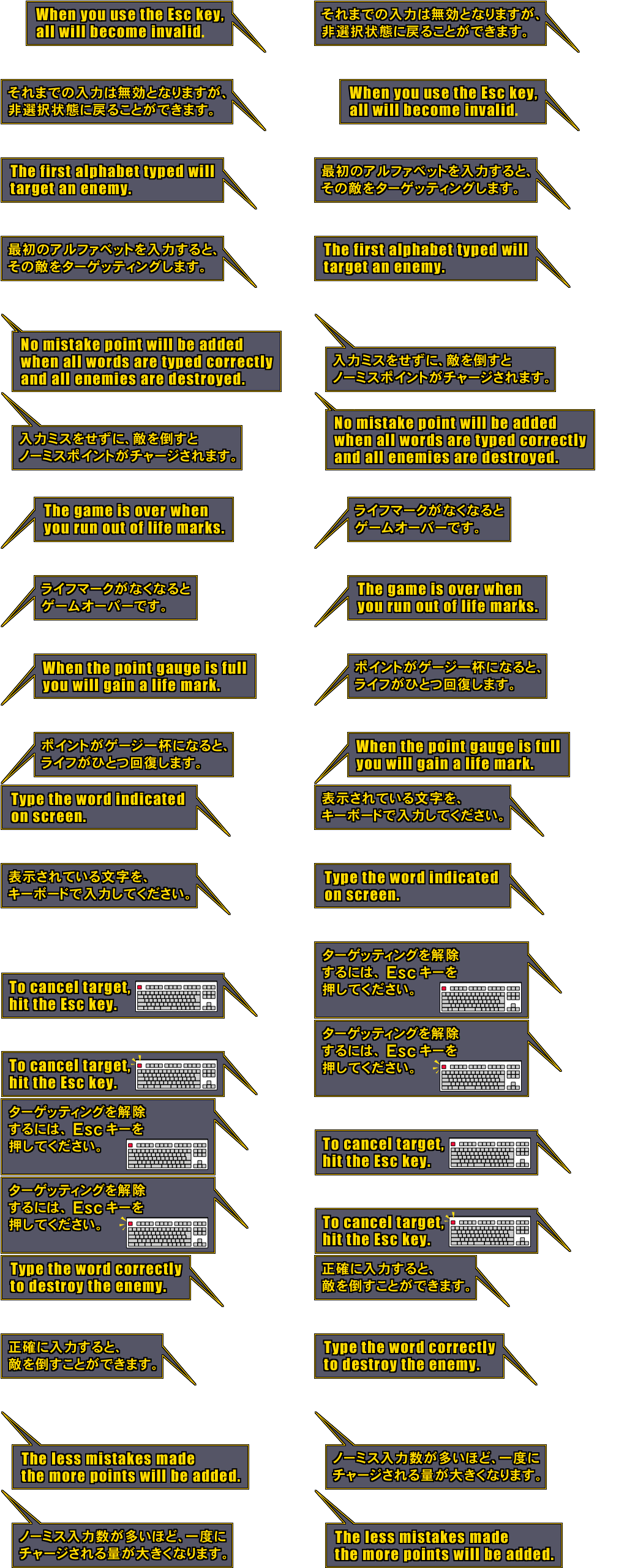

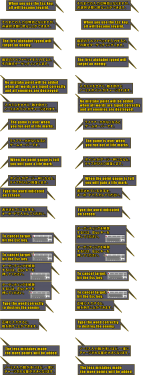

as I've noticed this game's data is like 10(sic!) ISO images located in game data ROMs.and ISOs in roms 1-5 and 9-12 contains mostly same file names (but 1st have ~50 more files), so I'd guess they are Japanese and English textures and/or data ?how do you switch eng/jap textures, did you find some byte-switch in game code or just replacing textures in game data ?First I wanted to point out that there is already some English in the naomi version alongside the Japanese, it just takes switching the images around within the texture to get the game to display it.
If I was able to debug the game properly I would have looked for where the game reads the image data from the texture files and redirected it to the English data but as I've said I couldn't get anything to work. So once I managed to decompress the files I just swapped the image data around in a hex editor (before I made the image program). Ive attached an example, original on the left, swapped around on the right.
The first 4 pictures in my first post are the only real examples of English that already existed in the NAOMI ver. Everything else has been taken from the PC ver. None of the texture files are the same between the versions, they have images for different parts of the game in them or are in a different order so I have had to open all of these files up and copy and paste the image data into the relevant files/locations, sometimes adjusting the image quality to get a better compressed file size.
The screenshots sammargh posted after switching the files are a good example of this. The files for the tutorial speech bubbles only contained English so were half the size which is why it displayed the wrong bubble first then just displayed garbage as it read beyond the file. Again for the chapter select screen, the file replacing the original had some extra stuff at the bottom of the image throwing everything off.
