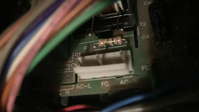

The description says it works for Makvision tri-mode 29" monitors, which mine is - and the AC power connector on the monitor's board has 3 pins labeled AC-L / FG / AC-N which seem to line up with the wiring of that suzohapp cable.
What do you guys think? Am I ok to hook this up directly to an AC outlet via that cable and completely bypass the cabinet wiring? Currently, there is a molex connector on the AC pins of the monitor, which is spliced into the "fuse cluster" I referred to in the original post. I could simply slip off the current molex connector and use the suzzohapp cable, which could plug directly into a surge protector. Just wanting to make sure it won't result in my becoming a pile of fried human meat.

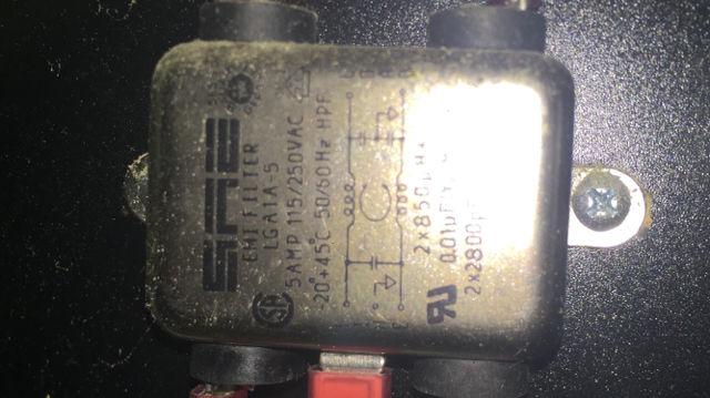

Here are some photos (Hopefully they're not too low-res - I had to reduce them). The bottom two are of the "cluster" I keep mentioning. Just to restate, this cabinet had alot of extra peripherals like ticket printers, counters, marquee, etc. I would not be too surprised if most of this was meant to protect that assortment of equipment or to ensure safety given the electrical requirements.
Also, might be too much info, but I've read that alot of gambling-related machines (this was a poker chip game called "Chip-a-way") would often have an isolation transformer built-in so that if they needed to swap in a monitor requiring isolation, they could minimize down-time.
That said, if you guys see any red flags here, let me know. Again, if it's safe, my plan is to run the monitor from a wall AC outlet with a surge protector.

I see no red flags. I say go for it.
