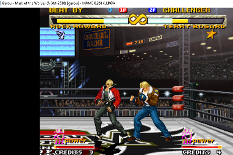

When I mess with data in the Region ':csolt1:maincpu.' in the '1d710' area I can get the win icons to disappear. If the wrong data is altered though it will trigger the watchdog. Not sure what's goin on in this area yet.
Edit:
Win icon data is in 0x1d7e0-0x1d840
Power bar S/P is in 0x1e260-0x1e2c0
The tiles can be edited changing data around in here. Trying to make sense of it.
If you've got decrypted graphics somewhere you're ahead of the game. I forget if you can let mame decrypt them and then dump them from there, I don't think I made that happen last time I ran into it though.
I am looking at a "P power" in my un-patched game. But I did use the exe you supplied to boot it.
In my game, in the fix data you pointed out ('Neo-Geo Sprites (optimized)/:spritesgen/0/m_videoram' starting at address 0x0e000), the value in memory for P/S started '2421' and was sometimes '3421' presumably 2/3 being palettes toggling. So the location is 421... somewhere. That would be the top left tile of the P. The next tile is 422.

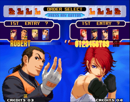

Guess KOF2000 is next to fix for the 161. Most tiles looks good with the neoragex patch posted in the main 161 thread. The character names on the select screen are the main problem, they take too much tile space. The original font for this will have to go to make it fit. The left facing assist character portraits for player 2 need to be redone. The mode select screen in AES mode too.
The Neo Geo splash screen has to be overwritten to make it all fit, so it's going be be corrupted. Might be able to call the fix layer in the bios to replace it during the splash screen, not sure if that's possible.
This one is going to take a while with the big roster.

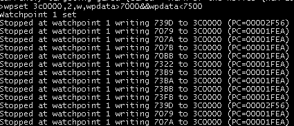

Can't remember exactly but it was probably a watchpoint on the VRAM registers. If you set up watchpoints on 3c0000 and 3c0002 you'll see a stream of commands that follow a pattern of setting a vram address and then sending data to it (https://wiki.neogeodev.org/index.php?title=VRAM)
Those watchpoints will hit and you'll see the PC that's doing the writing. For all the hits where the VRAM Address was in target, it was that PC doing the writes.
e.g. this will show you just the times SOMETHING is setting a vram address in the Fix area. Looks like 2F56 also hits there sometimes
wpset 3c0000,2,w,wpdata>7000&&wpdata<7500

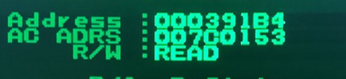

Patch doesn't work on the 161 in 1. Came up with the same error that Fgto79 had on his darksoft cart. Dagnabbit.
The address error at 7C0153?

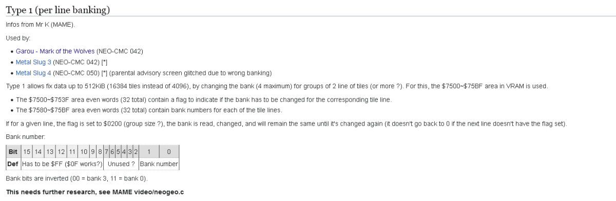

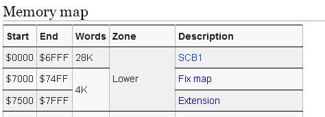

It's weird that I don't really see 7C0XXX as part of this: https://wiki.neogeodev.org/index.php?title=Fix_bankswitching which is the link that shows the region as "extension"
Anyway, you can set a breakpoint at 391B4 to see what it does, or a watchpoint at 7C0153, or an address register point on it. Maybe even though you've adjusted all the graphics, something in the program code is still doing some shit in the extension region. Even just trying to checksum it, or something.
The 68k ram 200000-2fffff wasn't bank switching in mame, that's one of the reasons why it's crashing there. The program rom makes writes to 0x2FFFC0 that tell it what program bank to swap to. Mame was saying 'unmapped memory address' when it calls for these in the error log. I have no idea why but assume this is an instruction the SMA chip would handle or something. On the 161 it is bank switching, so there is a different error from mame's, which is odd. I compared samsh5pf bank switching and it uses 0x2FFFF0 writes to switch the bank. I replaced all calls of 0x2FFFC0 with the samsho5pf one of 2FFFF0. This got mame bank switching garou exactly like the 161 in 1 is doing because now I get the same error, and when checking memory viewer it shows the same bank the 161 is on.
