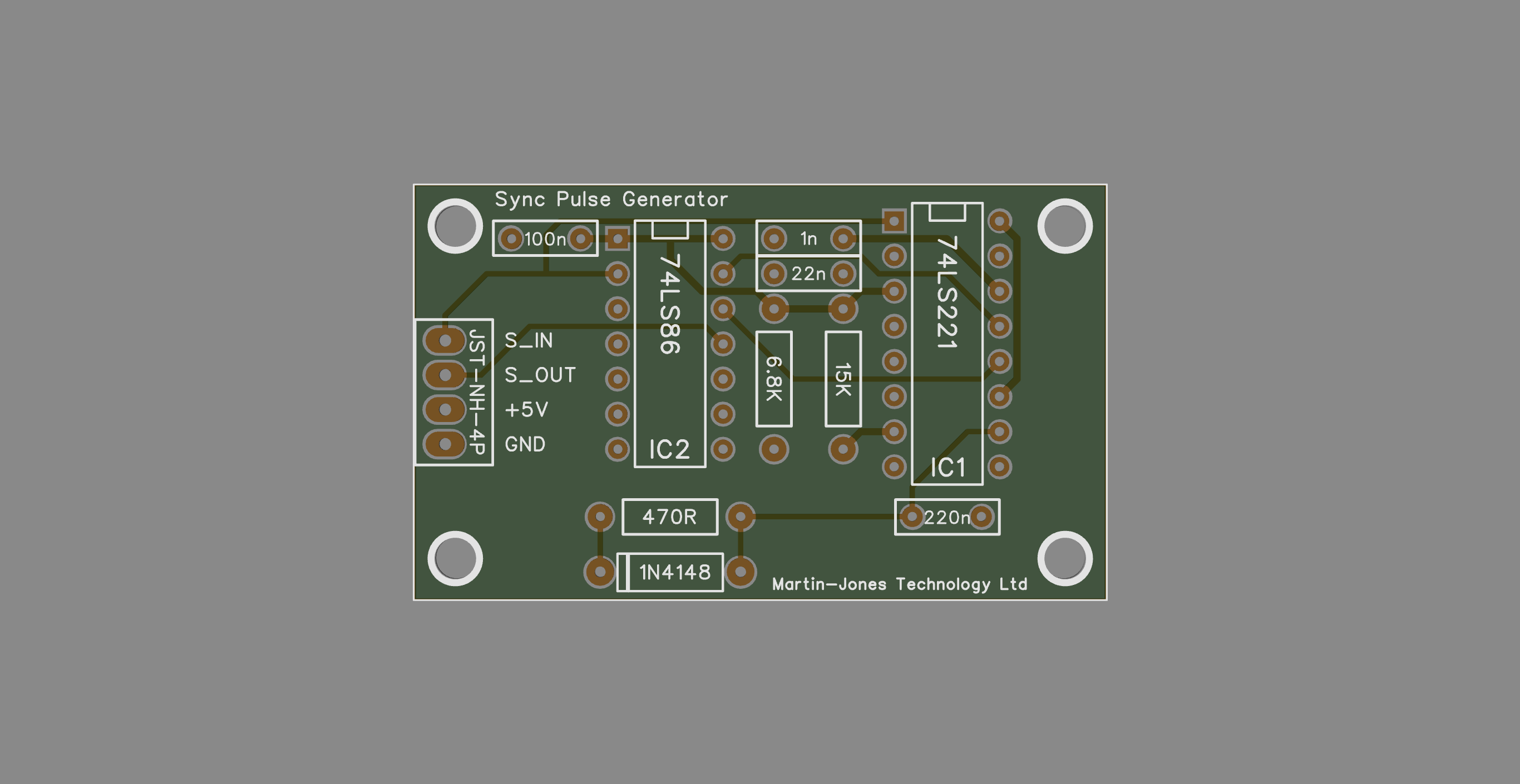

Do you guys think the tolerances on the caps (+/-5%) and resistors (+/-1%) I selected are the problem?
Increased through hole diameter for resistors and caps. Changed caps to suit poly caps. Fixed R1 silkscreen value. Beefed up copper pads.

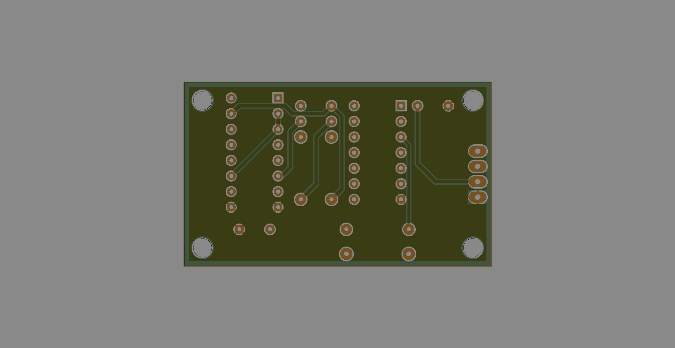

Does your design use a GROUND plane?From picture of produced PCBs and Gerber viewer I can't see GROUND traces on top and bottom layers and netiher a plane.Perhaps this is why it doesn't work.
I've given it a cursory look and can't find any inconsistencies between the schematic and PCB. I'll keep checking though...
I’ll have to review my schematic - the circuit I assembled worked without any issues.
Yeah, looking at your work and the schematic has helped me piece together how to read a schematic. Looks fine in my laymen eyes.
Thanks for your help, btw. It must be the components I used.
Diode is orientated correctly, as are ICs.
