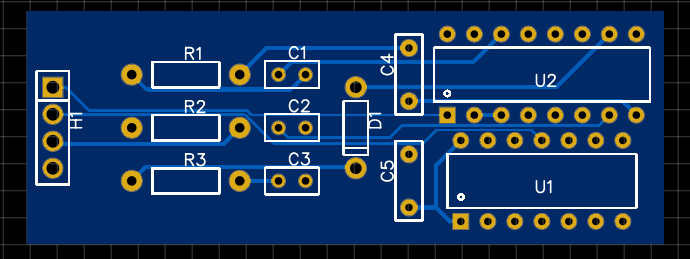

I may just whip it up in Easy EDA with a schematic. Then you can at least have a better look at it.
I still need to perform a more thorough check of the FreePCB design which I uploaded here, the one that you're using, and triple check to ensure that I didn't make any errors.

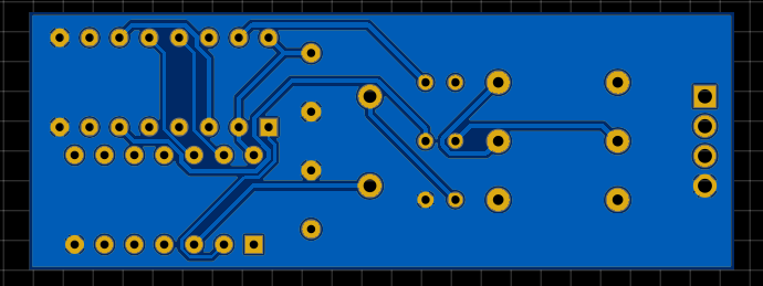

I've quickly whipped up a schematic and PCB in Easy EDA. It's a public project so you can view / modify / edit / order PCB's etc. Just type in SYNC as the search and look for a project named SYNC PULSE GENERATOR by Frank_fjs
I was in a rush so the schematic isn't neat but it should be accurate. Same deal re the PCB. Ill work on it more when time permits, but for now it's a good starting point.

@Frank_fjs I can generate a schematic from the PCB I made and posted, which @acblunden2 has used successfully, when I return home. From a comparison there, any problems might stand out.

Sorry I let you down @acblunden2, feel free to poke around the Easy EDA design I've made public. I'll continue to work on it as I'm determined to get it working.

I soldered resistors to the surface of one of the Osh Park PCB's I ordered. Those were the ones that had through holes that were too small to use. Tested it to see if maybe the JLC productions were the problem. No luck there either.
Will await Mike's PCBs and use the same components on those.
I must have made an error in my original PCB. Probably something simple but easy to overlook.
This latest PCB I generated from a schematic so fingers crossed it works as expected. I'm going to test it with F3 via scart and OSSC, want to see if it works.
