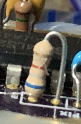

  1. Firstly, on the working SPG I have from 300wins via Hatsune Mike's original design (that works), it was built with a 6.8k resistor at R1, and not a 680k resistor. Perhaps Mike forgot that he caught MJ's correction since he worked on this so long ago. Based on this, indeed the correct value for this resistor is indeed 6.8k.
    • Here is pic of that resistor on the working SPG via 300wins<-Hatsune Mike
    • Blue/Gray/Red/Gold = 6.8k +/-5%

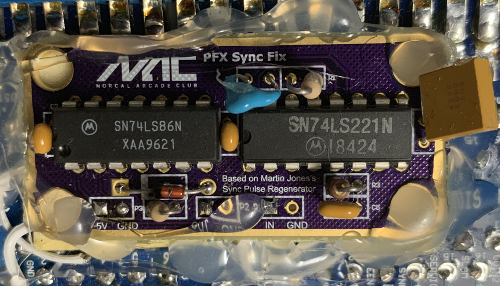

  2. That working SPG has 5 capacitors!

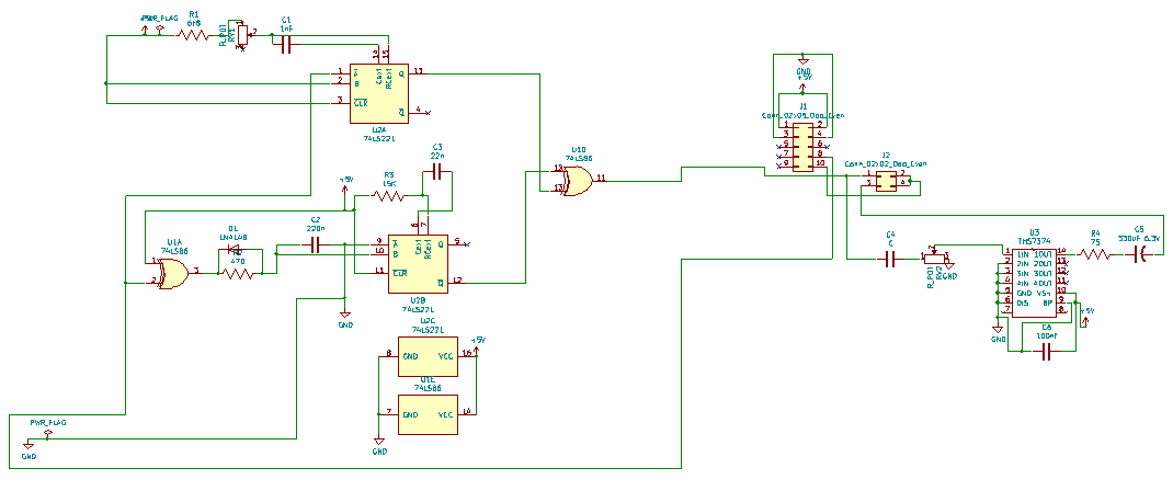

  5. On the schematic, I can only count 4 capacitors
    • C1, C2, C3 are in the schematic and a decoupling cap is recommended between power and ground
    • Where is C5? (And here is where they laymen in me may be confused)
    • Frank's original design only has 4 caps

Also, @Hatsune Mike, resistors and capacitors numbering on your PCB arent jiving with the component values based upon what I can read from the schematic. So I am installing components based upon the component values you have silkscreened on the PCB. Let me know if that is correct.
My original pcb was missing a power cap for one of the ICs, not a good thing but it wouldn't prevent it from working.
Wonder why it isn't in the schematic of the circuit? Or is implied that such a capacitor has to be in place when one of those IC's is used in any circuit?

Success at last!!!!!!!!!!!
Here is a fuzzy pic of it assembled:
Here is a pic of the harness I made for it so I can connect it in-line to the JAMMA harness I made for the NNC. I can remove it as needed if I need to.

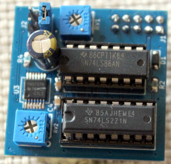

I've made some modifications to this circuit with success. Adding a 1K pot as a rheostat after the 6K8 resistor allows to fine tune the sync increasing the compatibility with some tvs.
I also added a THS7374 to buffer the sync signal with 75 ohm impedance, selectable by a jumper.
Each TTL chip should have a 100nf decoupling cap (not specified in the schematic)
