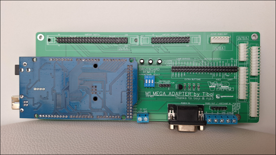

A new board is now available: the M1 MEGA Adapter, for Virtua Racing cabinets :)
The most observant will have noted the presence of the “Neo” mention next to the version number of the board.
This means that the pinout of the buttons and lights has changed compared to previous versions of the Mega Adapters.
Why change if it worked very well you ask me! Well, to go a step further in ease of handling in BackForceFeeder software. Now the pinout follows the njz3 mapping recommendations literally, which means that there is no longer any need to remember the physical button/Raw Input numbering correspondence, as well as the physical lamp/Raw Output.
If, in addition, you use the njz3 SSD image (all legally shareable files are on his Github), then you have almost nothing to do for the button/lamp mapping since everything is configured according to this pinout.
In terms of features, we still have most of those of its elders:
Sync converter, VideoAmp compatibility, Steering wheel/Accelerator/Brake signal stabilizer, MultiFFB compatibility, UART output for PWM cards...
On this M1 card we lose compatibility with the Delo shifter since it is not adaptable to Virtua Racing cabinets, whether Upright, Twin, or Deluxe.
The management of Extra Lamps and Extra Buttons has changed a bit, and expanded:
The routing of the ExtraLamp signal on "non-Neo" cards is standardized with all other signals: you can bypass everything (i.e. use another button/lamp than the one originally wired in the terminal) or use everything as Extra (i.e. use a button/lamp which is not originally wired in the cabinet).
Absolutely all Arduino inputs/outputs are now present in Bypass/Extra, including analog inputs.
Even the 7 lamp limitation of the ULN2003 is broken with the possibility of putting a second ULN to manage the 8th lamp that the Arduino can take into account.
I also added a "DC" zone to be able to power things from the USB for manipulation outside the cabinet (the "DC OUT" terminal block being powered by the cabinet and not by USB)
