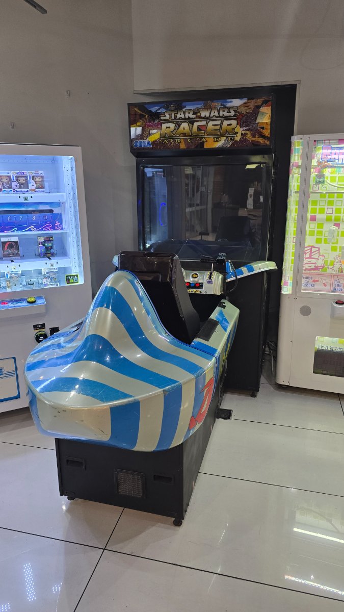

My baby 👶

Yes it works, I tried it. It's just a matter of button mapping.
Couldn't get the outputs (lamps) working properly yet though, even with BigPanik's DemulShooter Special Edition dedicated to this game. I'll give it a few more tries. Even if I don't succeed, it will be possible to make the lamps blink, but independantly from what happens in the game...
I didn't have time to dig more about the output issue.
Apart from that, all the hardware part is ready.
I DM you know if you prefer to have everything earlier with no outputs (like on my video) or to wait a bit more for potential (but not garanteed) improvements on output management.

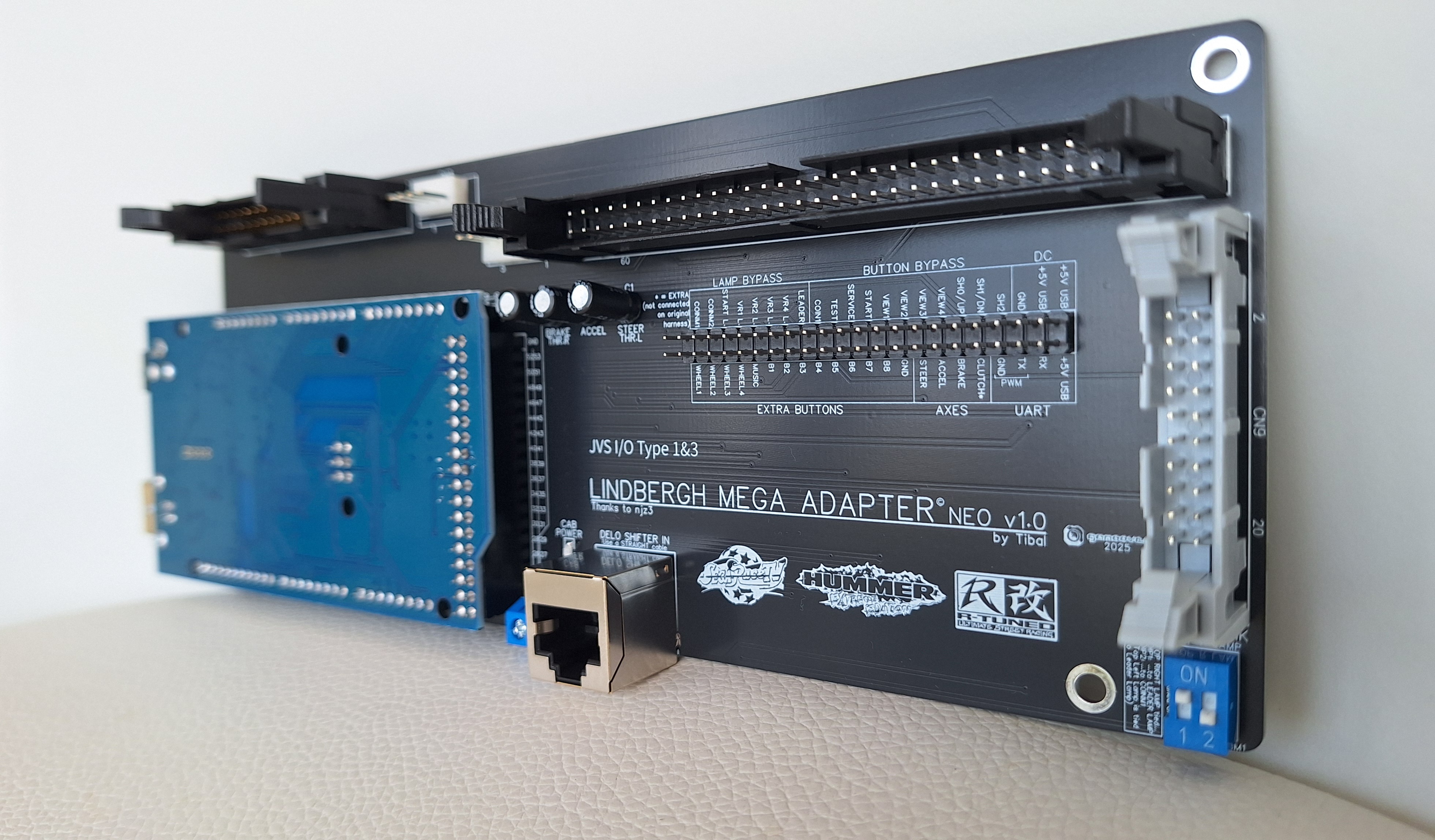

Here is an actual view of the Lindbergh Mega Adapter, design optimized for SEGA Race TV, Hummer and R-Tuned:

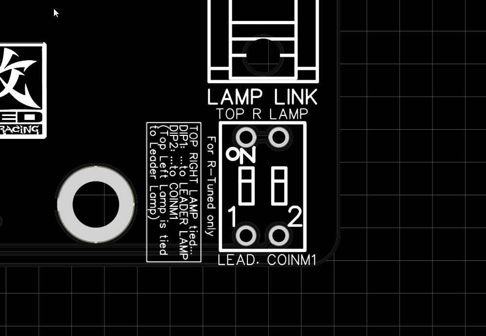

One specificity is a double dipswitch in the lower right corner, meant to be used in R-Tuned cabinets only, as these have 2 seperate lights per seat in their billboards. The switches allow to either:
- tie the 2 lights together to be used as a single "Leader" output, and hence have a behaviour similar to many other racers that have a Leader lamp in their billboards (most Model 1/2/3 machines and some others). Having these hard switches avoids specific software settings in BackForceFeeder.
- tie each billboard light to a separate output ("Leader" and "CoinM1" outputs) in order to drive them at personal taste
