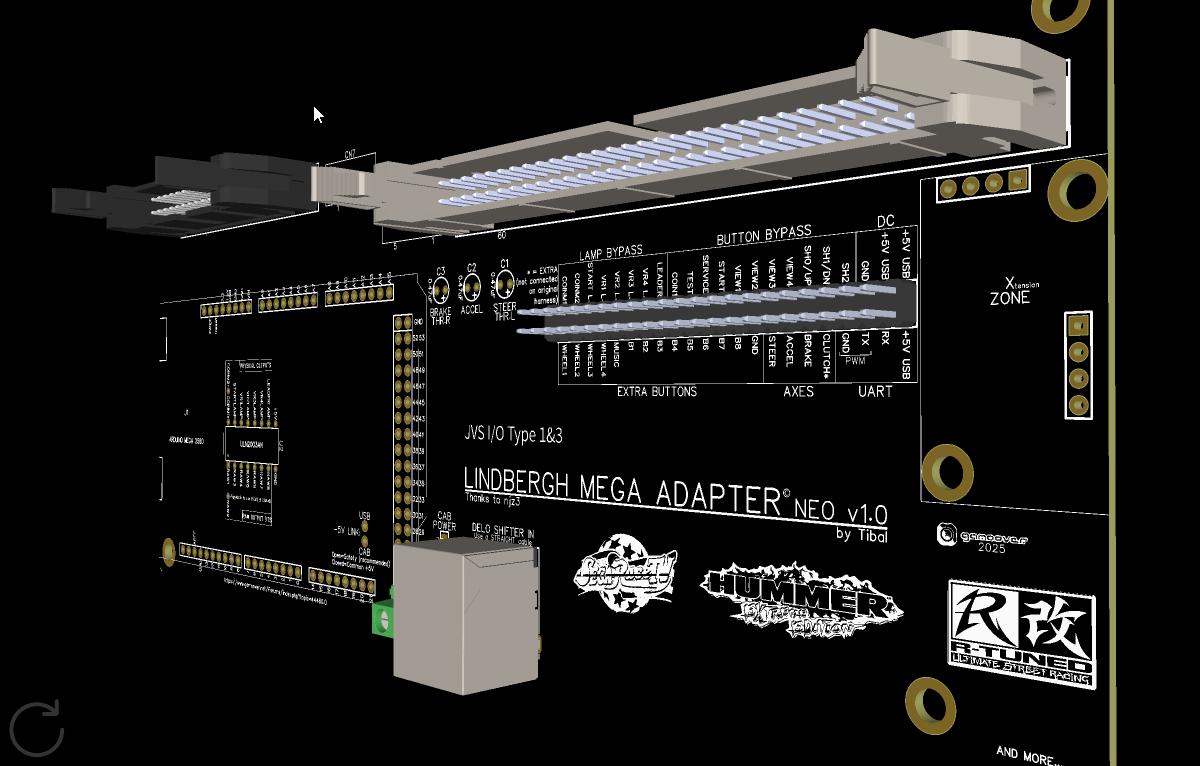

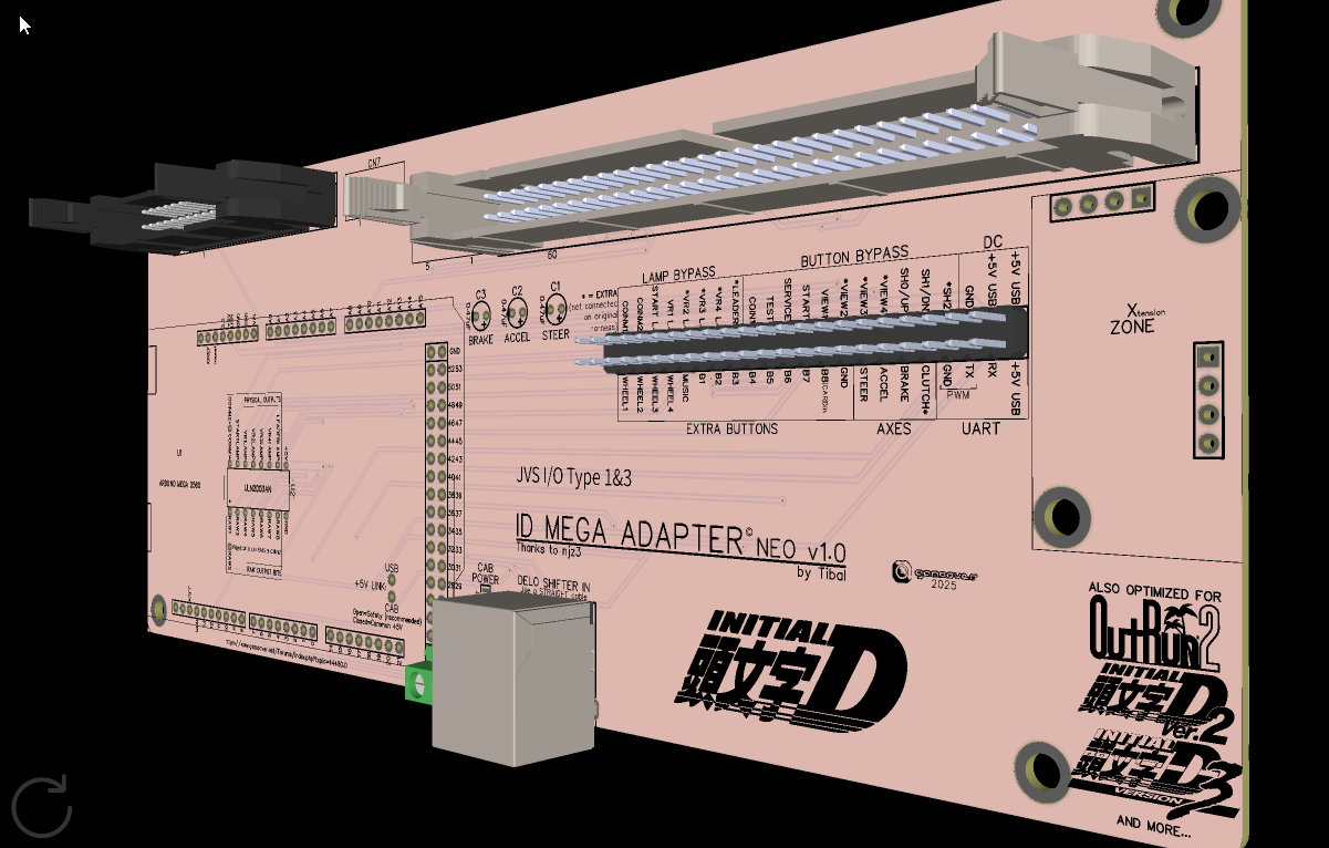

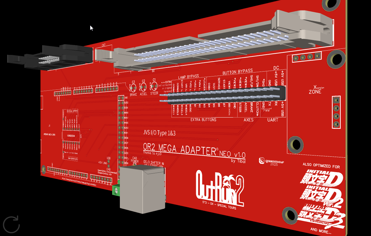

The twin sisters for OUTRUN 2 (all versions) and INITIAL D 1/2/3:

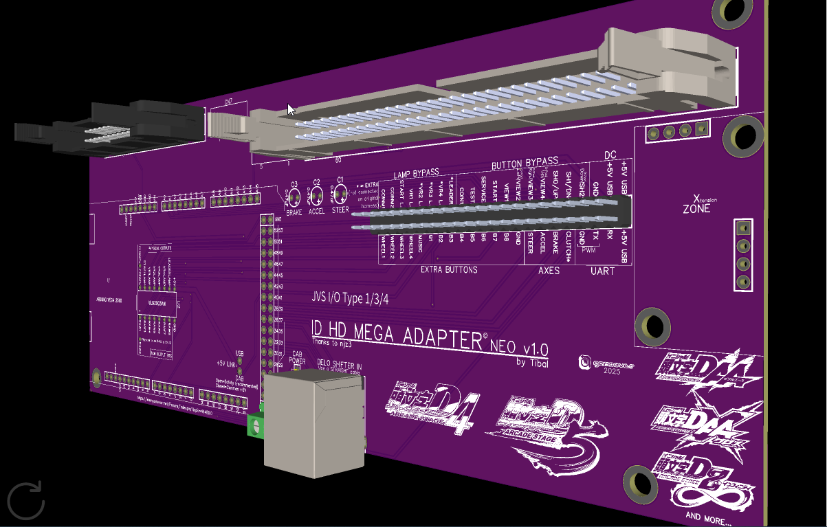

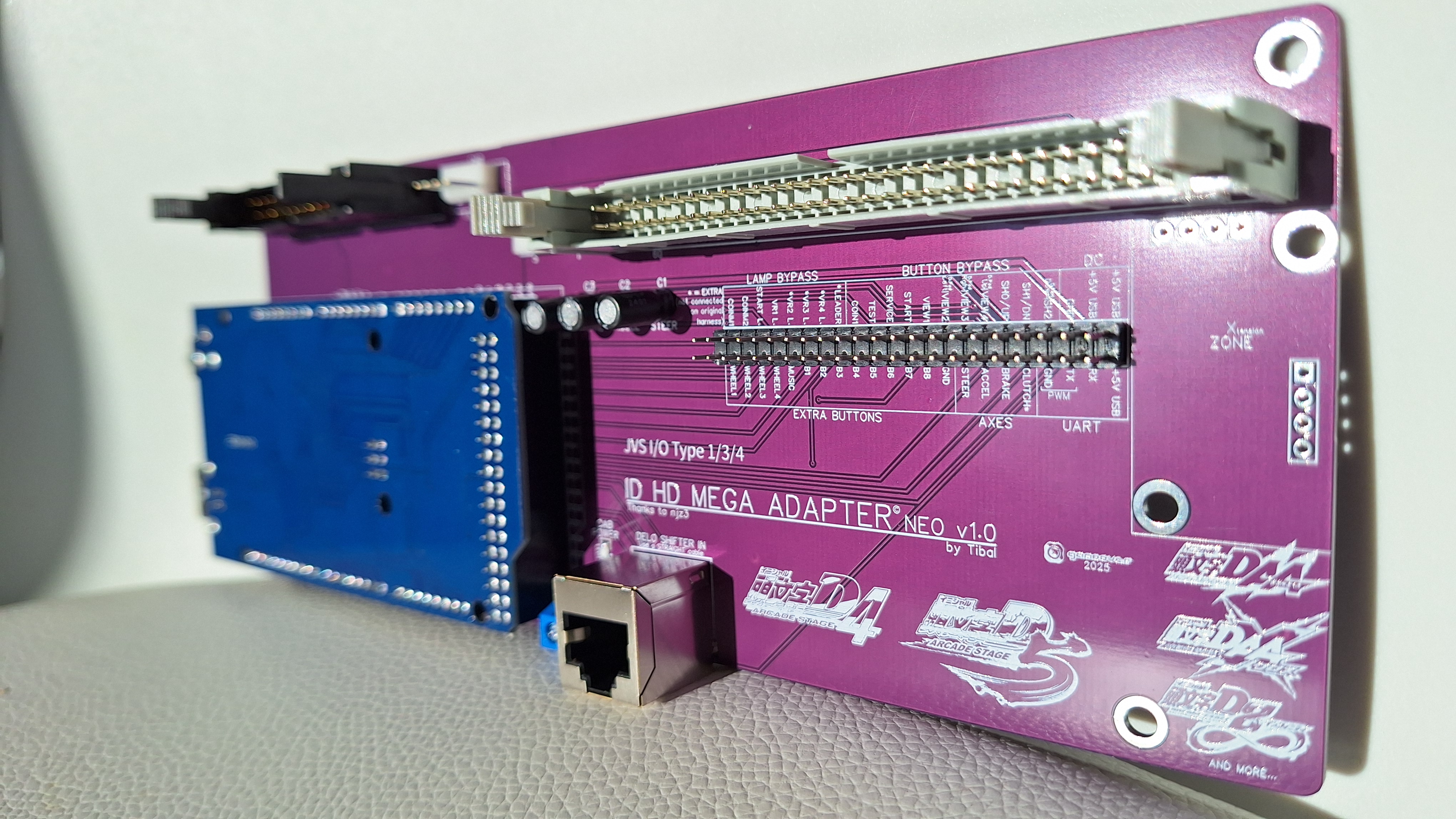

The optimized version for INITIAL D 4/5/6/7/8:
Version for other Lindbergh games SEGA RACE TV, HUMMER, R-TUNED (this one is under development):

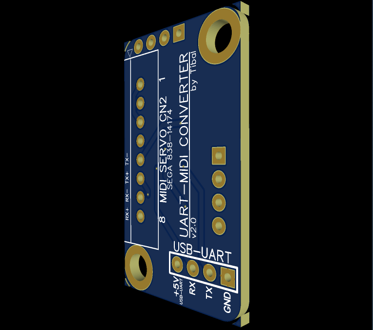

The small MIDI conversion card, to be plugged onto the Mega Adapter, or not:

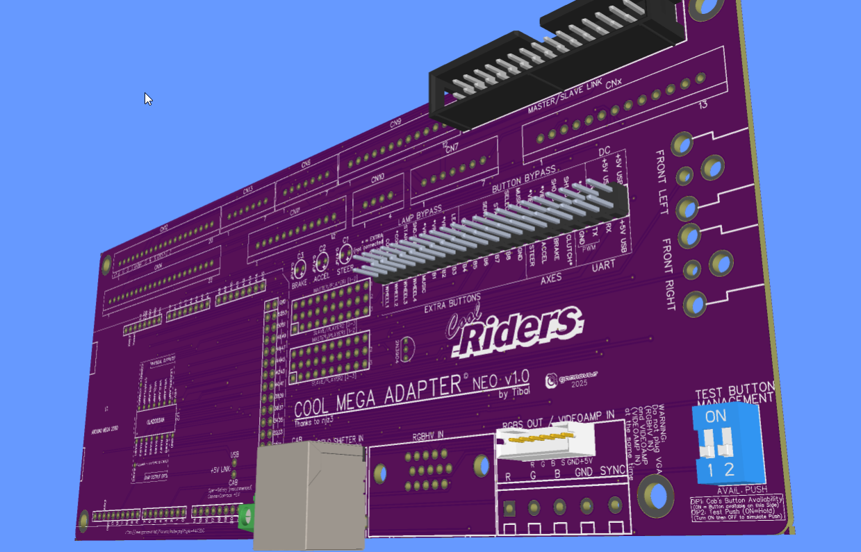

Here is a new board designed for COOL RIDERS cabinets.
This one is a bit special as the original twin cabinet has only ONE game stack to manage the two machines!
Most boards are located below the Left Player seat and therefore, almost all the wiring go there.
I had to find a solution to split the signals to 2 boards, as BackForceFeeder can only be run once on a PC, and deals with single player commands.
The solution I chose is to select the player number through jumpers, and a ribbon cable links the 2 Mega Adapters.
This has to be tested now.
Here is a dramatic view of the COOL Mega Adapter board :)

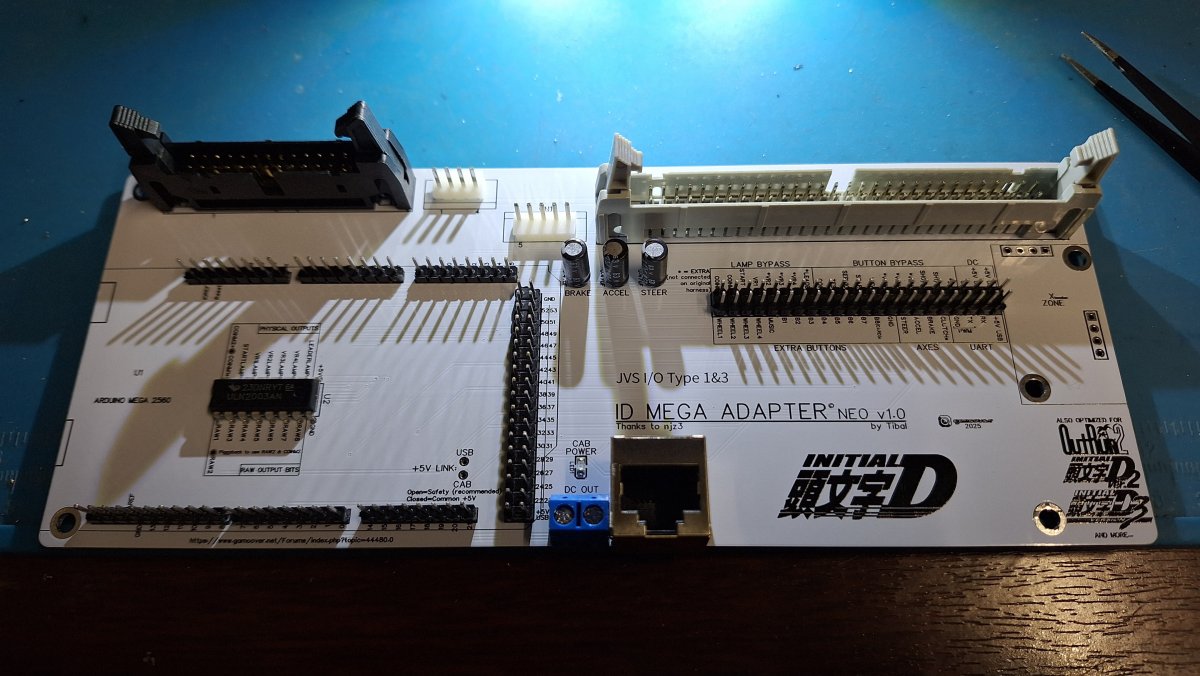

While I'm at it, here is a Real Life view of ID HD Mega Adapter I talked to you about before:
