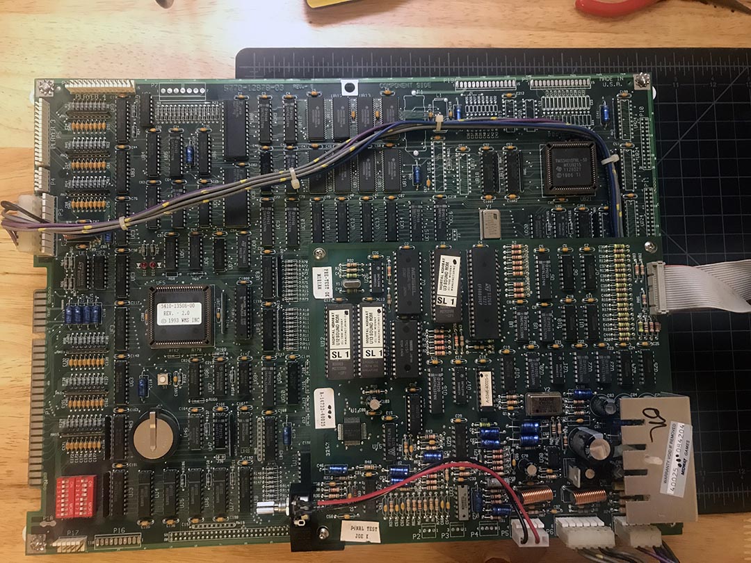

Here is my MK1 T-Unit consolidated. I went a different route with my power cable as I dont want to shorten it. Excess is zip tied and along the space on the bottom between both boards. Also used a short ribbon I had laying around from repairs, will tuck it later or just use a regular cable via Twisted's method. Kit went together very smoothly!
