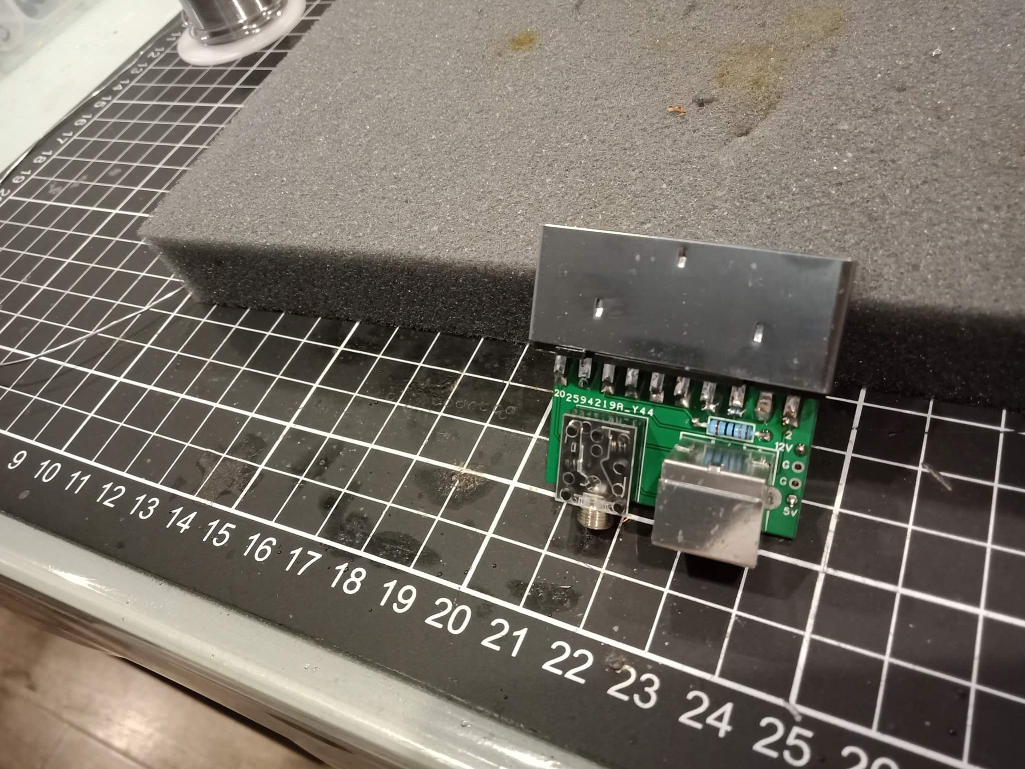

OSSC sync booster PCB prototype tested and working wonderfully. Docks straight into the OSSC VGA input, outputs TTL level sync, your choice of CSYNC or separated HV sync. Simple connection from Minigun via 8 pin Mini DIN cable. Get those pesky Taito F3 and other troublesome arcade boards working with your OSSC.

ahh wonderful!
Since it's using the VGA-Port on the OSSC you should be able to connect a 3,5mm jack to the AV3 audio Jack on the OSSC from the supergun, right?
Do you have a timeline for the release? It would fit perfectly in my setup :thumbsup:
Exactly, you take audio from the Minigun 3.5mm audio jack straight into the OSSC 3.5mm audio jack.
It's ready to go I just need to organise the download. Should be ready tonight.
The way I do it is to use either eTims scart adapter, or my version of it which will be released soon, and feed stereo audio directly into its 3.5mm jack, thus bypassing jamma audio.
Cool, thanks! I've already done a stereo mod to my mv1c and feed stereo from a 3.5mm jack to eTims scart-adapter. Your version will simplify this setup :)

In case you missed it, this will be released soon. My version of eTims scart adapter. Only thing I need to finalise is a 3D printed enclosure, and this will be worked on by TwistedSymphony.
Regarding the mini DIN 8 to VGA adapter, I have 2 versions one that only does CSYNC and one that does both CSYNC and separated HV sync. I'll probably just release the version that caters to all sync outputs. If one doesn't want / need HV sync you can use the cheaper and more common LM1882, otherwise an EL1883 needs to be used if separated HV sync is required.
