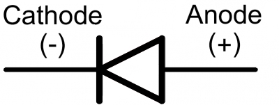

The, isn't it green?, line represents the cathode (negative). The other side is the anode (positive).

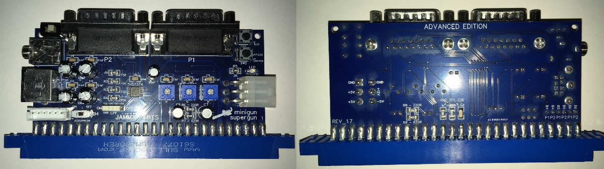

I worked on a revised version of the minigun a while ago called the Microgun. Basically I swapped the 8 pin Mini Din for a Genesis 2 compatible 9 pin Mini Din. I also changed the power input options to support a 20 pin ATX plug and removed the 3.5mm audio output because I didn't have a use for it. All of these changes made for a smaller footprint than the minigun, hence the name. Since then some improvements have been made to the minigun project so I've gone back through the Microgun file and implemented some of them.
I have increased the spacing of the controller ports, and added a voltmeter option. Another major change is that I have switched the power connector to an 8 pin Mini Fit JR. Consider this power connector to be an extended version of the standard Minigun pinout. It adds an extra +5v pin and, more importantly a power switch pin. The reason for this is to allow you to attach it to an ATX power supply through an adapter cable and still be able to control the power with the built in power switch on the Microgun. If you plug a standard 6 pin Minigun power cable, the built in power switch simply does nothing.
The footprint is incredibly small, just 112.2 x 38.7 mm.
Here's an Oshpark link.
Also for fun I decided to make a fixed resistor version that was as small as physically possible. I call this one the Nanogun, it's basically a cross between the old Minigun Advanced and Standard versions.
This one measures in at an unbelievable 111.1 x 34.3 mm. I honestly doubt anyone could get a supergun any smaller than this without going to a four layer PCB.
Here's an Oshpark link. I still need to add a BOM for these.

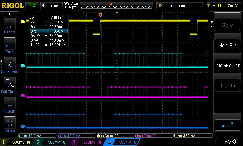

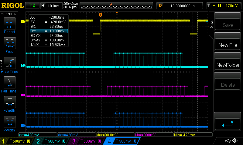

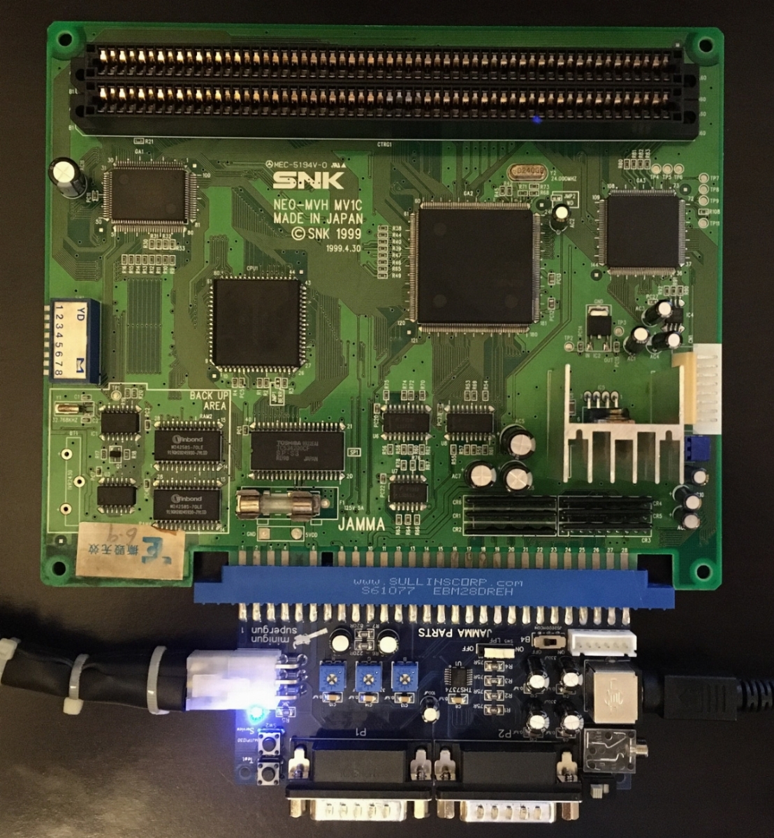

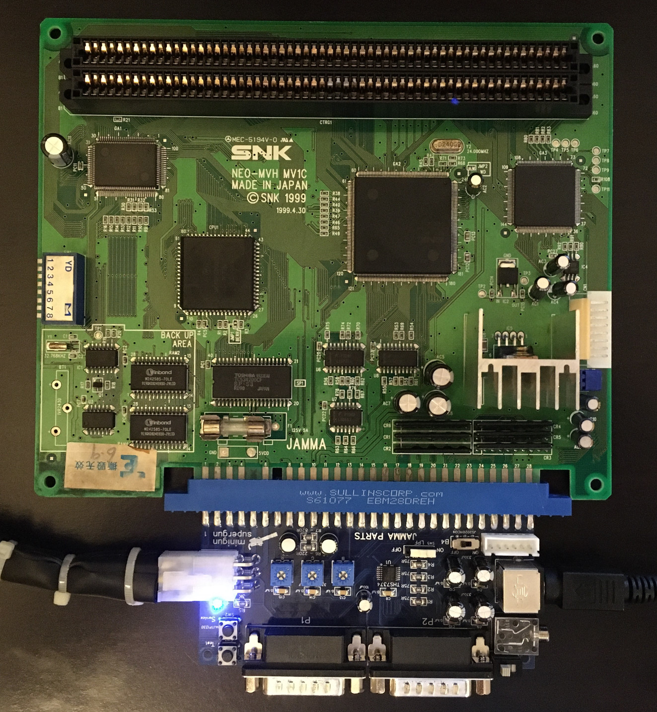

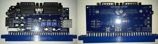

Hi. I have been following this project for a while and finally took the plunge into the NeoGeo world, thanks to the work by Frank. However, I am having (I believe) an issue with the sync output. I am currently getting a black screen and my OSSC states that no sync is found.
I have assembled a v1.7 board as you can see below, I am competent at soldering but I am trying to figure out if I have made any mistake that I am unable to recognize. I have traced most of the video circuitry and it seems correct according to the schematic. I have also checked that the voltages across the 75 ohm resistors on the output are approximately 400mV.
The oscilloscope image that I am showing is for I believe is the cross hatch pattern since I do not have a cart in. The R-G-B signals are at least in the ball park, but the sync signal (Yellow) is actually carrying a negative voltage, as you can see by the cursors BY and AY.
Yellow line= Sync signal
Cyan line = Red signal
Pink line = Blue signal
Blue line = Green signal
Any help would be greatly appreciated and thanks again to Frank for this great project.

@bandit412
What kind of NeoGeo do you have?
The OSSC sync settings needs to be tuned from accepting basically 0 lag in the sync to several ns. if you use the "older" ones like the MV1FZ (got the china edition of this one). Follow the settings http://junkerhq.net/xrgb/index.php?title=Neo_Geo_MVS
I only had to adjust the Hsync Tolerance.
edit: I also reacted on the negative voltage, but both the NeoGeos I've scoped have this pattern. I'm using an analoge scope. My 1C works without adjustments, but I would try the suggested settings above.
Hi @vidarw
It is an MV-1C also. I tried connecting it to the XRGB-Mini using FirebrandX's Neogeo profile and also with SYNC_MODE set to OFF as suggested in your link and still no image. Unfortunately, I do not have a monitor that accepts RGB through BNC so I am stuck with having to go through either the OSSC or XRGB-Mini.
I also noticed that the 3rd line on the XRGB-Mini's input status page (attached) shows no resolution and an odd value for the frequency which should be approx. 60Hz.
