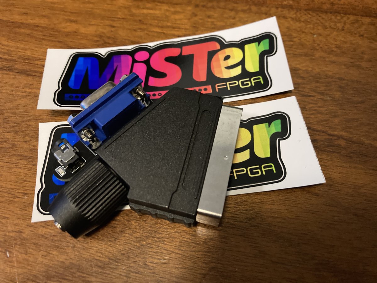

When searching for a SCART cable for my MiSTer, the bulk majority of options were VGA to BNC connectors, which wasn't suitable for me as I use a SCART switch and wated a SCART cable. Both retro access and RetroGamingCables have cable options, but they're frequently out of stock, and shipping for a single cable is quite costly at the moment.
Speaking to @evilsim, he suggested Tim Worthington's VGA2SCART 2.0 device which I've been using for a couple of hours with no issues. Picture and sound quality is fantastic and working fine on my Hydra 16-Port SCART Switch.
Setup was simple, put a jumper shunt on the Analog IO board to allow 5v power to Pin9 on VGA and then make sure "composite_sync" to is set to 0 (off) in mister.ini, as the VGA2SCART converts the H/V sync signals to CSYNC.
Hope this helps someone out, you can buy the adapter direct from @evilsim on eBay or pop him a PM here, I'm pretty sure he'll ship internationally.
More info from Tim Worthingtons site -- https://etim.net.au/shop/shop.php?crn=220&rn=582&action=show_detail:
"Useful for connecting an emulation computer to a television set or monitor. This device makes the VGA signal electrically compatible with SCART. The video timing must already be 15 khz, this adapter does not change the video timing.

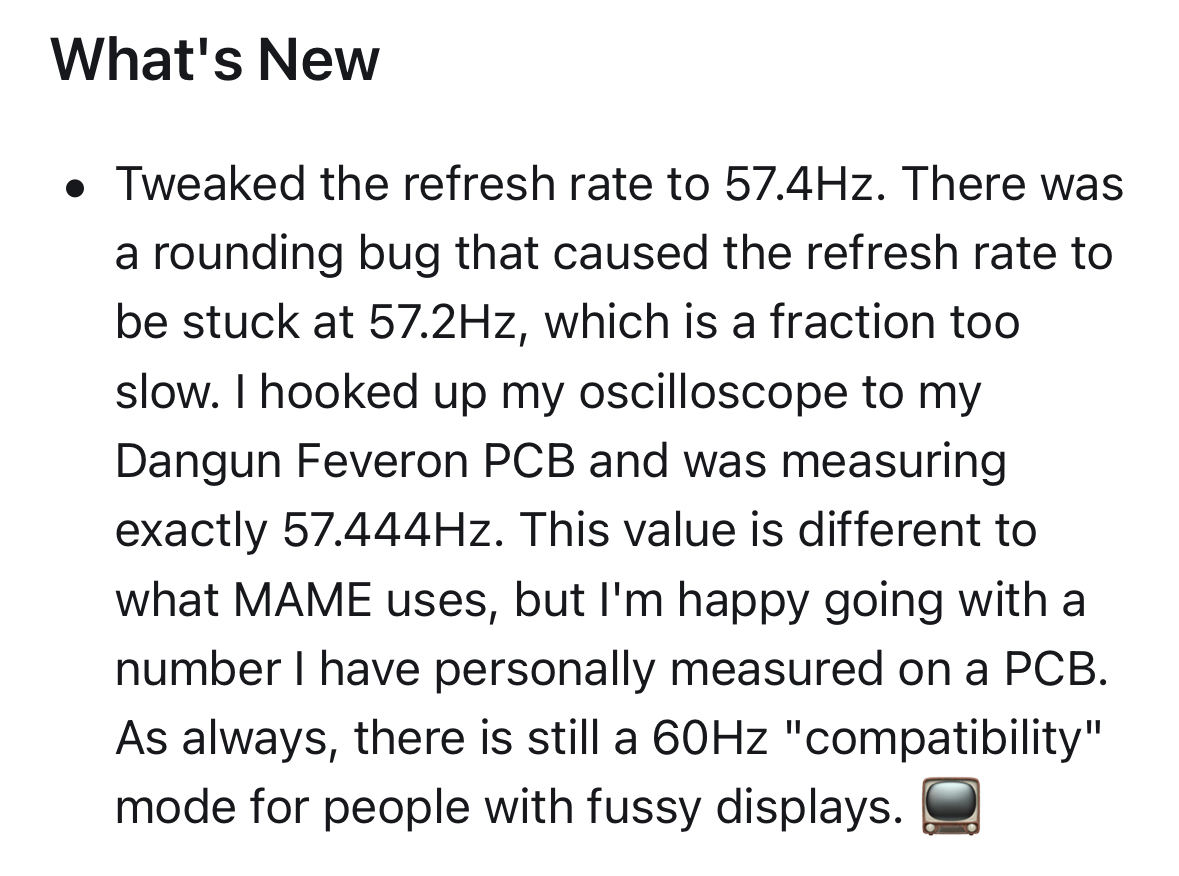

Can't find much info about this problem, except for a few people experiencing the same thing. Development on the Cave cores seems to have stopped(?) as well.

The Cave cores default to 57 hz refresh which matches the original arcade boards but some displays don’t like it. If you go into the Video settings in the core and change it to 60 hz refresh then that should fix the rolling picture.
FYI: you’ll likely run into similar rolling picture issues with other arcade cores that use non-60hz refresh rates, such as the Irem M72 and Irem M92 cores.

Maybe I'm comparing apples and oranges, but my monitor displays other Cave games just fine when using a real PCB - for example DonPachi, DoDonPachi and ESP Ra.De. I'm using a HAS supergun with the monitor, but as I said, I don't know if that is a good comparison.
Anyway, I set the refresh rate to 60hz in the Dangun Feveron core, but it didn't fix the problem. Still a rolling picture. Actually it made it somewhat worse - the picture seems to be rolling a lot faster now.
Another data point - I tried 60hz in a few other Cave cores as well, but no improvement.
I've been going through and testing lots of arcade cores tonight, and the Cave games are the only ones with this issue that I've found so far.

Interesting - if the 60hz setting didn't fix it then something else must be going on.
There's already a bug report for the issue in the GitHub bug tracker for the Cave core - I suggest you add your information to this bug report as well so it raises it to the top of the list. I believe nullobject is still working on the core - his GitHub shows lots of activity - he just hasn't released an update in a while.
https://github.com/MiSTer-devel/Arcade-Cave_MiSTer/issues/117
In the meantime, you may be able to play the Cave games by reverting to the last core released before he tweaked the sync signals.
