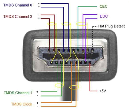

1. CEC Issues: I faced a lot of problems with CEC and the MiSTer plugged in. Devices stopped turning on and off and it was just a mess. The fix was simple, I just removed Pin #13 on one side of the HDMI cable and all is good now. I've attached a diagram below to show which pin to remove. I simply used a solder pick tool and pushed the pin down, cutting through the plastic and then used some tweezers to yank it out. I believe @misteraddons will be selling CEC-Free HDMI cables in the future.
