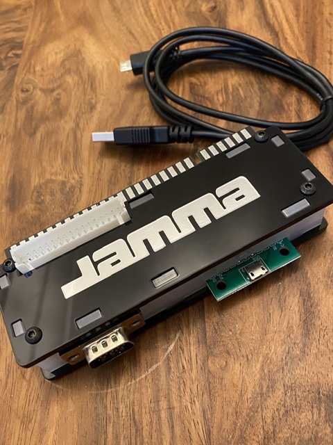

Got this today. I’ll post my thoughts once I get to try it out tonight.
