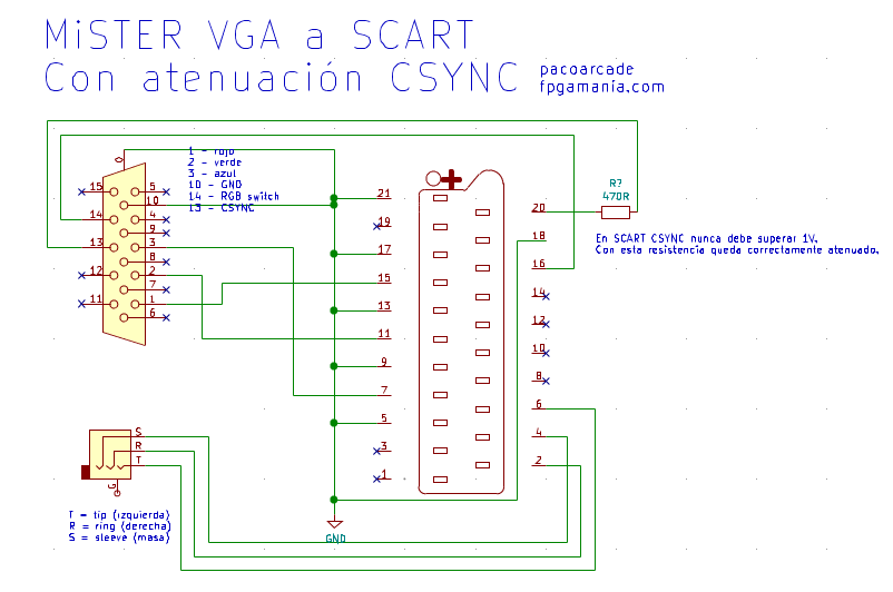

Can I ask if anyone of you have had this issue before. I recently got my mister kit, but the guy forgot to send the vga to scart cable. I still wanted to test it out though, so I took the one I bought to the Analogue DAC and connected it to my CRT TV (PAL).
The image just spinned around, like it couldn't handle the sync, and was very hard to see. I went into the sd card and changed csync to 1. Image stopped spinning, but the image is still incredibly weak / dark. Can hardly tell what it is on the screen. I thought it should handle 15khz / 240p out of the box with the analog io board.
What am I missing?
Is your adapter based on the AG6200 chip? when you are using a HDMI to VGA adapter you must set direct_video mode in your mister.ini.
I'm using this wiring with a Rankie adapter and it works fine.
Although that would not solve the dark image issue, don't forget to put a 470Ω resistor in series for CSYNC.
@pacoarcade you didn't have to change any jumpers, or through holes, to get 3.3v or 5v through the vga/scart contact? Seems some people are hinting at that.
If I recall correctly, this adapter doesn't have 5V output, but pin 14 from the VGA out has RGB Switch, this goes to pin 16.
I didn't change any physical setting in the DE10-Nano, just the csync and direct_video options in mister.ini.
So it seems like the analog io board I got did not come with any jumpers at all, stealing some from an old motherboard and setting it so you get 3.3v out through the VGA port helped with the issue. The image is now proper brightness. Why the fuck would he sell the boards without the needed jumper...
