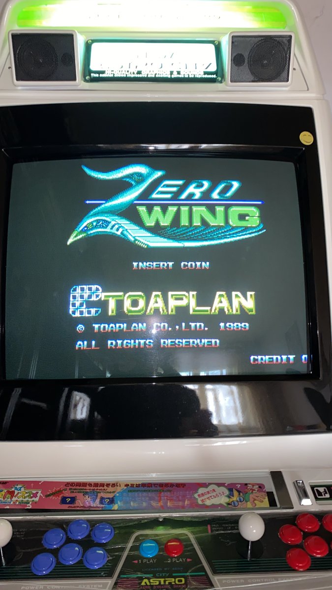

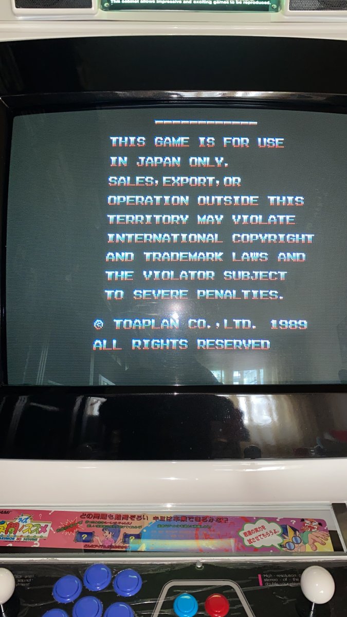

I have a vewlix DB with the 1080p stock monitor. I just set up a mister but only the de10-nano with SDram running with a jpac2. For video im running a VGA to HDMI Adaptor. So i put the mister resolution to 1920X1080 60Hz but the screen goes black then back on every few seconds like its going in and out if sync and sometimes it will last a few minutes good but then it goes back to the black screen every few seconds. I also tried 1920X1080 50Hz, Any suggestions on how to fix this issue?
I was not sure where to post this so i choose this thread.

Those monitors have a vga and a dvi input.. why not use the dvi input and a dvi to hdmi cable..that should work

So i can confirm that the issue im having with 1920 X 1080 res that give me a black screen every few seconds has stopped by switching to DVI.. i will order the analog i/0 board for sound.. and i will also try the VGA to VGA from the analog to vewlix monitor like @muffman says he is using.
