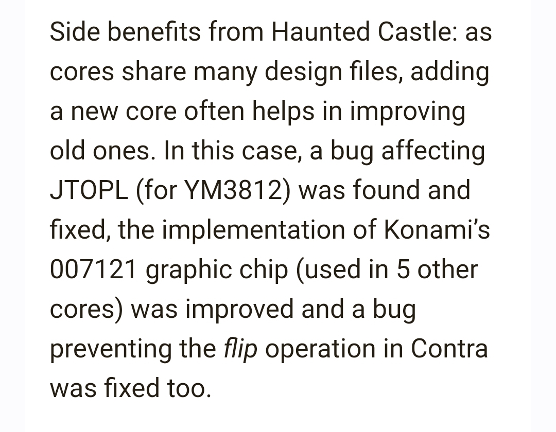

This note came with the Haunted Castle beta update, released today. Looks like a byproduct of this core development is that the Contra screen flip problem has been addressed?
I just got home from a vacation but need to update my files and give it a go!This note came with the Haunted Castle beta update, released today. Looks like a byproduct of this core development is that the Contra screen flip problem has been addressed?

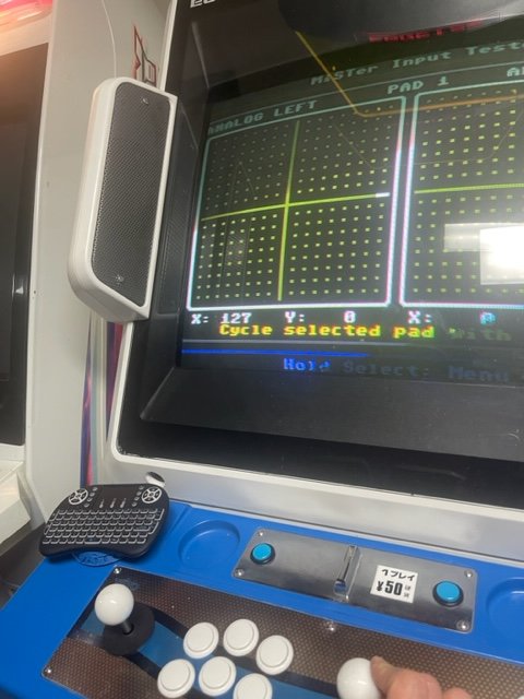

In the utility menu of the mister, there's a controller test.
if you go in there and HOLD the start (select) button, you'll get a popup screen and you can choose ANALOG.
If you hit LEFT on joystick 2, does it activate X to 127 as such ?
I am trying to get this PSX game to work with 2 joysticks and it works except when firing on the left, with the bug above, our hero goes RIGHT at the same time... which kinda sucks.
Tried on another cab and same thing.
What about you ?! thanks!
I'm not sure I totally understand the issue, but I love your Egret 29!
P2 stick is mapped as an extra analog stick on MiSTercade so you can do twin stick shooters.
Left and right should not be reversed though. I know the party is already over so I'm not really sure what you can do.
I'll take a look at the analog output of the input mapper and see if it's mapped backwards. When I came out with the feature, PSX core wasn't even rumored, and there was no way to check which axis are reported as which on MiSTer, let alone Windows, etc.
In order to have twin stick support at all, P2 stick maps to some axis. Playstation core automatically decides which axis are analog sticks. I don't think there's a solution that will allow for MiSTercade twin sticks, and the playstation core.The issue is that the twin sticks works except shooting left (with player 2 stick) also moves to the right.
That move to the right is the only thing registering in the analog test. Get rid of that and the issue would be fixed!
