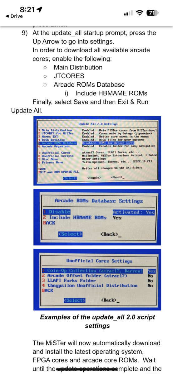

My many arcade game not load. Just run update_all script for 2 time but nothing change.

You have to go into Settings for the update_all Script and enable the arcade cores.

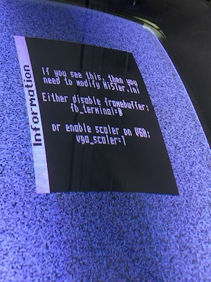

Thank you for reply. I forgot to tell you that My cabinet have rotate CW monitor . I also change my mister.ini to be a 15kHz-TATE-CW one.
When I launch an update_all script it show an error message "If you see this, then you need to modify Mister.ini either disable framebuffer fb_terminal=0. or enable scaler on VGA: vga_scaler=1
at first I try vga_scaler=1 then the monitor can't display properly. so I change vga_scaler back to zero. and set fb_terminal =0 this time the script can start. I notice all text showing in a window not full screen as usual. It's not have any countdown for press an up key to go to setting menu. I try to press up key many time but it does not work.
So I try replace a mister.ini to 15kHz-YOKO one. the display is retate but can launch update_all script as usaul. this time I can get in to the setting menu and it does the job.
Is it a way to get in to the setting menu with a 15kHz-TATE-CW mister.ini?
