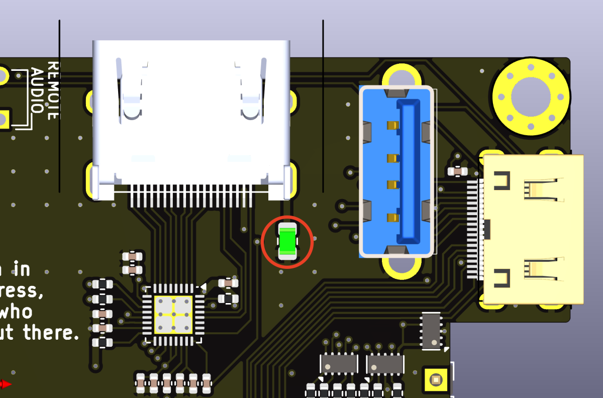

2) I left a 0 ohm resistor between the HDMI shield and ground in the final design. Will someone experiencing the issue try desoldering this? If no one feels comfortable doing so, I can send out a test board to someone in the US. I'd prefer not to experiment with international shipping in the mix, haha.

Removed the resistor and everything looks the same unfortunately.

I'll remove and test today. I brought my electronics lab with me to work for this moment lol
