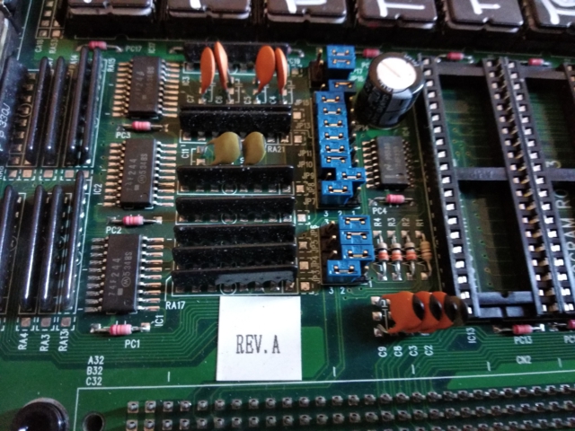

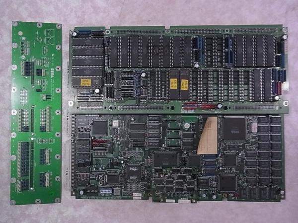

Little update as I've made some progress with Pilot Kids! I moved the jumpers so they're all the same position as Dynamite Cop, and the game boots with normal background and 2d graphics, but messed up polygons (big triangles moving around the screen).
I haven't heard back from Shou yet. Does anyone have any pointers as to which jumpers are still in the wrong place? Seems like I'm getting close!

You'll want to take a look at the differences between Dynamite Cop and GunBlade... Pilot Kits should be somewhere between the two.
This is the best I have, but I’ve managed to get it to work with this pic.
I think you need to adjust the two jumpers on the right on my picture, they’re next to the four roms on the top right.
thanks very much - do you mean JP19 & JP20?
it's a little bit difficult to see on your picture - I have them set as follows: JP20=3&2, JP19=1&2. Same as Virtua Striker, as i hadn't changed them!
yes, those two.
I think they should be exact the opposite.
AtM I'm programming Pilot Kids again, I'll post a definitive picture later.
