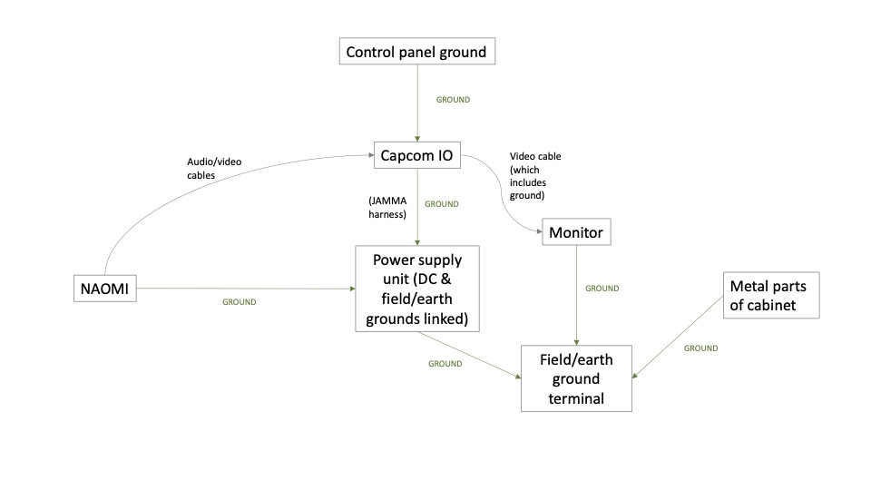

I'm attaching a diagram of my current setup showing where ground lines go. But first, a few notes:
1. DC and field/earth ground terminals on my PSU are linked as per the cabinet's wiring diagram. Without the link, there's vertical video interference on Neo Geo one-slot and other boards I have tested.
2. Two-prong power cable was replaced a long time ago with a three-prong grounded cable.
3. Horizontal banding is only (most?) visible using NAOMI and not on other arcade boards, (tested MVS single slot and CPS2 and no horizontal banding).
4. Cabinet is all metal frame, (Mini Cute). Not sure if that matters.
5. I don't hear any of the audio hum associated with ground loops.
6. I have lots of ferrite beads on the JVS and JAMMA power harnesses and also the audio and video lines.
7. Both the Capcom IO board and NAOMI share the same PSU—the Mean Well QP-150 which has the 3.3V JVS requires in addition to 5/12/-5V for JAMMA.
8. Monitor chassis, NAOMI, and Capcom IO have all been re-capped.

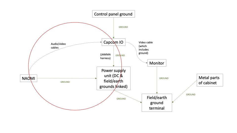

Given I'm only seeing the interference on the NAOMI, I suspect the ground loop may be here:
I also thought ground loop may be between monitor-field ground-PSU-IO but all of my other boards work fine with this same setup.
Any thoughts on where I should be looking? Is this even related to a ground loop? Thanks!
UPDATE: I disconnected the ground of the AC/mains power cable—no change.
I unlinked the DC and field/earth grounds of the PSU—no change.
I confirmed proper voltage on the 3.3 and 5V lines.

I replaced the power harness on the NAOMI with UL1007 rated wiring and I think it helped but the horizontal banding is still visible. I connected same setup to it Sony PVM and the banding was less but still visible on lower brightness. I have also since gotten rid of the Capcom IO in favor of a MultiJVS and the banding is still visible but barely noticeable during gameplay. Maybe I’m just getting used to it?
Since the only constant is the NAOMI and netdimm, I think the issue must be there somewhere.

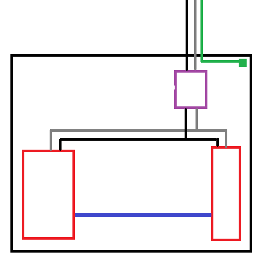

J
jassin000
Inside a cab all power supplies are behind a isolation transformer, thus NO PSU should be connected to earth ground PERIOD (I don't give a shit what the manual/manufacture says).
The DC grounds of any/all PSU's should be bridged/jointed together, however DC grounds NEVER get mixed with earth ground... NEVER!
  • Purple = Isolation Transformer (should sit on feet/wood to keep electrically isolated from body/Earth Ground)
  • Red = PSU #1 JVS (should sit on feet/wood to keep electrically isolated from body/Earth Ground)
  • Red = PSU #2 Cab (should sit on feet/wood to keep electrically isolated from body/Earth Ground)
  • Blue = DC ground tired between PSUs
  • Gray = AC Line
  • Black = AC Neutral
  • Green = Earth Ground (connected to cab body and nothing else/isolated from transformer and PSUs)
