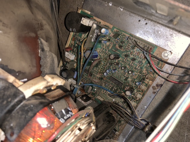

I went go test my Domy Theater replacement 33" monitor but once again I'm stuck reverse looking up a chassis for a diagram.
I have the connectors for Rgbs to crafty, But Im stumped trying to find the AC input on this chassis.
Has anyone come across this 33" tube and happen to know which chassis I have?
The tube is a Panasonic 33" SI78JUA29X
Here are some pictures of the chassis.
And this a weird connector on the corner of the Monitor frame..
Can anyone tell me a good place to start looking into this?
I am not familiar with that chassis... I would say look for the main fuse, typically F1. The AC mains input will typically be adjacent to F1 with the fuse being hooked up directly to the live/line wire.
These spring like fingers should be making direct contact with the dag layer on the back of the tube. That degauss coil should be placed a little differently so it's not interfering.
