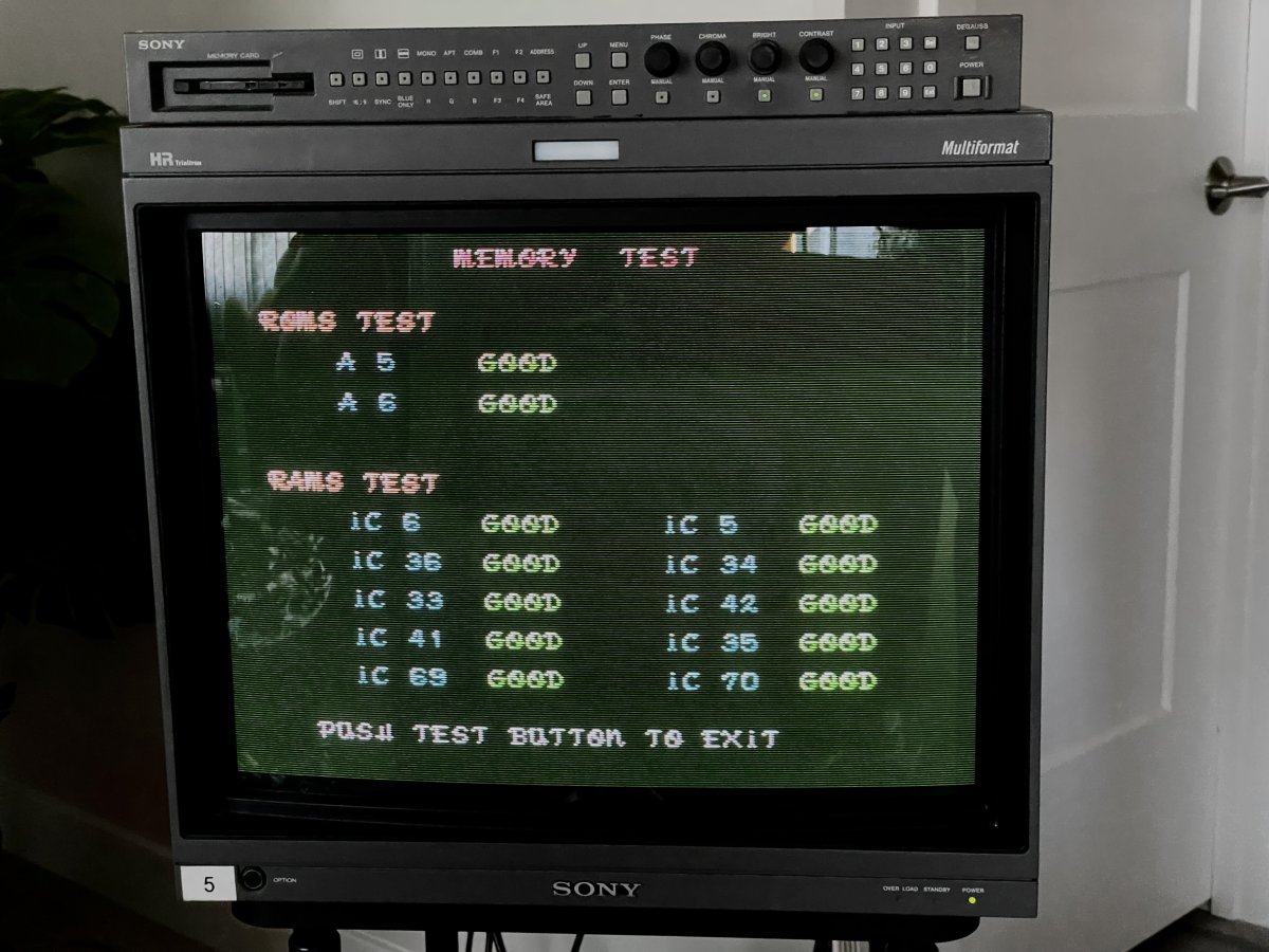

@Gamesmonkey, let me know if you get to the first boss (stage 1-3) and if the picture is clear or if you see corruption. That was the only spot where I saw corruption. Stage 2 is just fine as well...
Okay, I played Shadow Dancer a bit further... I saw a lot of corruption on the first boss.
Did you or anybody else see any issue like that as well? Please let me know.
What does the rom test say? Are they all marked as OK?
Yeah, they come all OK across the board.
That doesn't tell much about the ROMs specifically because only the program ROMs are tested, not the sprite/tile roms, and those are the ones that the custom chip on the ROM board interfere with.

If it was a badly flashed rom, you can try to locate it by removing them one by one and see when the error changes. Could you attach a pic with the issue? I think I can help you to locate it.
