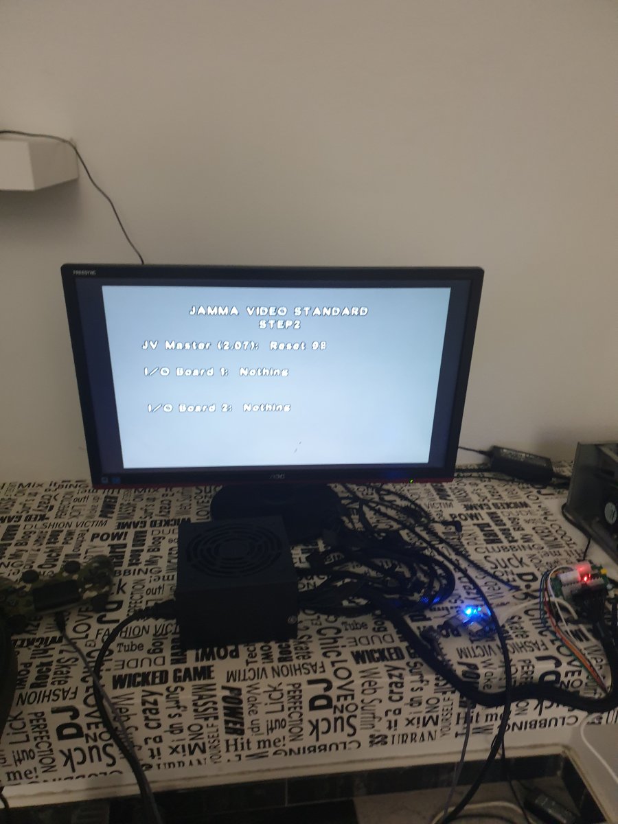

Just received a supposedly working TTX2 with multi. My only JVS device is one of these boards. Would a "Could not read DIPs!" error on boot be caused by the MP07? All internal cables are where they're supposed to be.
E: Just to expand, the blue light goes solid and this happens with a normal 360 pad and Hori RAP
Hello,does somebody know how to fix this error?This is on a namco system 246c.
Every cable connected to the board is new so I don't think it's any of them,first time I connected the jvs board to the system tekken 4 was starting but then after the intro the screen went white then nothing happened so I restarted it but now it stays like this.
I would update to the latest f/w and then press and hold the test button when plugging in the USB cable to switch between activate or inactivate the "JVS data signal level adjustment".
If that doesn't work, I would change the device so you "Declare namco JYU compatible I/O device name against the JVS query (*1)"
All the info is here https://toyoshim.github.io/iona-us/en

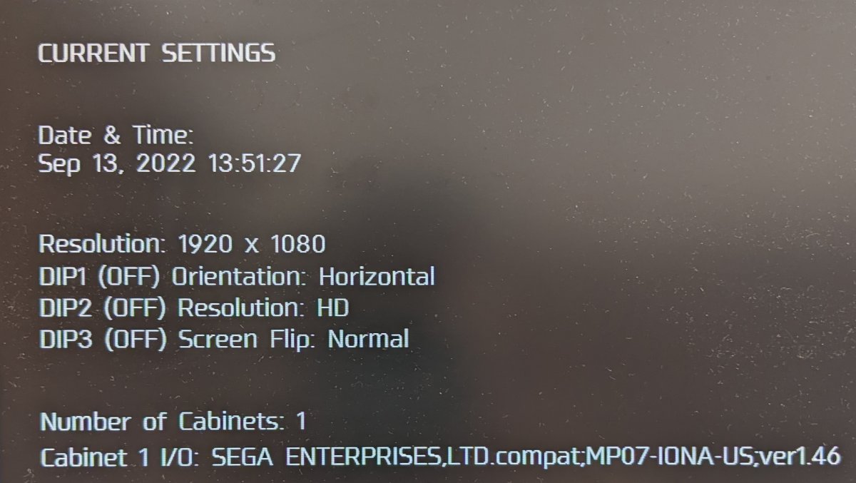

Has there been a fix for the naomi? I have the version with the type c. I'm on 1.44 firmware. I have issue with a 2 player setup lagging and if I unplug it, it give an io error if I plug a controller back in. I have tried on Naomi 1 and 2 and the controller are ps4 and Brooks UFB. One player work fine if I leave controller in.

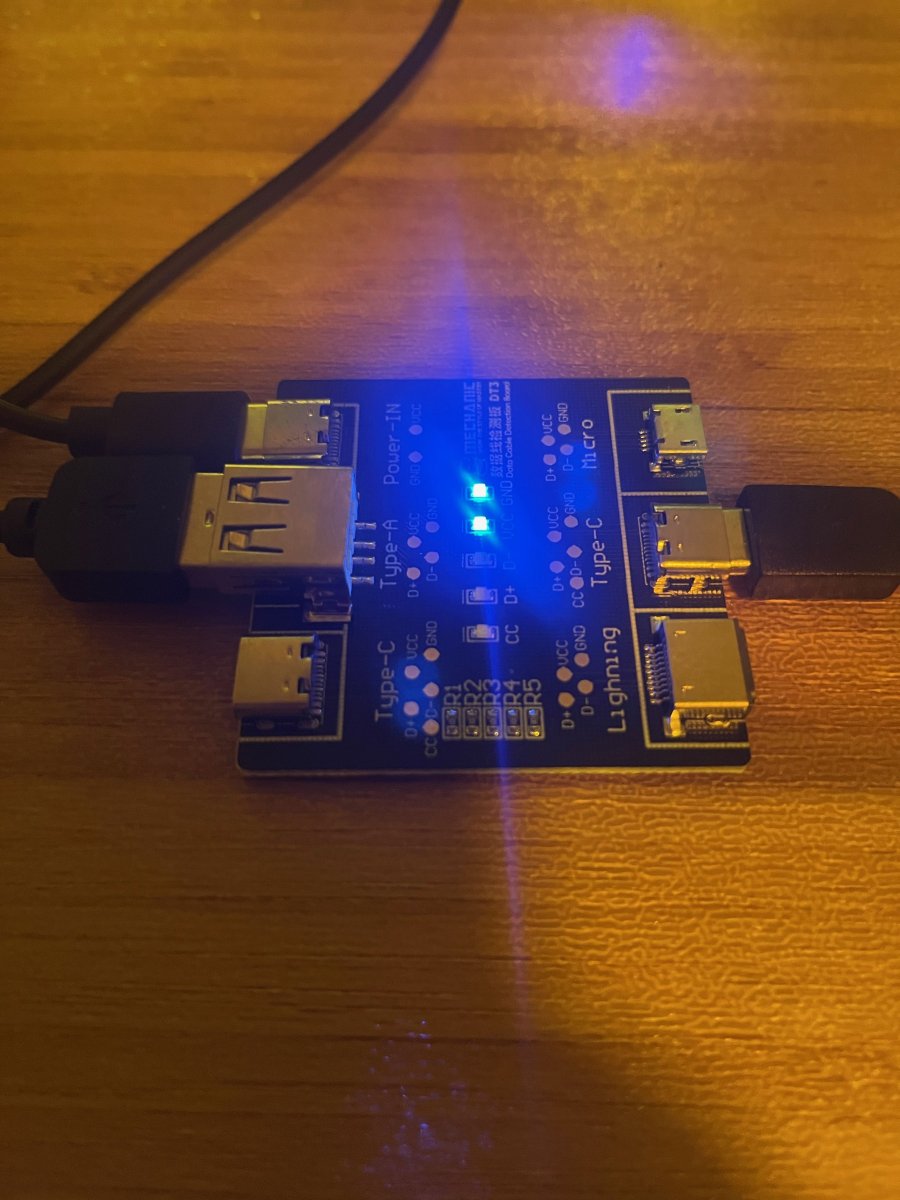

Been trying to update the firmware but Chrome doesn't recognize the device. I ordered a USB 2.0 hub to see if that will work. i've been using staplers but may just end up soldering in pins and using jumpers. i'm just getting ready for the JVS Dash update for exA
Hey guys, i previously updated my firmware but now it just says 'device cannot start'. Am I missing anything?
What are you running it on?
What controller? Did you map out your inputs?
What are you using to power the IONA?
I’m just trying to update the firmware to the latest on windows 10.
Using a micro usb cable to 2A wall charger.
I finally got it to work.
It did not like any of the Blue USB 3.0 ports front or back on any of my computers. I used a Red USB 3.1 port on my motherboard and Windows liked it.
