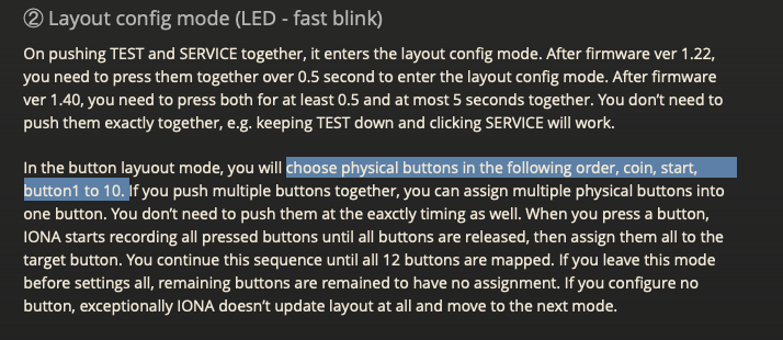

According to the guide, in LAYOUT CONFIG MODE, I have to press a button in the sequence Coin, Start then button 1 to button 12....
my question is what is the exact button sequence here? How about directional buttons like UP, DOWN, LEFT, RIGHT?
Also is remapping buttons for P1 only? or is it for both P1 and P2?
For my VSHG, I've done it as Select, START, b1 = LP, b2 = MP, B3=HP, B4=LK, B5=MK, B6=HK and then press test again. Directional "just works".
I have no idea how to make it work for 2 different sticks as each time you do a config layout is "one" config and you have up to 10 configs. If I use a VSHG and another stick, I have no idea which config to use to allow them for both to be used. If I use 2x VSHG's, it works fine. But two different sticks.. I have no idea.
Thanks for the info, i managed to get it working.
I believe when they mentioned "12 buttons" ---> it must be first 6 buttons for P1 and then another 6 buttons for P2.
