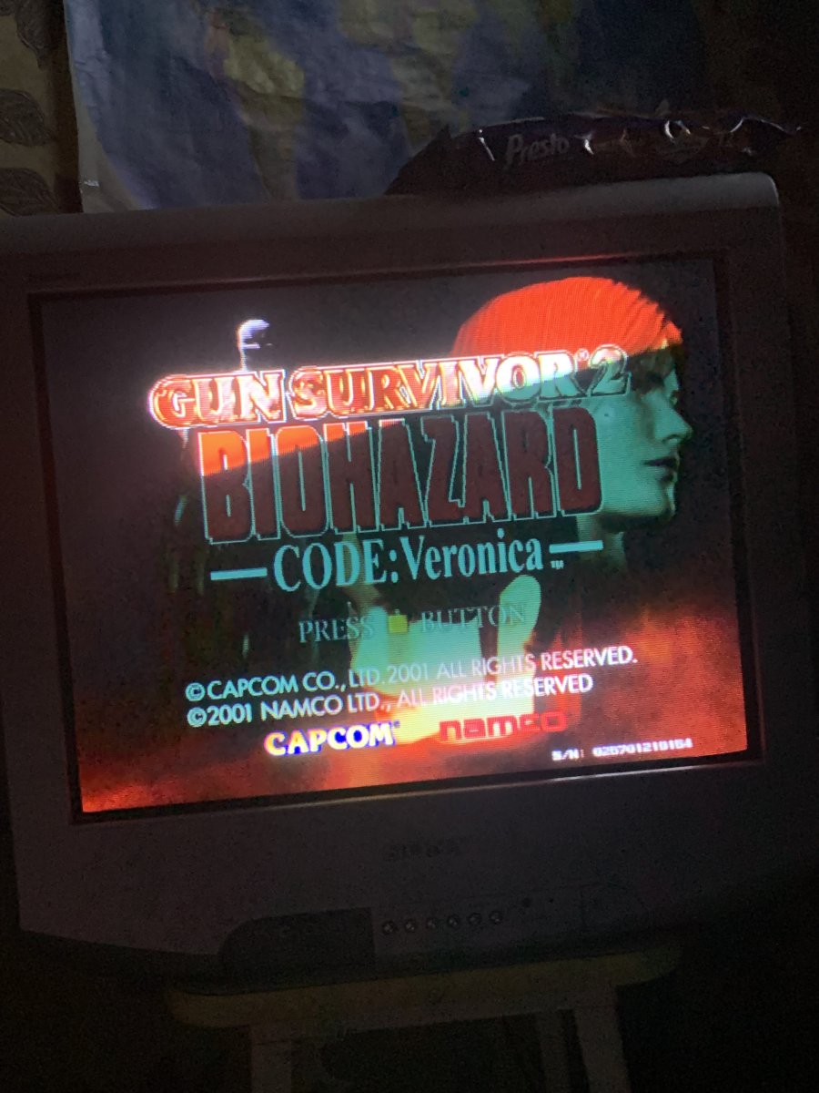

crazy taxi fail name is - 1 set ... (Maximum speed and Faster than speed)
Virtual on - 3 set
Gun survival - 2 set
Safari - 4 set
Maze - 5 set (also Confidential Mission)
use ps4 gamepad, latest Firmware v2.22

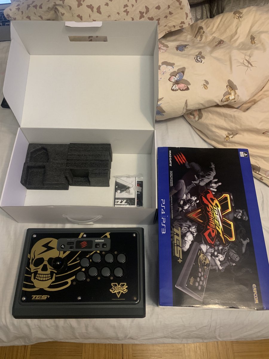

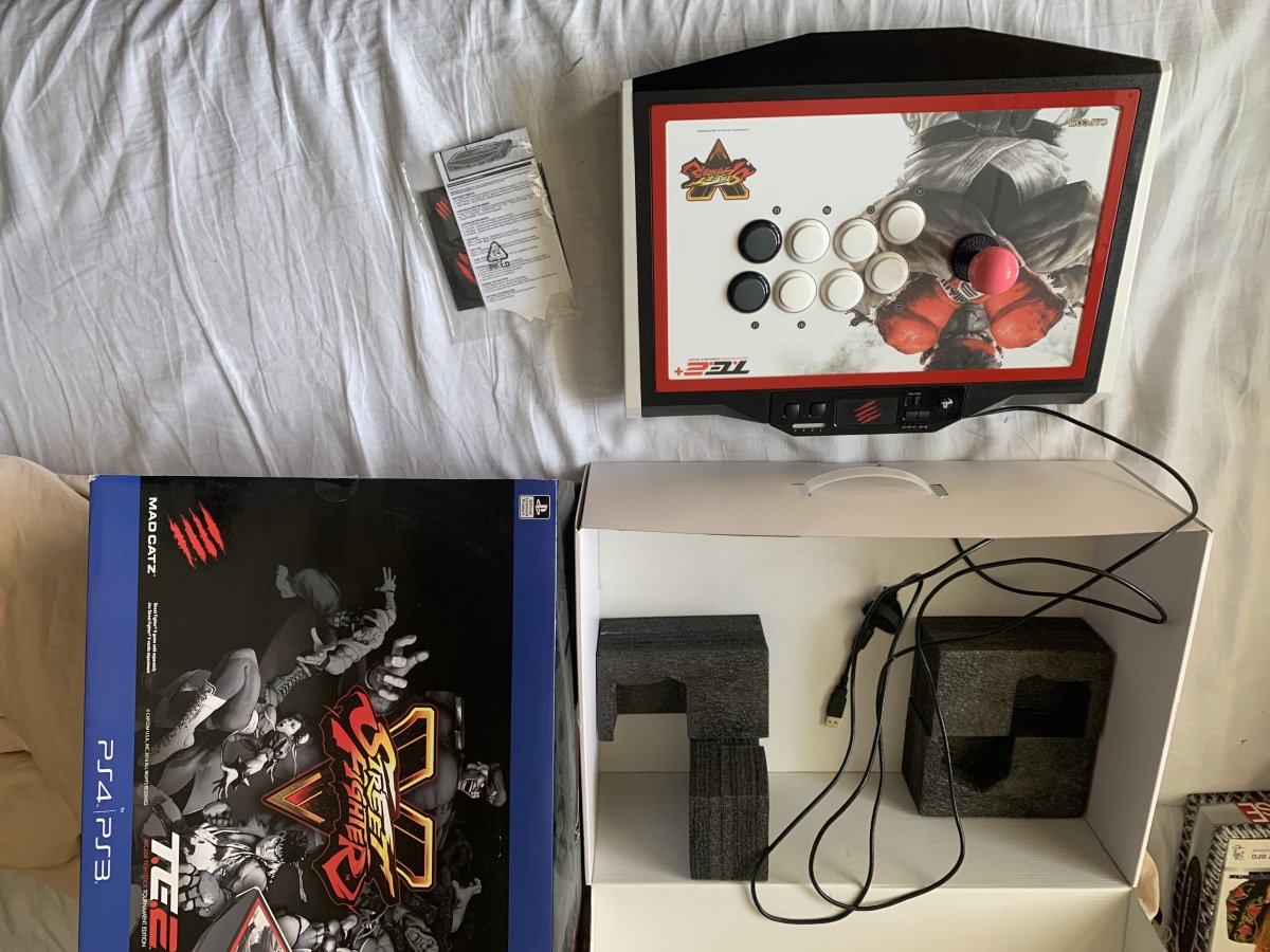

ps4 gamepad - works and has analogs buttons R2/L2 (important for racing games like crazy taxi)
Switch pro pad good too, but missing analogs buttons. For racing games u can use right analog for break/acceleration
Also i checked arcade sticks
Works great
