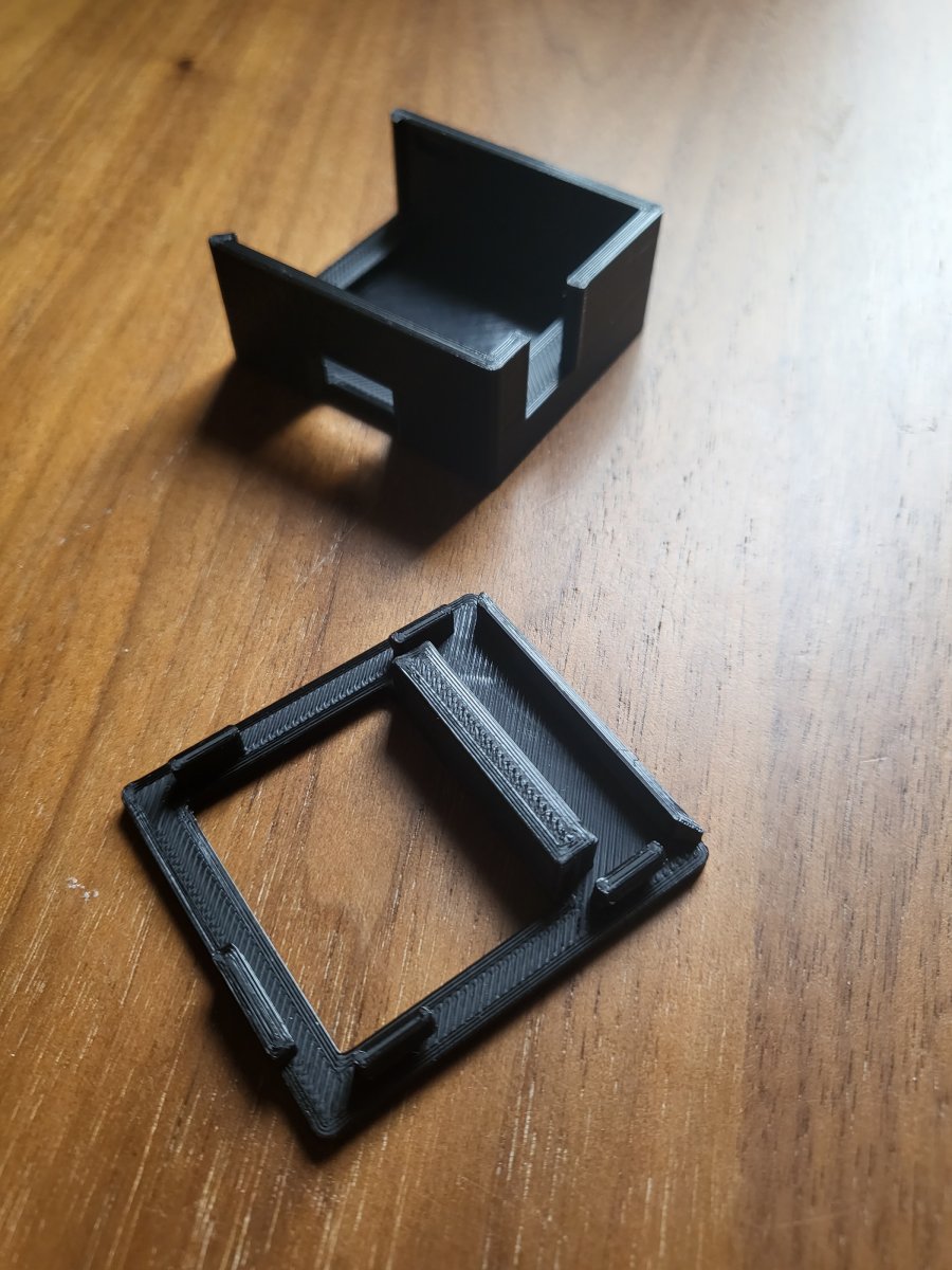

I had a case 3d printed before I knew about the new revision having different USB power. If anyone in the US wants it, just pay $5 shipping.
EDIT: Claimed!
