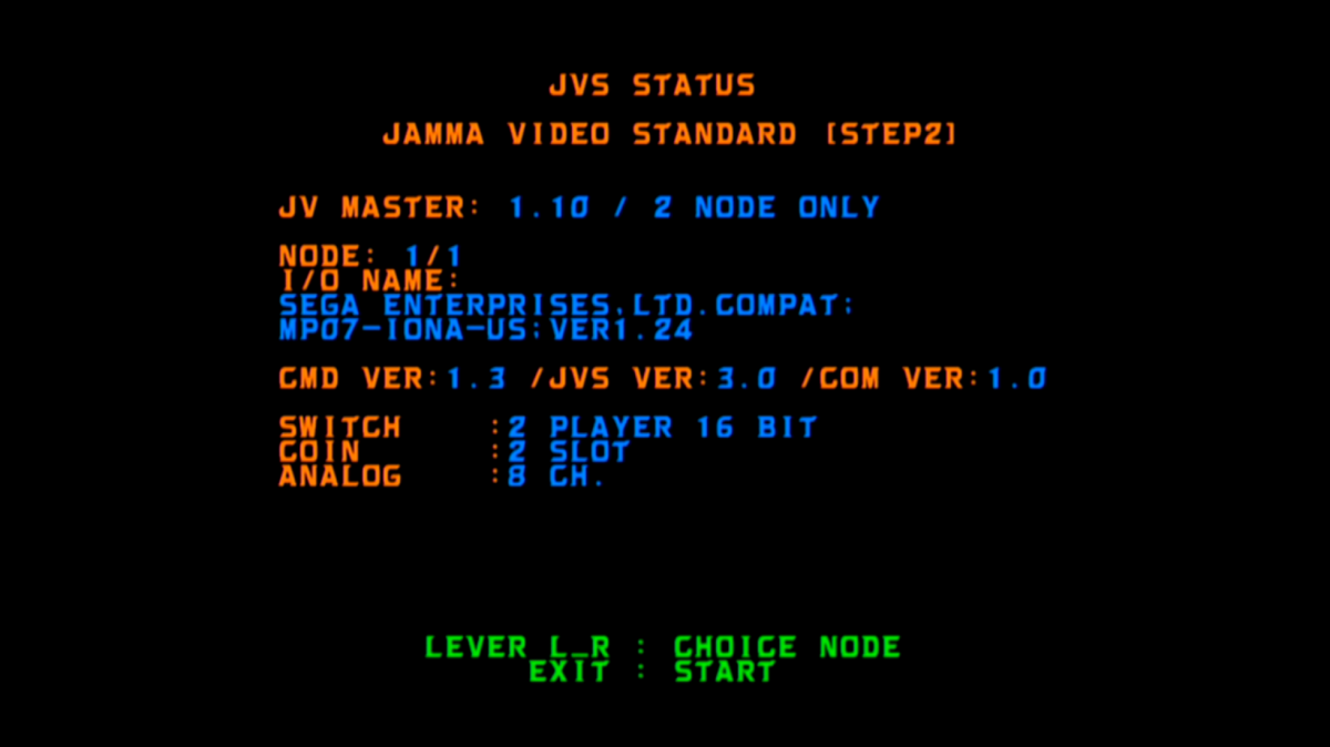

Holy shit! IONA works with Tatsunoko Vs Capcom! Kinda.... Button 5 isn't triggering though.

Out of curiosity, if you use a keyboard to select a JVS game or set a JVS game to auto boot like the original BlazBlue. Does it work?
I still have an original BlazBlue HDD and Dongle too, I can try booting that when I get my IOs if this isn't yet sorted.
@Niko I tried autobooting a game that I know works (SFIV) - and no, when the game tries to boot - I get a JVS connect error (002).
How do I cancel the autoboot btw? :)
Matt
Hold down P1 start as the system boots.
It sounds like this device isnt doing something to spec. I'd either need one in my hands or have one of you guys log some data for me.
