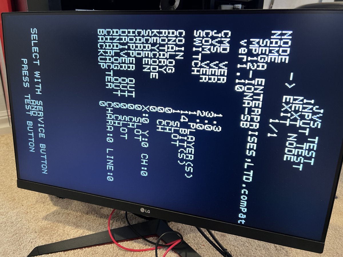

Adding this for posterity, since a member just asked me and I thought it could just be public. The MP12 board identifies just fine on NOAMI. In the input test, I got signal for 8 buttons, coin, p1 start, and all directions. My setup isn't really good for sustained play but if anyone was waiting to confirm NOAMI compatibility, it worked on boot/test for me. Maybe someone else can chime in if they've been using it for game sessions, or with multiple devices, etc.
Great to get (tentative) confirmation that it works on Naomi and that it works great in a Vewlix running an Exa.

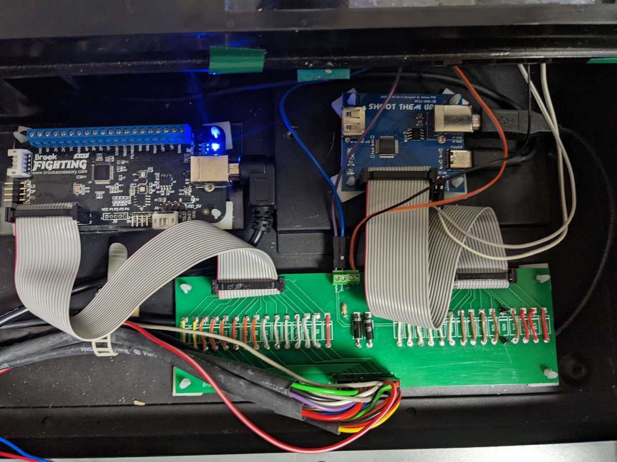

Even if I was building a multi-purpose stick, like one with a brooks inside too, I’d probably stack a 12 alongside the other encoder using a dual 20 pin header. So I’d be sending analog to both the brooks and 07. That would be the least lag, versus encoding usb with a brooks and then sending a usb signal into the 07.
i'm doing something similar in my stick
That looks pretty sick
Is it anything like dual modding a Brook UFB with the Brooke Retro?
Is that a custom PCB they're connected to?
I'm actually interested in modding it the same way
thank you, it's just a simple PCB i made, same concept with the UFB and Retro, i just added some extra pins for the home, back, LED and GND and resisters for the LED and places diodes in the VCC line. if i didn't add the diodes then both boards would power up even if one was connected
