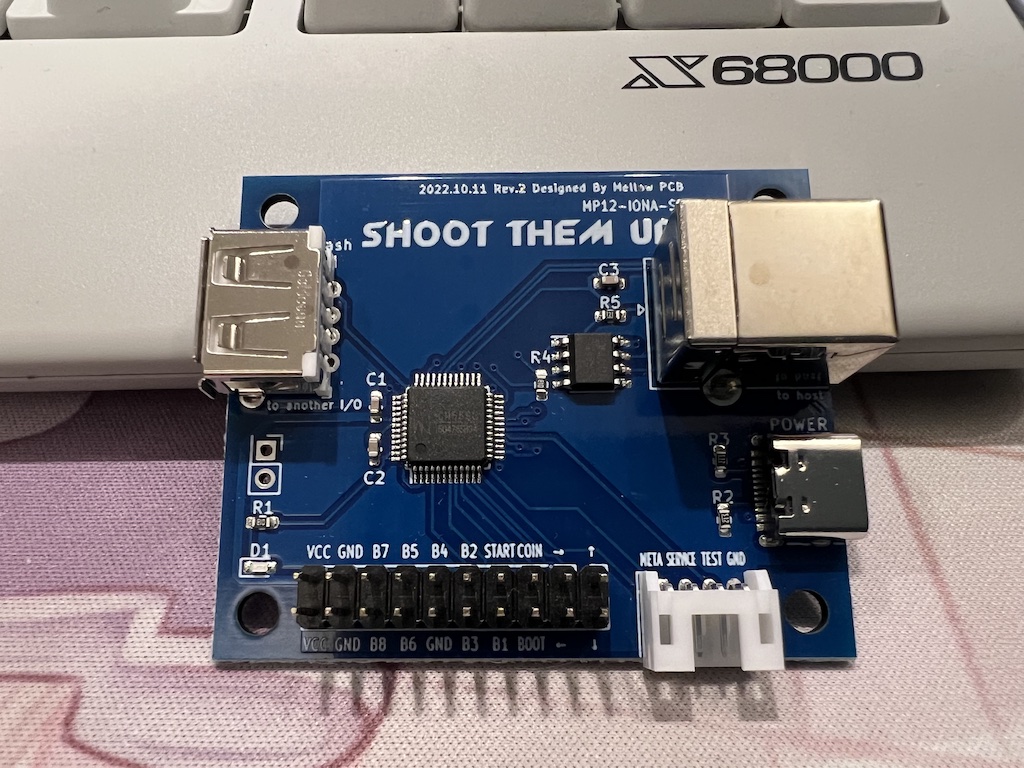

Toyoshim has designed a new JVS board, the MP12-IONA-SB.
It’s similar to the Brook Fighting Board, uses the same connector cables, but speaks JVS rather than USB.
As IONA-SB uses an additional chip to speak JVS protocol, you don’t need any software setting to mitigate and to adjust electrical characteristics. It will just work.
Use cases include creating fight sticks with low latency JVS support and wiring up arcade panels to plug directly into JVS. Boards are able to be daisy chained for multiple players. The device is powered by USB-C. Standard USB-B to USB-A connection to JVS. Daisy chaining is achieved by USB-A to USB-A between boards.
Support for 1 Lever and 8 Buttons with coin, start, test, service, BOOT and META buttons (BOOT and META are special buttons to change IONA-SB settings).
Layout and rapid-fire are configurable.
It supports "JVS Faster Mode" on exA-Arcadia hardware.
As a bonus, it still can speak USB HID for mini hardware; such as Neo Geo mini, Mega Drive mini, Playstation mini, PC Engine mini, C64/A500 mini, etc.
