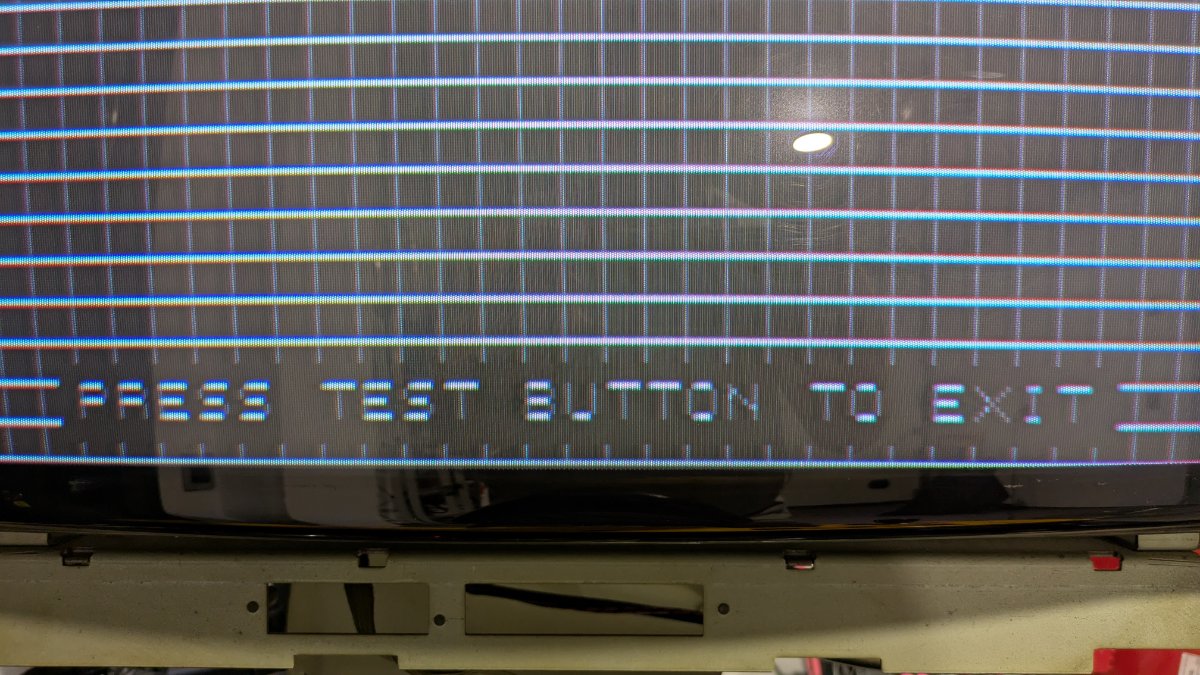

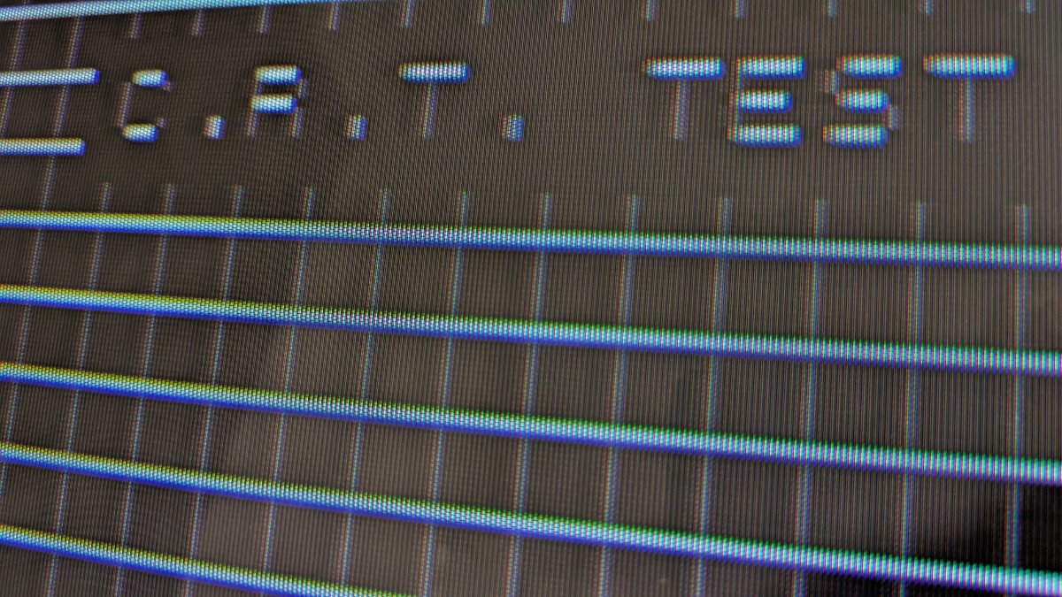

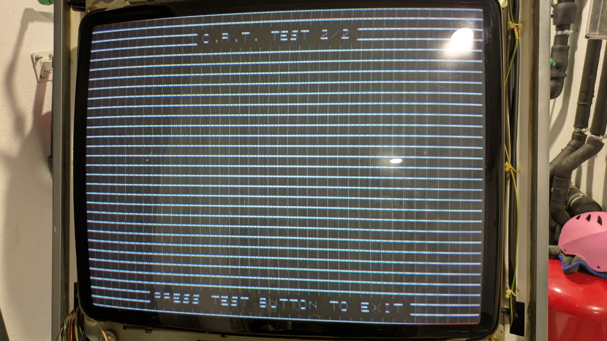

Hi! I'm having an issue with a Naomi monitor. The vertical lines in the CRT test pattern are very faint—barely visible. I've adjusted all the pots as well as the flyback; there is a slight improvement, but it's still not right. Does it need a recap? Thanks in advance!
Try checking the video amp section, weak vertical lines can also be caused by low video bandwidth or the monitor just being out of adjustment.
