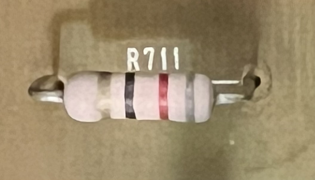

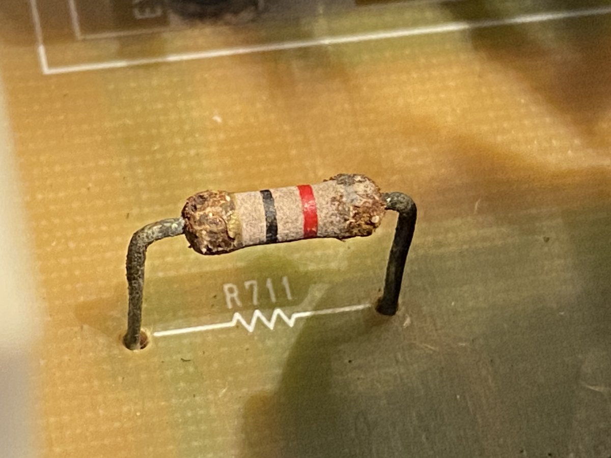

Ziggy Cheetos Dust Grand Master Joined Oct 8, 2019 Messages 648 Reaction score 981 Location Australia Jun 28, 2023 #1 G’day. Can anyone help me out with the value of the R711 resistor near the flyback on an MS2931? Mine’s corroded and I want to make sure I get the right replacement. It looks like there may be remnants of a gold band there. Thanks in advance. Attachments IMG_8377.jpeg 141.3 KB · Views: 22
ekorz Multi Boyz 4 Pi Legendary Multi Boyz Joined Aug 21, 2016 Messages 5,213 Reaction score 7,843 Location Boston, MA Jun 28, 2023 #2 https://wiki.arcadeotaku.com/w/Nanao_MS-2931 has the service manual for future needs 82 ohm 5% gray red black gold
