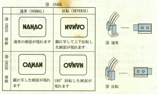

I've not looked at all of the MS8 manuals yet but looking at the MS8-29F manual the method for reversing the image is slightly different:
Instead of reversing the polarity of two wires like the MS9, the MS8 above uses a two pin header and a connector with three wires which is shuffled to the left or right. This wouldn't work with how I've wired the DPDTs for the MS9 version but I'll see if I can come up with something for it.
