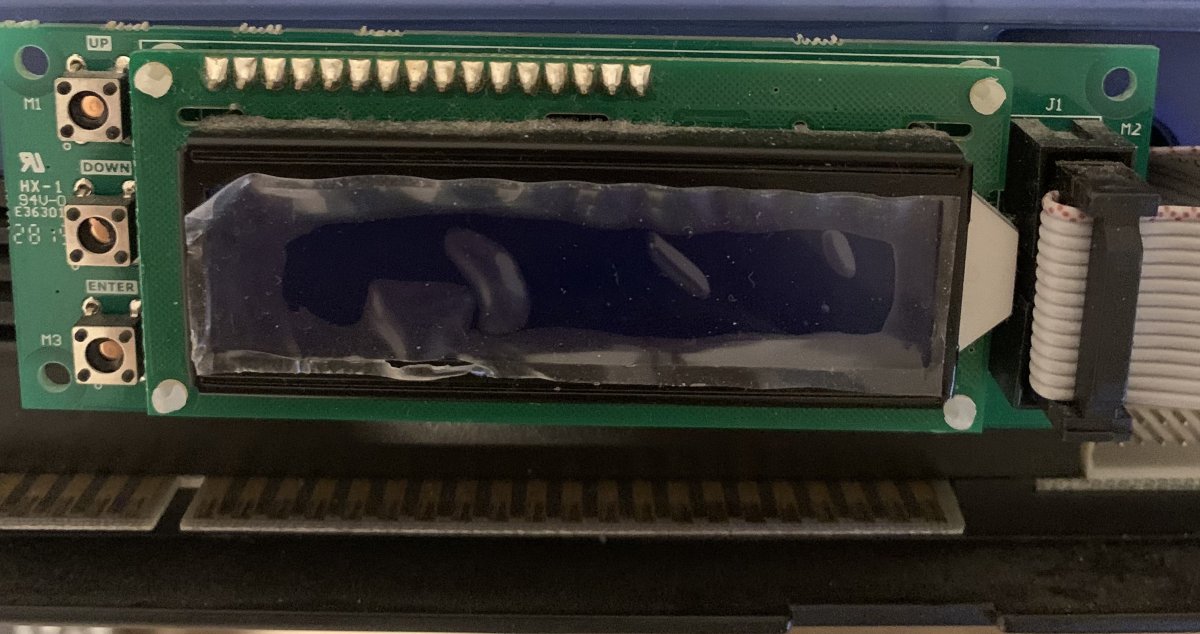

Hi guys wondering if anyone can tell me the bridge points to repair a bad select button on the LCD board. The traces that run to the button were damaged when the buttons were replaced. So now the game up and game down works but not the game select button.

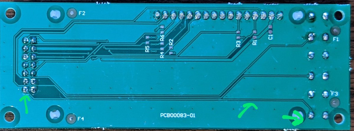

My lcd selector is below, on the back I have marked in green the trace that is responsible for the select button. You can solder a wire between the two end points and the button should work.
My lcd selector is below, on the back I have marked on green the trace that is responsible for the select button. You can solder a wire between the two end points and the button should work.
@kimbopman thank you so much!! I appreciate your effort. This was exactly what I needed.

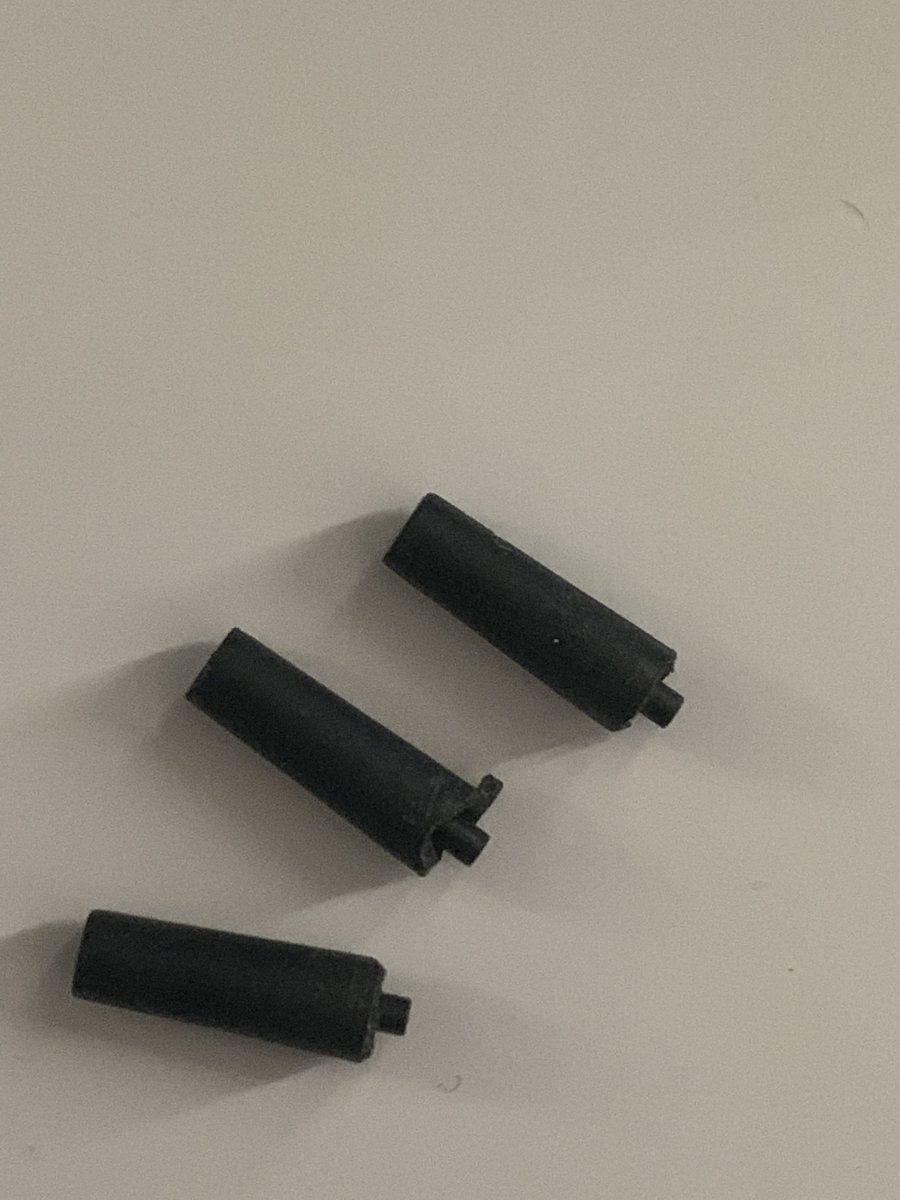

My buttons broke off, all three of them. How can I get replacement buttons? And probably I need a case.

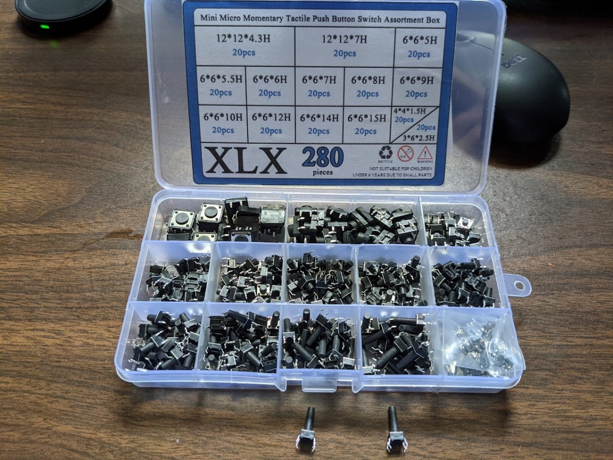

I got a whole box full from amazon. I think I used either 6x6x14H or 6*6*15H, doesn't matter which one. Probably the taller the better so the button can reach out further from the case. My kit years ago came with a broken/snapped off up switch.

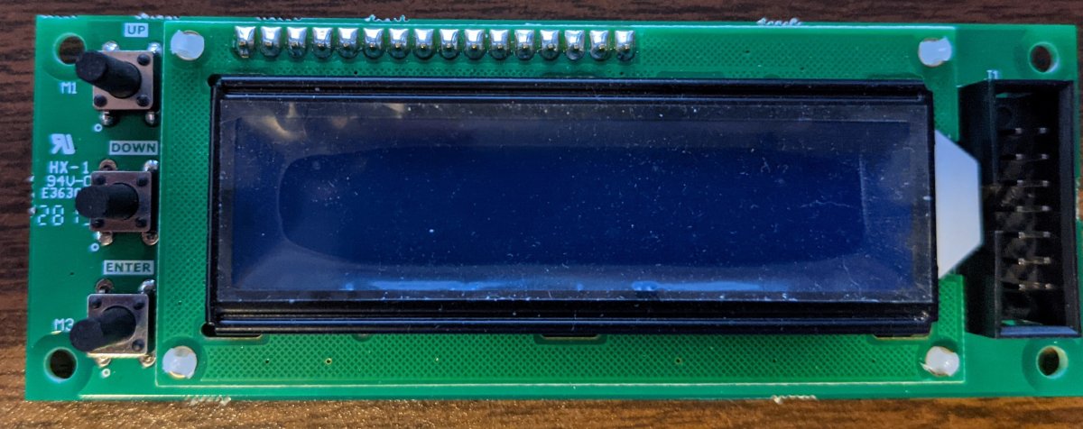

Thank you so much. I chatted with mitsurugi who also recommended I install new switches. Even though the buttons are still in tact and I can still operate the lcd game selector by just pressing the contact plate it’s a little annoying. Instead of desoldering and soldering new buttons on, how does a new lcd selector for the darksoft cps2 multi kit cost? I was thinking just to super glue since the nipples are this there (don’t ban me I just had to say it).

Super glue won't hold it for long if at all unfortunately. Desoldering is the only way. I do not know how much a replacement lcd selector would cost - maybe Mitsurugi or Darksoft can hook you up with a new one. Anyone in your local area that might be able to help you with the desoldering?
Just take it to a shop that fixes electronics and have someone with experience install them. It shouldn’t be too expensive and it will save you from possibly damaging the traces or worse.
