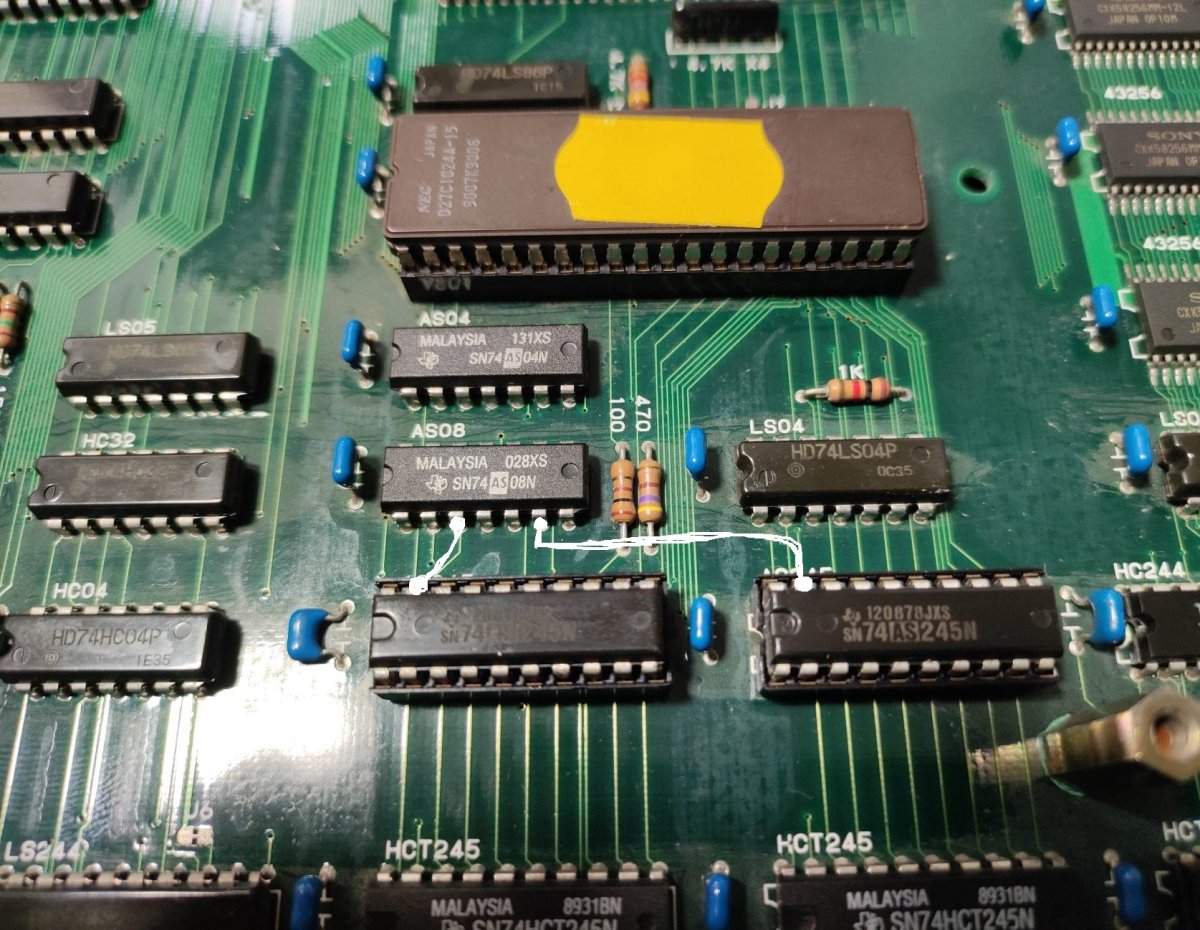

I made a beautiful drawing :D

Just so there is no confusion. When I say B7 and B8 I'm talking about the location of the chips on the board and not pins on the chips. If you look above the middle part of the jamma connector there are letter A to S going up the board, and at the bottom/top of the board are numbers 1 to 11. So B8 is the chip at row B, column 8, which is the 74AS245 on the right.
For your issue you we need to work backwards from pin 19 to figure out why its stuck high. As you showed pin 19 connects to that 74AS08 on pin 6.
Next steps will be to logic probe pins 4 and 5 on the 74AS08 and see what they are doing. Pin 6 should only be high when pin 4 and 5 are high.
  • If pin 4 or 5 has faint pulsing, but there isn't faint pulsing on pin 6 it would point to the 74AS08 being bad (I doubt this is whats happening)
  • if either pin 4 or 5 is floating that points to a broken trace
  • if both pin 4 and 5 are also stuck high you need to take another step backwards and track down why
    • You show that pin 4 and pin 1 are connected together, so seems unlikely you need to look there or the issue would also be effecting the other AS245 too
    • So I would work backwards from pin 5 on the 74AS08 to see where thats coming from and see if that IC is working right
