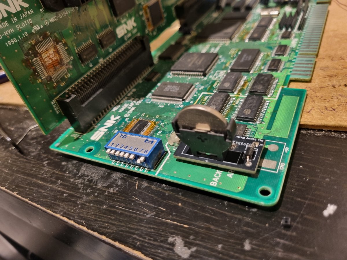

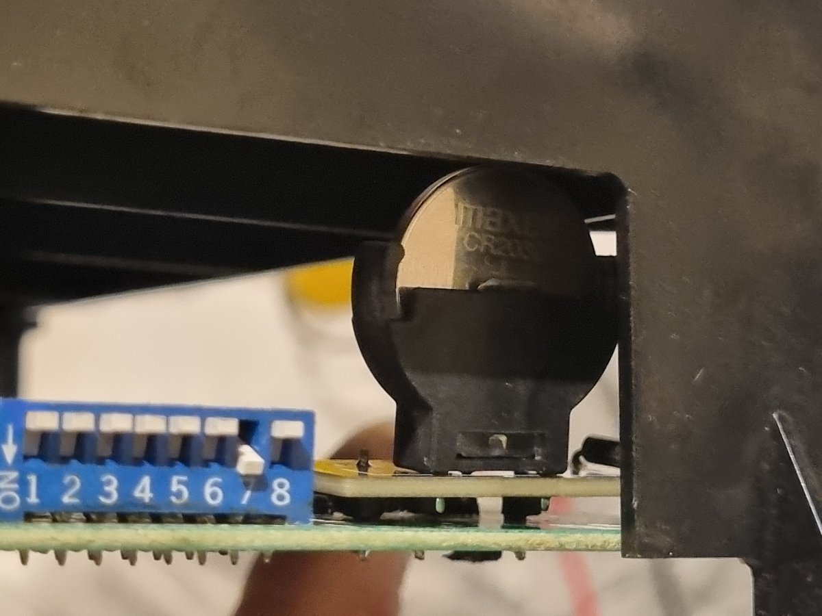

B Big_P Big_p Professional Joined May 2, 2024 Messages 370 Reaction score 513 Location Australia Jul 5, 2025 #61 Some photos of my battery blaster installed, still working well 2-3 months later Attachments 20250705_030701.jpg 218.1 KB · Views: 51 20250705_031026.jpg 127.1 KB · Views: 51
