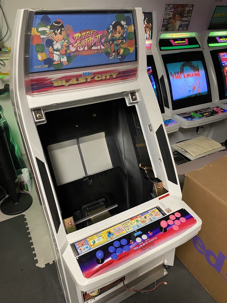

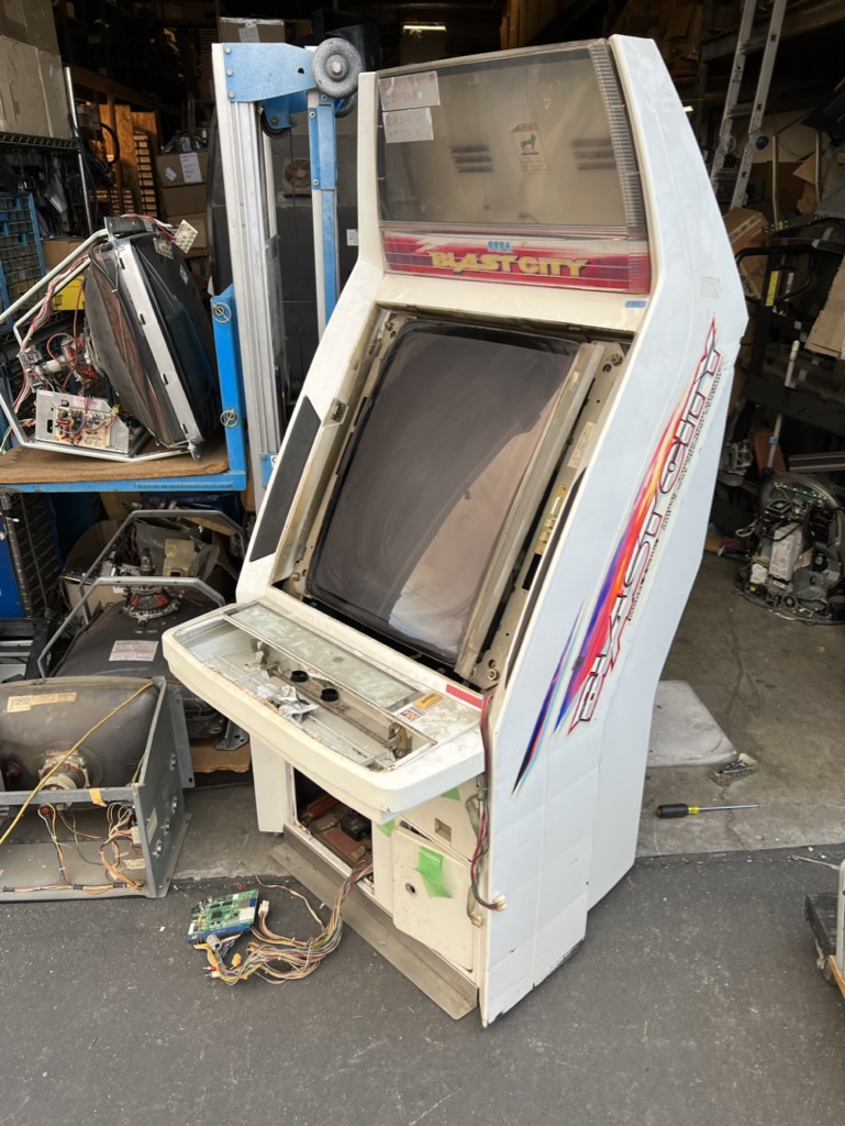

Well... it has been quite the journey with this Blast City. It's crazy to think this was my 2nd cab I ever got, just a few months after my first Astro City.
If you've followed this thread you saw that this cab was locked and didn't turn on. Now, had it just turned on this would have been a great deal for a Blast. It has cleaned up super well. But, me being new to this hobby I underestimated what could go wrong, especially with a Blast City.

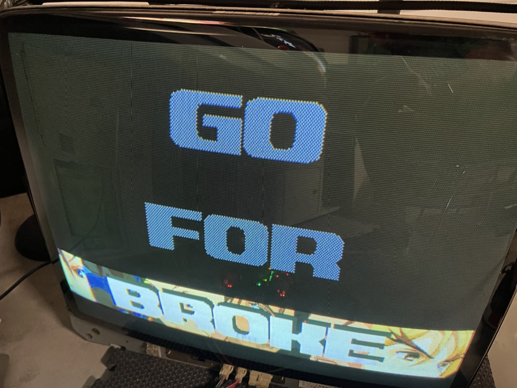

Once it turned on, the monitor didn't. I recapped the chassis. Then the monitor turned on. But, fast forward a bit later and I posted this thread: Nanao MS-2933 no red.
Thanks to help of this awesome community it was clear that it was likely the tube. After chatting with @opt2not for awhile he offered to come over and check the tube out with his rejuvenator. Sadly that didn't do the trick. It appeared that the red gun is gone.

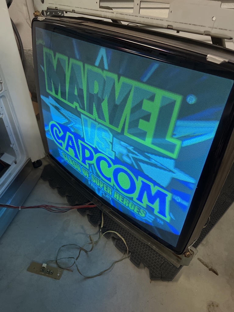

The tube was indeed done. They replaced it with an Orion they had on hand. It had some burn, but not too bad.
(my dead tube with another lost soul)
Success! Look at all that red!

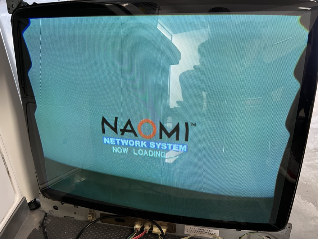

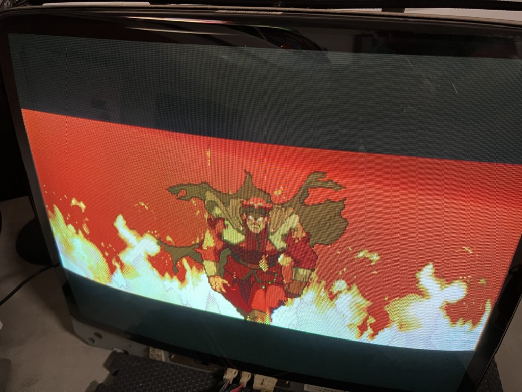

Enter the hula dancers. After letting the monitor sit for awhile before calibrating and mounting, it started to have some issues. Most of all wavy lines, vertical collapse and occasionally shutting off entirely.

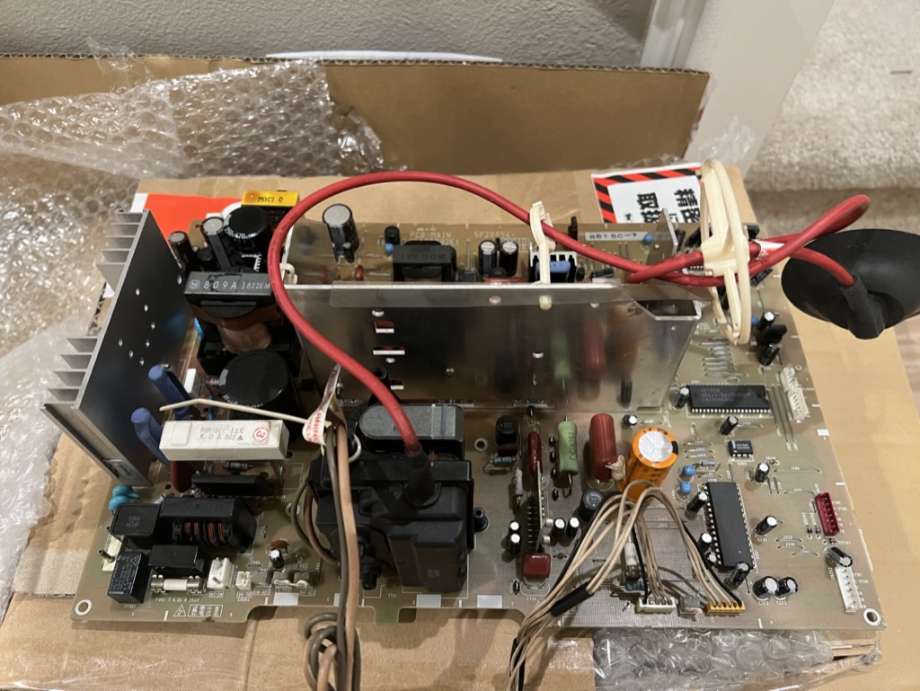

After many hours of work at PNL they told me that a video control IC chip was bad and they weren't able to source a replacement.
So...
I was able to find an MS-2931 on Yaj and took it over to PNL.
Great success! We have a stable image.

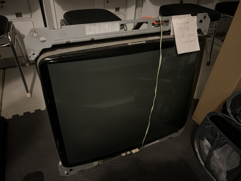

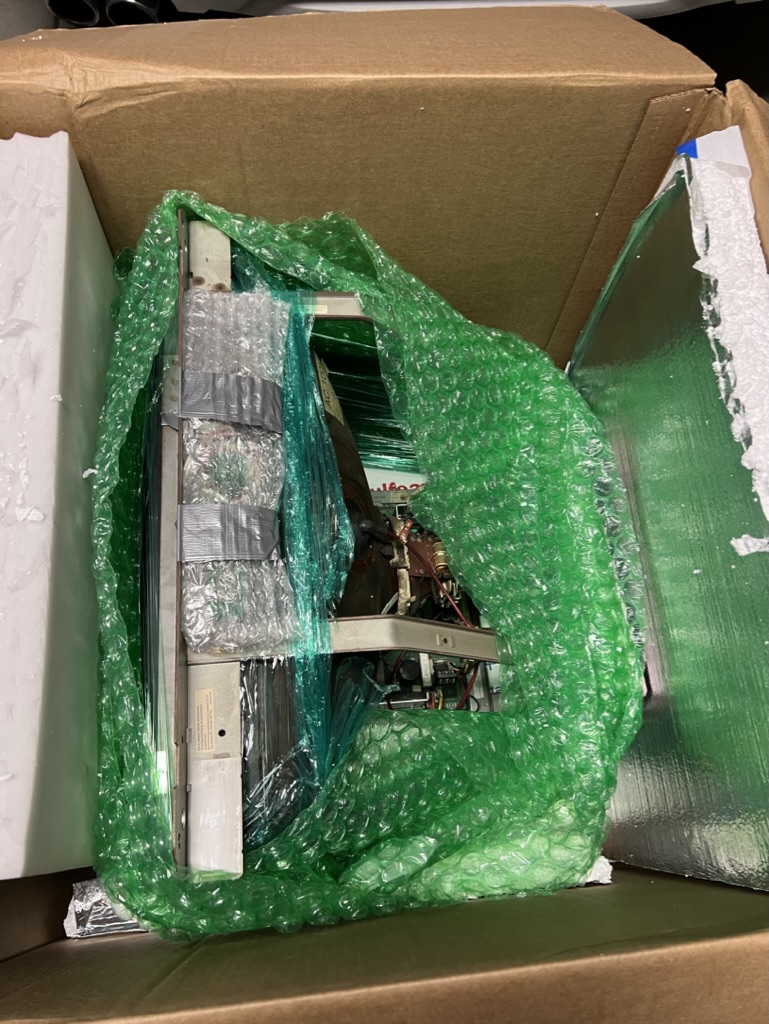

The monitor was packed great by @garou81 and put on a pallet. It was freighted via YRC from Central California to SoCal, about 5 minutes from my house. The people at YRC were super helpful. They disposed of the pallet and we lifted the giant box into my SUV.

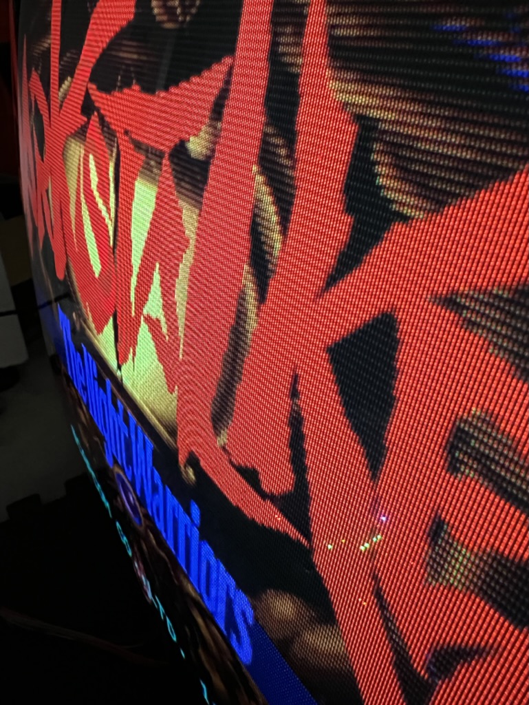

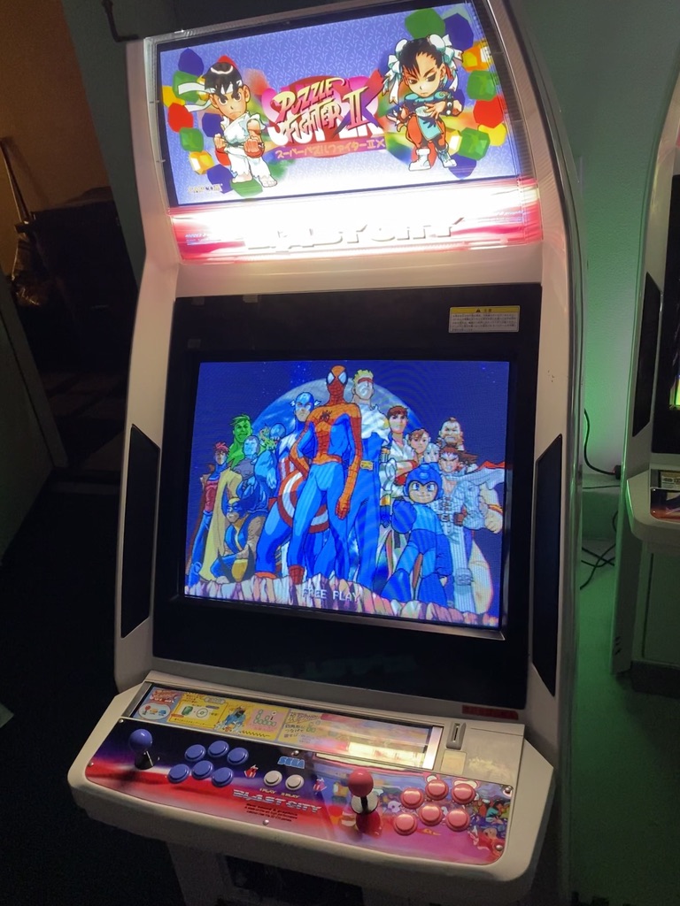

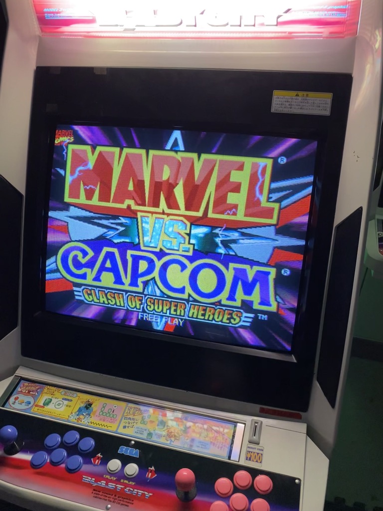

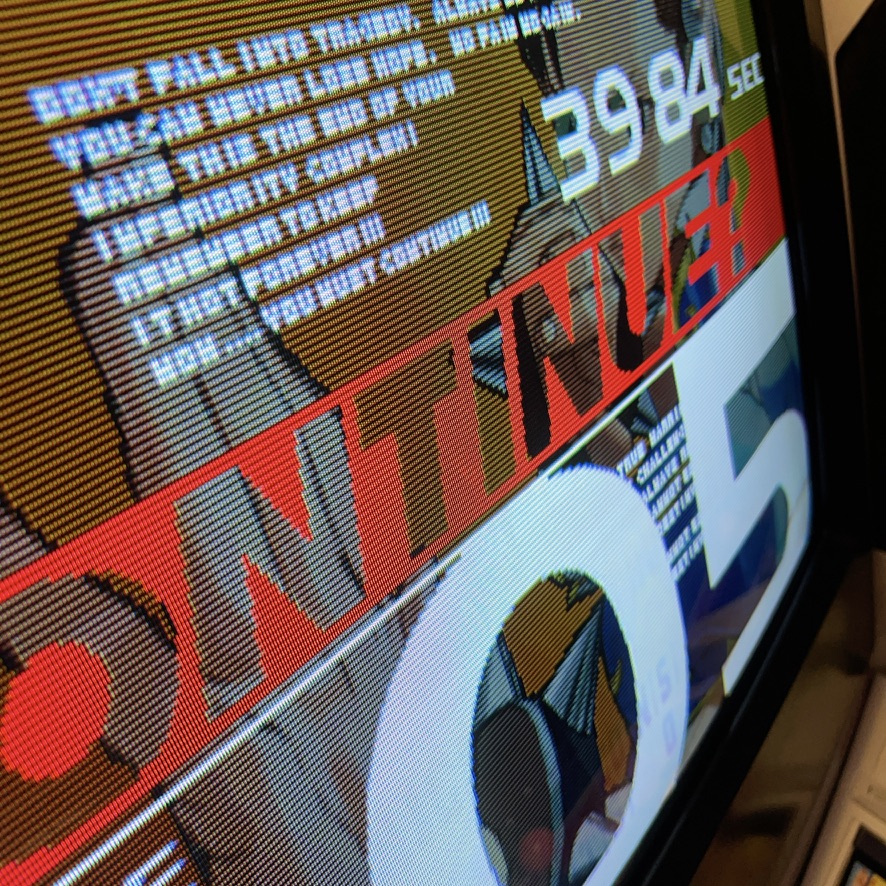

GREATER SUCCESS!!!
This thing looks fantastic.

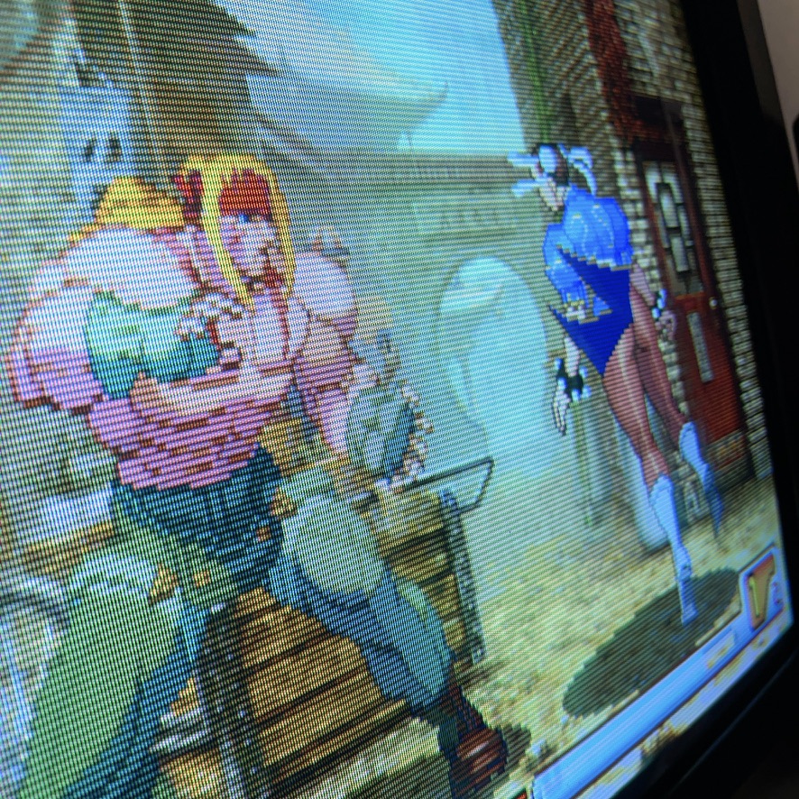

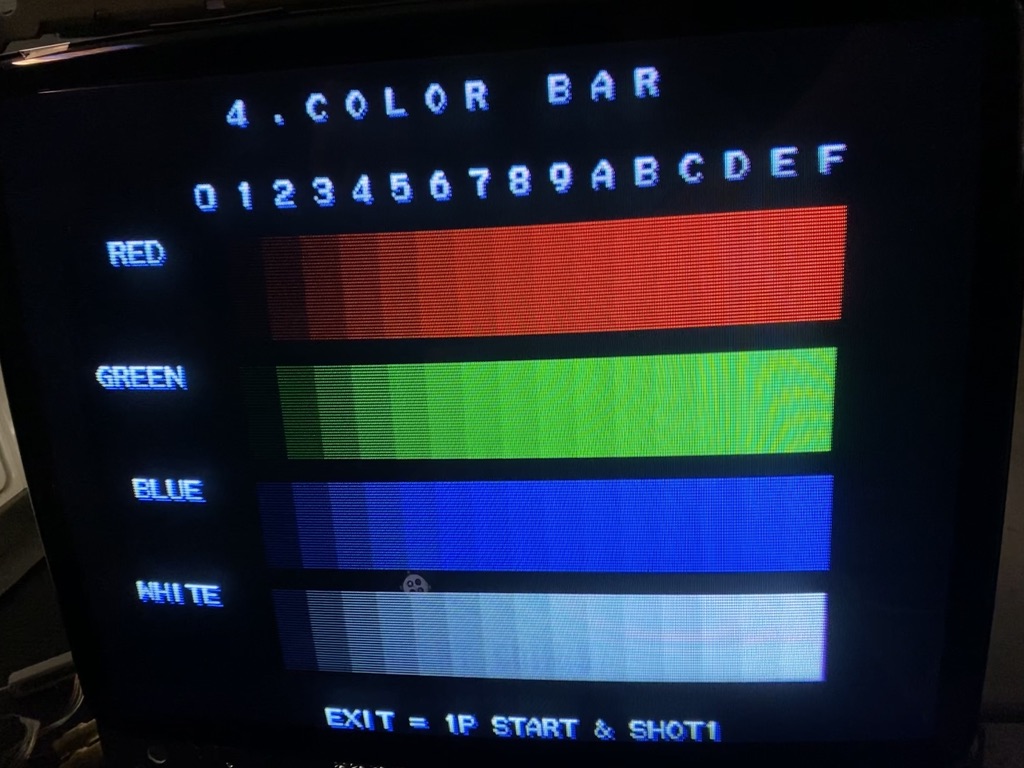

We spent a bunch of time calibrating it. Put about 6 convergence strips in it and it my be my favorite monitor of my row. Screen is set very low, so hopefully it has a lot of life left to give. Likewise with brightness, also very low. And it's still super bright and sharp.
Very happy with how this looks in 15k.

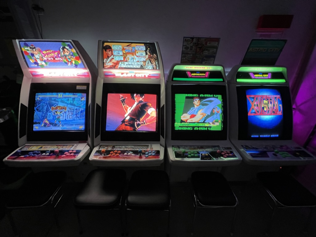

One big happy family, at last.

Great persistence there. Got any pics of how you did the convergence strips?
Great persistence there. Got any pics of how you did the convergence rings?
We did convergence strips to get the corners cleaned up. The on-center was in great shape so we didn't mess with the rings.
It's still a 2930, so the bottom right corner isn't perfect, but it's better than every 293X I've seen.
Thanks mate. I meant strips. Just a case of experimenting I guess?
Great work! I might need to source a few tubes as well. Does he have anymore tubes and did you catch watch tv and tube models it was?
